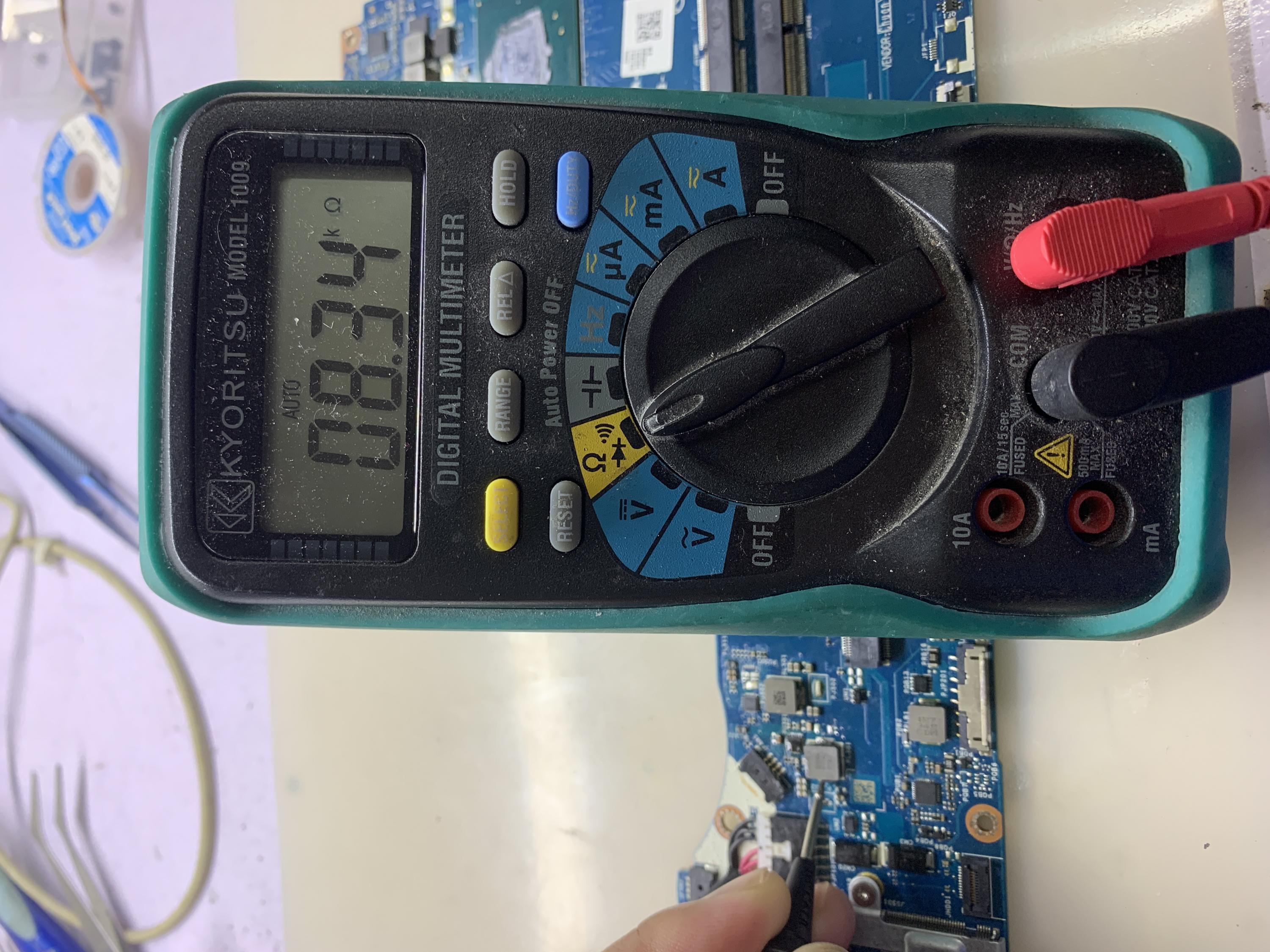

    Wow. Quite the game.

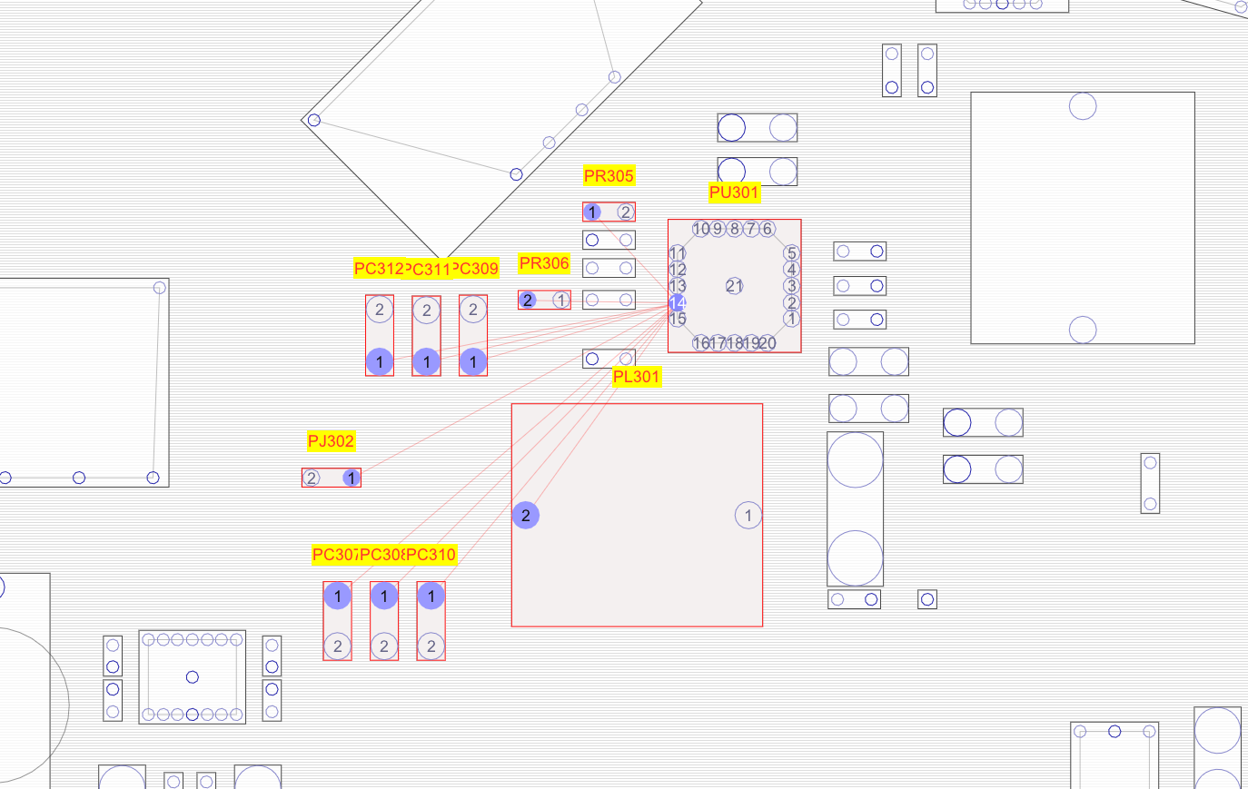

    Remove all power. Meter in resistance mode. Check the resistance across the PL301 contacts.
    What is the measurement?
    do you mean check all resistance on this part?
    • mon2
      • Dec 2019
      • 14672
      Re: acer aspire nitro an515-54 missing 3v
      No. Meter in resistance mode. No power to the logic board.
      One meter probe on one side of PL301. Other meter probe on other side of PL301.
      What is the resistance?
      • dqtech
        Badcaps
        • Jul 2018
        • 639
        • N/A
        this one sir...8kOhm

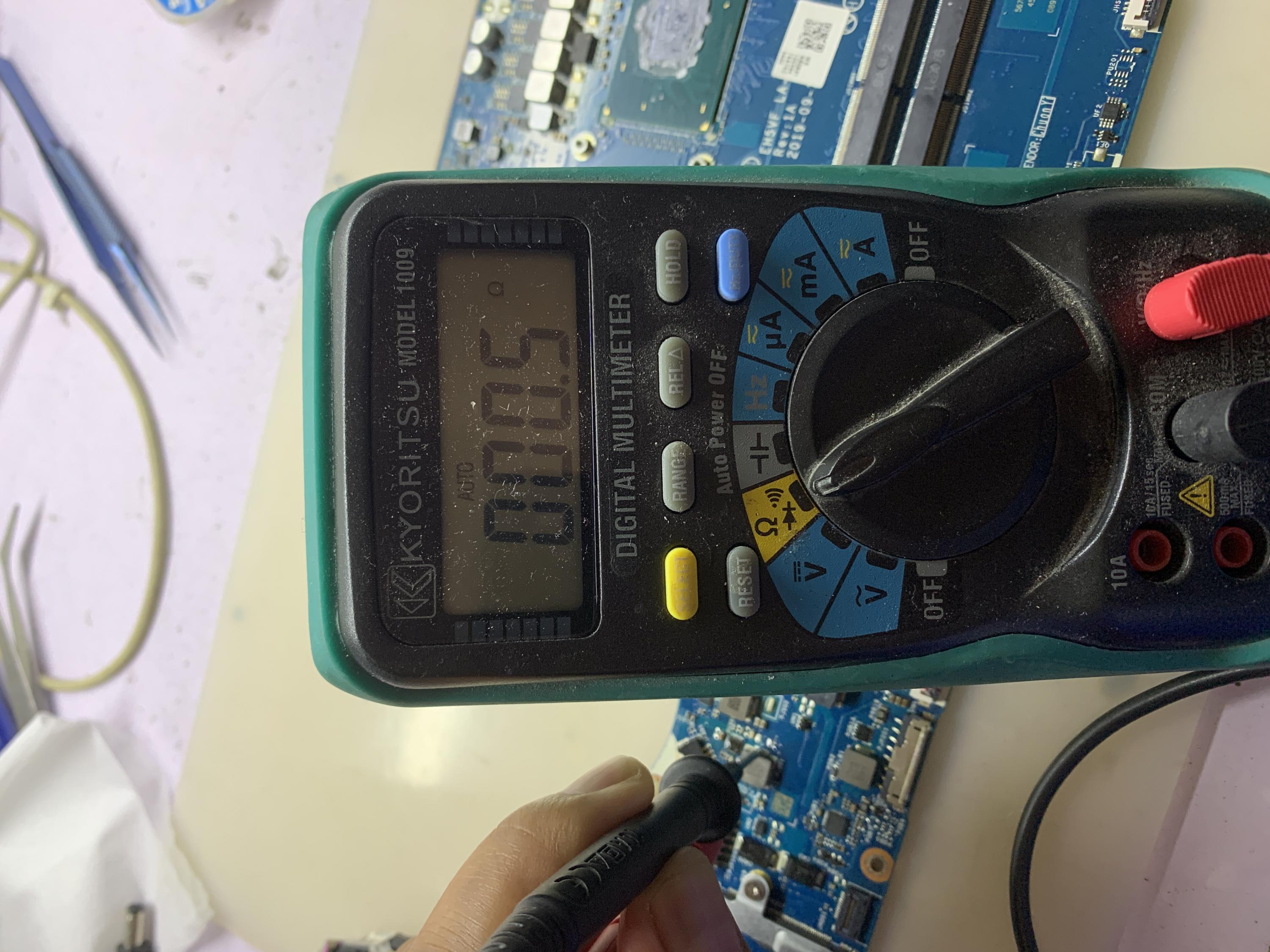

        • mon2
          • Dec 2019
          • 14672
          Yes, this part but the other meter lead should be on the other side of this coil. We want to know the resistance of this component.
          This is a shielded coil and the coil is based on many turns of wire inside the shield. Want to confirm that the coil is not damaged.
          • dqtech
            Badcaps
            • Jul 2018
            • 639
            • N/A
            this is okay right?
            both probe on this PL301 coil
