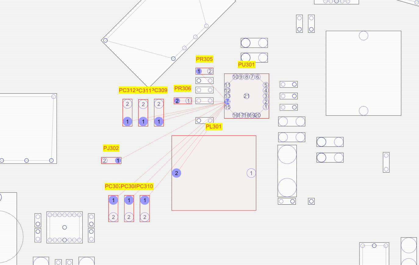

            update....i already replace PU301 with new ic but also not work...3valwp not present
            • mon2
              • Dec 2019
              • 14664

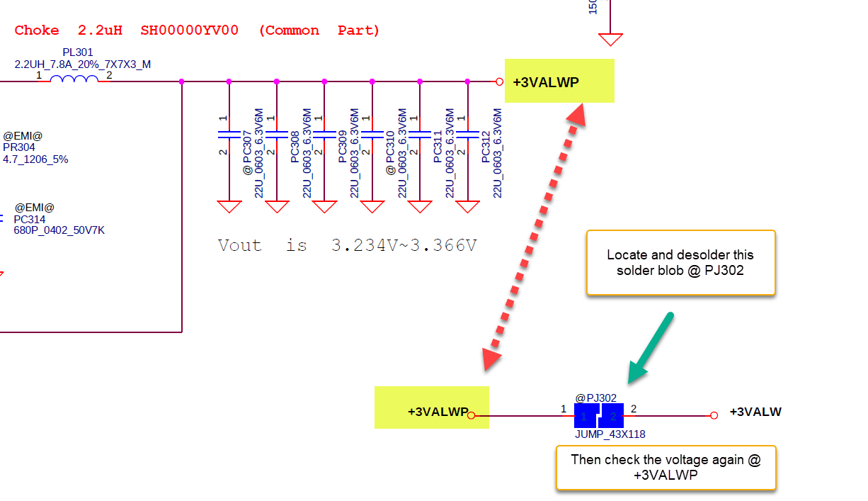

              Re: acer aspire nitro an515-54 missing 3v
              See attached.
              Post your voltage reading to ground after the short / solder blob is removed.
              • dqtech
                Badcaps
                • Jul 2018
                • 639
                • N/A
                Originally posted by mon2
                See attached.
                no reading on +3VALWP (pin 1) sir

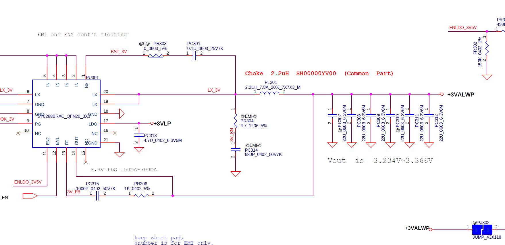

                  1) is the replacement part a known good part?
                  2) same part number as the original?
                  3) what is the voltage to ground of the LDO rail on this regulator?
                  4) confirm the soldering with lots of flux, enough hot air and air pressure to make this part swim and naturally rest onto the pads. When the solder is in liquid state, gently push the IC at the corners and the IC will push away and return back onto the pads. This process will fix any potential solder shorts. Then allow it to cool and test again.
                  5) if the parts on this regulator circuit are not missing, the voltage should be present if the solder blob is removed. That is, a no load should allow for the proper voltage output.
                  • dqtech
                    Badcaps
                    • Jul 2018
                    • 639
                    • N/A
                    1) yes, new ic
                    2) yes same with original part
                    3) LDO on pin 17 got 3.3v
                    4) yes everything good
                    • mon2
                      • Dec 2019
                      • 14664
                      Check the resistance of the parts and reflow these parts at the output stage of this regulator that link with PL301.
                      Compare the resistance values against the schematic values.
                      The LDO working is a good start. The switching regulator leg of the regulator should be on as well.
                      With no power, measure the resistance to ground again of PL301. What is the reading?

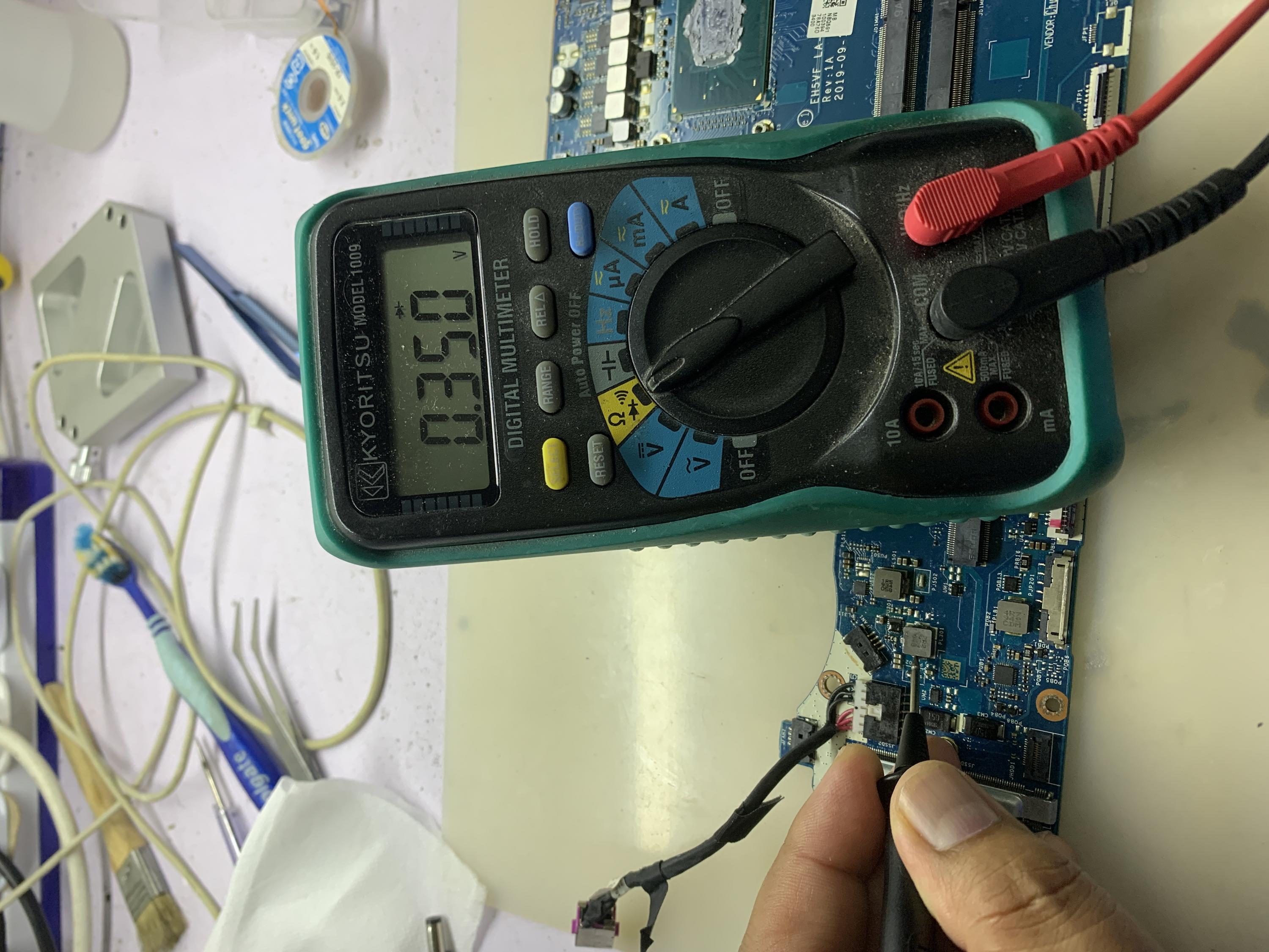

                        PL301 resistance read 0.348v sir
                        • dqtech
                          Badcaps
                          • Jul 2018
                          • 639
                          • N/A
                          reading on all part that link with PL301 is normal...accept PR305 that should be 100k but only read 89k...is that okay?
                          • mon2
                            • Dec 2019
                            • 14664
                            Can you double check this? Resistance checks will be with no power, meter in resistance mode.
                            One meter probe on PL301, other meter probe to ground.
                            Resistance will be in ohms. If you read '1' or 'OL', then the meter scale is too low. Select the next higher scale on the meter till you have a reading.
                            After the above, meter in DC volts mode (10 volts or higher). Then check the voltage to ground of PL301.
                            What is the measurement?

                              am i right?
                              i only have this multimeter
                              • dqtech
                                Badcaps
                                • Jul 2018
                                • 639
                                • N/A
                                in DC volts mode, no voltage reading at all on PL301

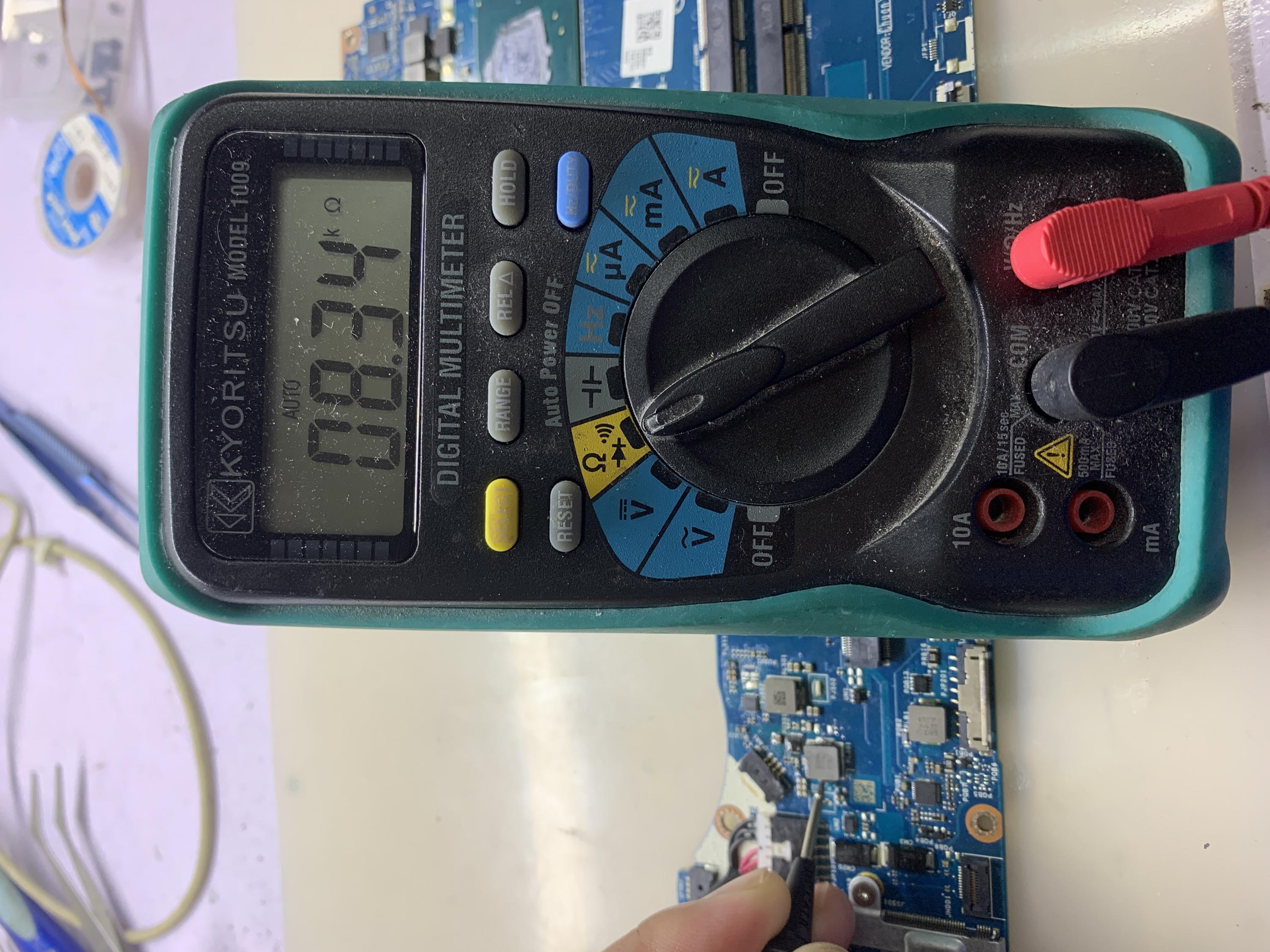

                                • mon2
                                  • Dec 2019
                                  • 14664
                                  The meter has 3 functions in the yellow setting.
                                  You are currently in DIODE mode. Press the yellow button till you see the greek symbol OMEGA for the resistance scale.
                                  Then take your measurement again.
                                  • dqtech
                                    Badcaps
                                    • Jul 2018
                                    • 639
                                    • N/A
                                    sorry my bad...this one?
                                    • mon2
                                      • Dec 2019
                                      • 14664
                                      Good reading at 8k34 ohms. That is not a short. The regulator should be on. Will review the details of this regulator deeper after the soccer game. Fairly sure it is active high enable which you have.
                                      Post close up pics of this regulator and parts. Any burnt looking parts in this region?
