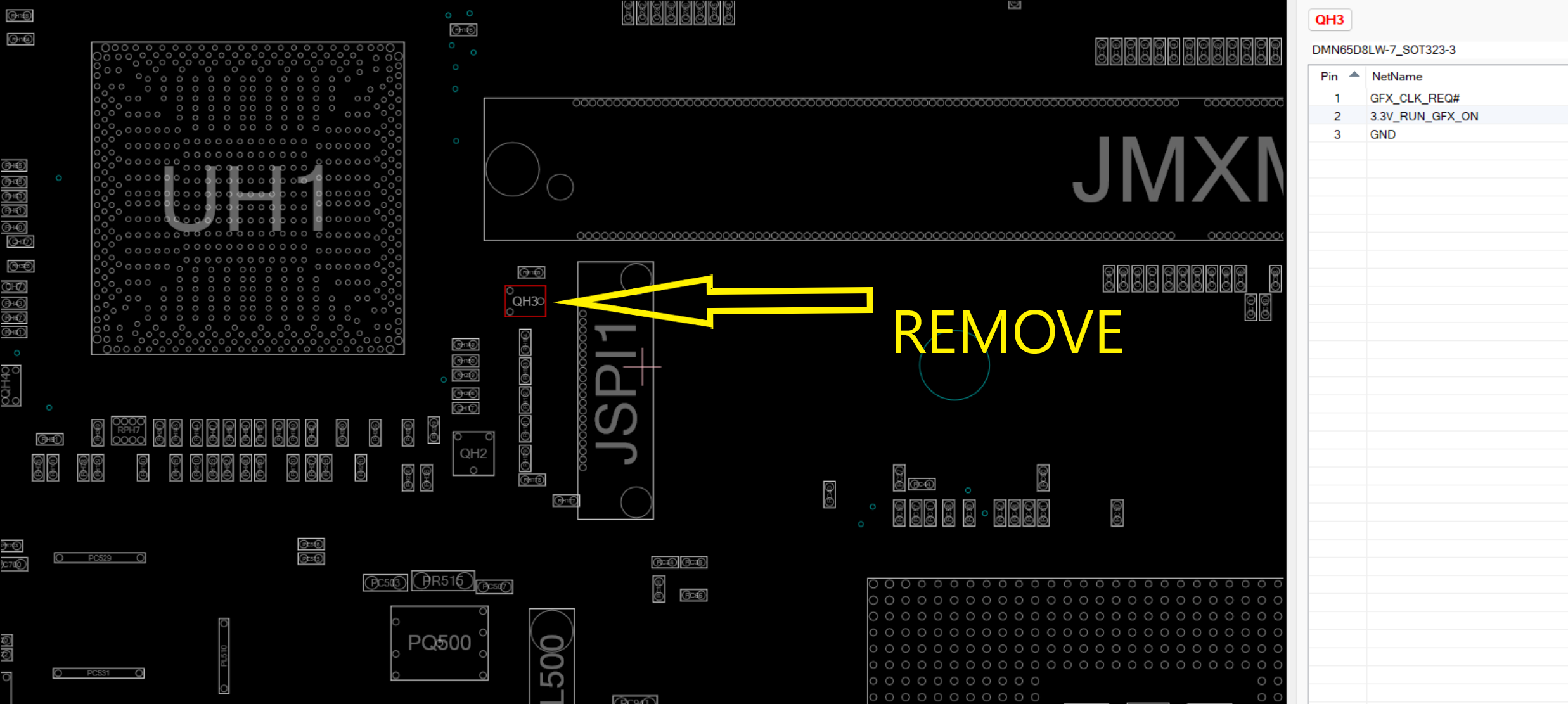

      i have removed the vga without displaying lcd, only capslock signal, at u19 (MAX14885E) pins 1 vs 39 have been put up to 3v3, and the VGA_ID r803 line I can't find. pls help

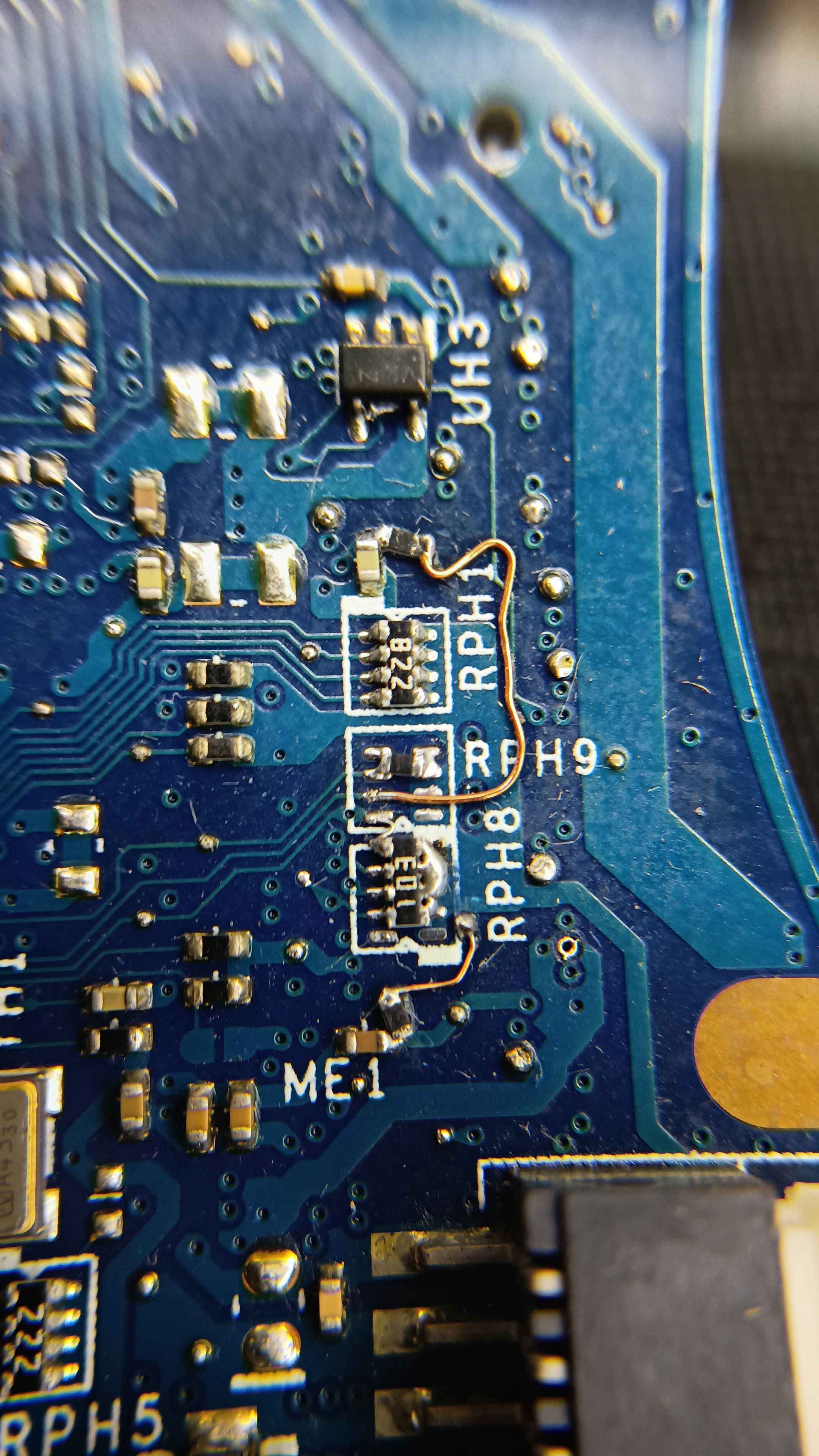

            I have succeeded in converting the M4800 from two VGA to just one Intel VGA, with a few tricks,

              Thank you, can you please let everyone know the value of the resistors?
                10K, I just make the system detect that an MXM card is installed, by activating the signal MXM_present#
                remove QH3, to turn off the GFX_CLK_REQ# signal
                Maybe you can also use one of these two tricks
