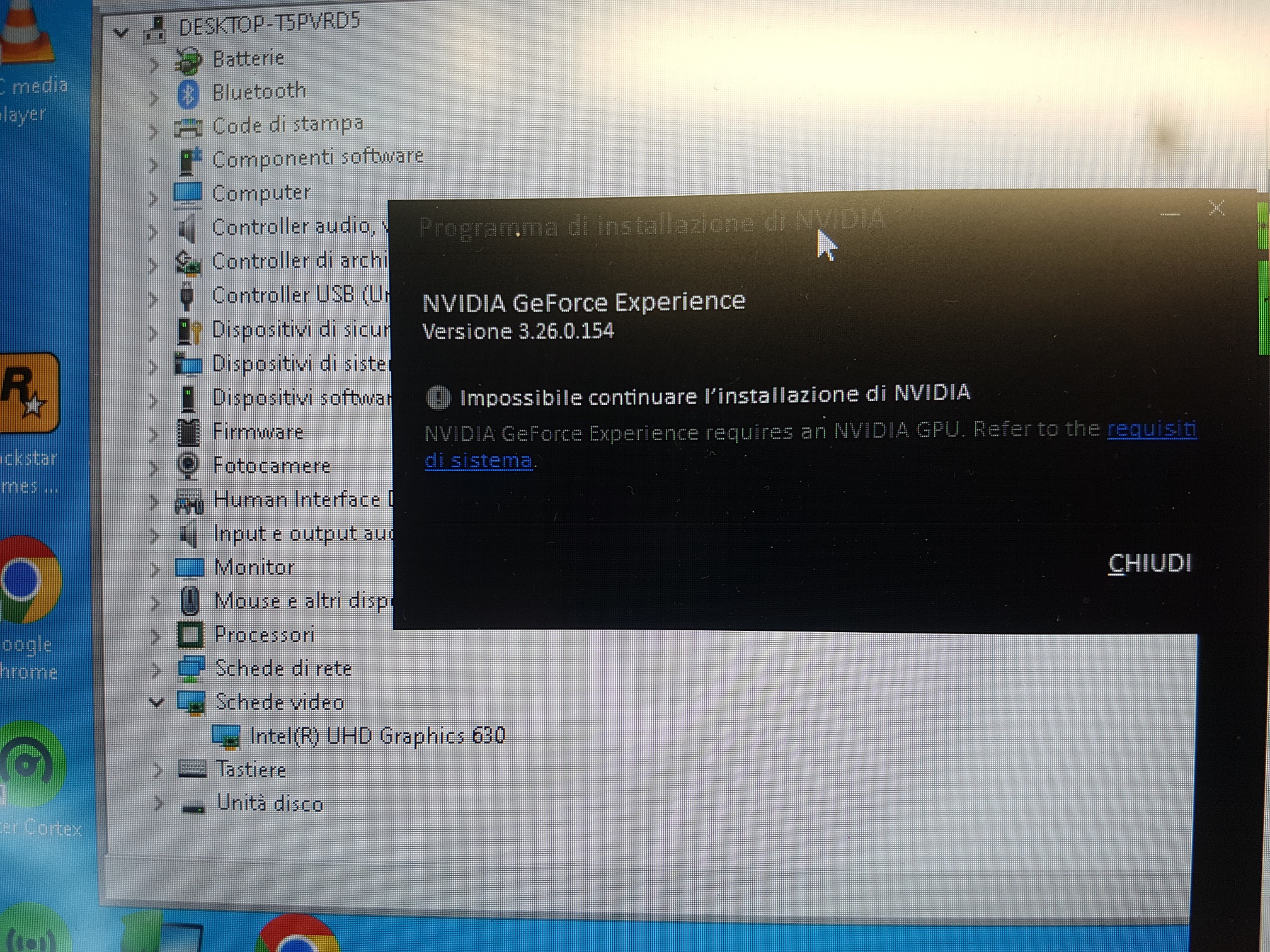

    Hey guys
    Got this machine that works 100% on intel graphics but does not see the Nvidia GPU.
    When I try to install drivers, it says no Nvidia GPU detected.
    Nothing on device manager.

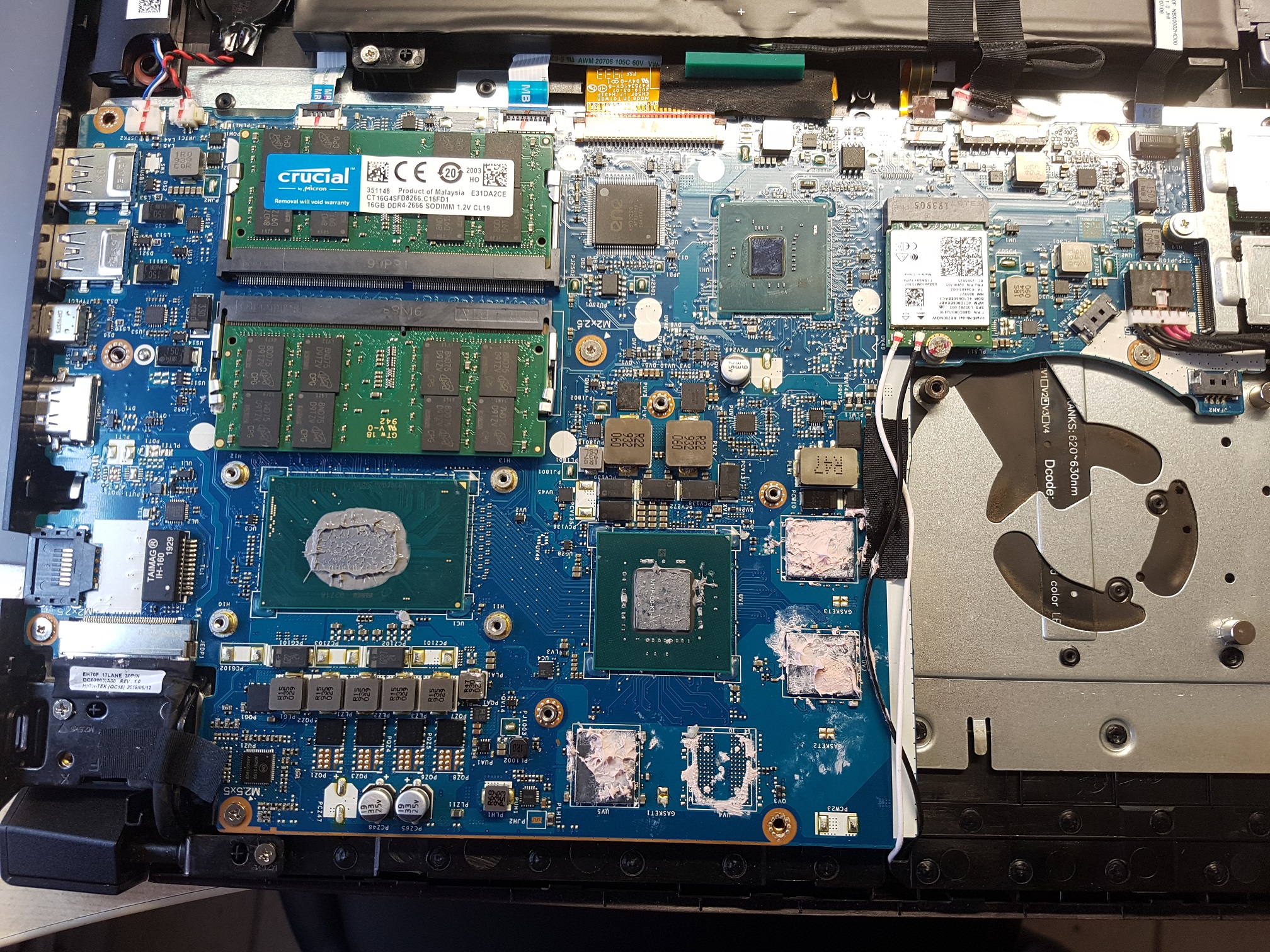

    Ive measured the coils around the GPU when machine is at login screen and I have PEX 1.8V , 1.5V for the VRAM and GPU coils have 0.29V which I find low but maybe normal when no load.
    For more experience guys, what can I check or measure in this situation?
    Not much to be done?
    Any inputs are appreciated.

    0.29V at GPU Core sounds to low. What resistance to GND do you have there? Measure with a exact multimeter, without power and substract the internal resistance of your probes.
    Could be a rare case where it is worth to do the shot into the blue by replacing the DrMOS and/or the Controller.

      Yes, o I have 0.6ohm if I substract the multimeter resistance of the probes.
      yes I tried to get datasheet of the QD9619A but doesnt seem to be available.
      Measured and compared few pins between them to see if I could find something but values are the same (they could still be bad as I dont have datasheet)
      I lifted both GPU coils and I have on GPU side the same 0.6ohm and on the DRmos side 56kohm+
      Still a good candidate for a shot?
      Danke!
      Im also tempted to do that.

        Yeah, almost nothing to lose i'd say
