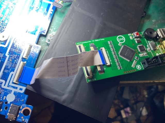

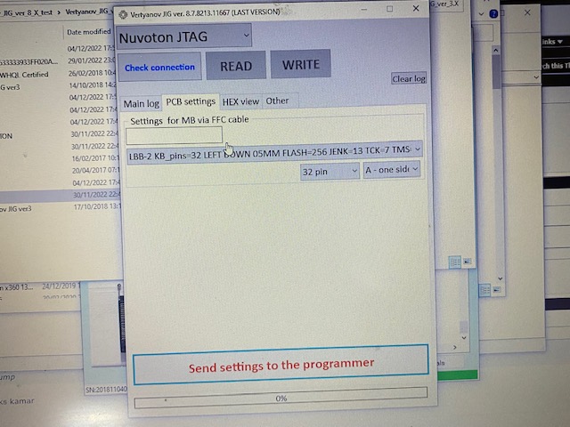

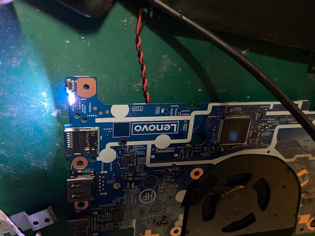

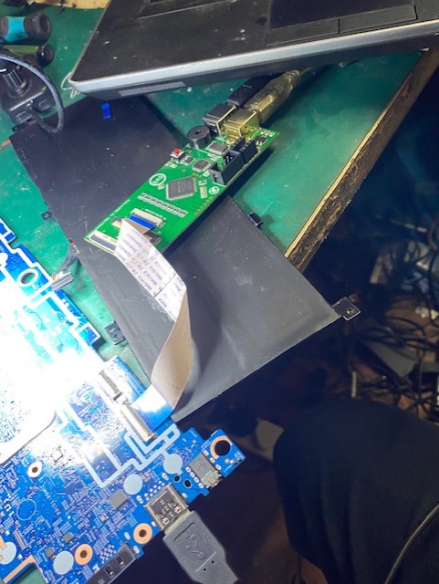

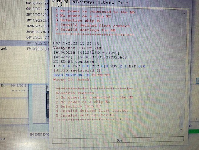

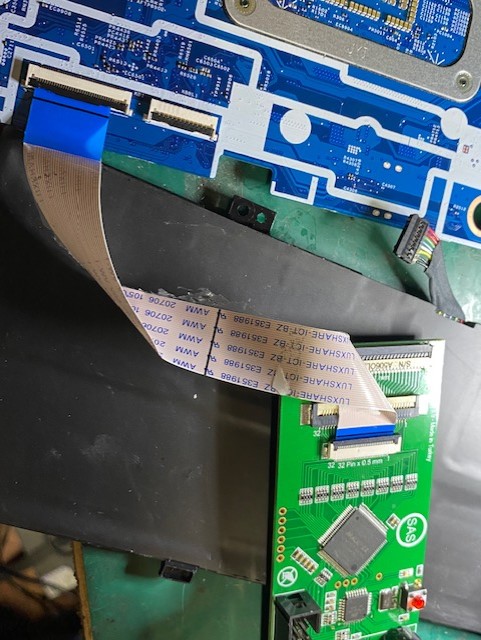

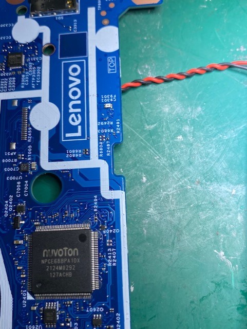

    Hello all I don't know if I am on the right section, I am trying to read bios from this laptop lenovo l13 yoga I think is 10 or 11th gen, lar-2 mb 9837-1
    I have used this program before and I have read bios from lenovo x390 but this board I can not seems to read it, I am using 32 pins and choosing lbb-2 256 jenk
    I have included some pictures here, I have paid version of verytanov which also works with sas programmer as I have tested and read bios before, motherboard is on when asked to be on, pins 1 on motherboard making connection with the reading board as it beeps on multimeter
    If anyone has experience any chance you can see if everything is correct
    Many thanks

    If you solved it, I have the same problem and I can't find how to solve it. but mine is a lenovo L14 gen 2
    NM-D271 CHIP=NPCE68BPA0
