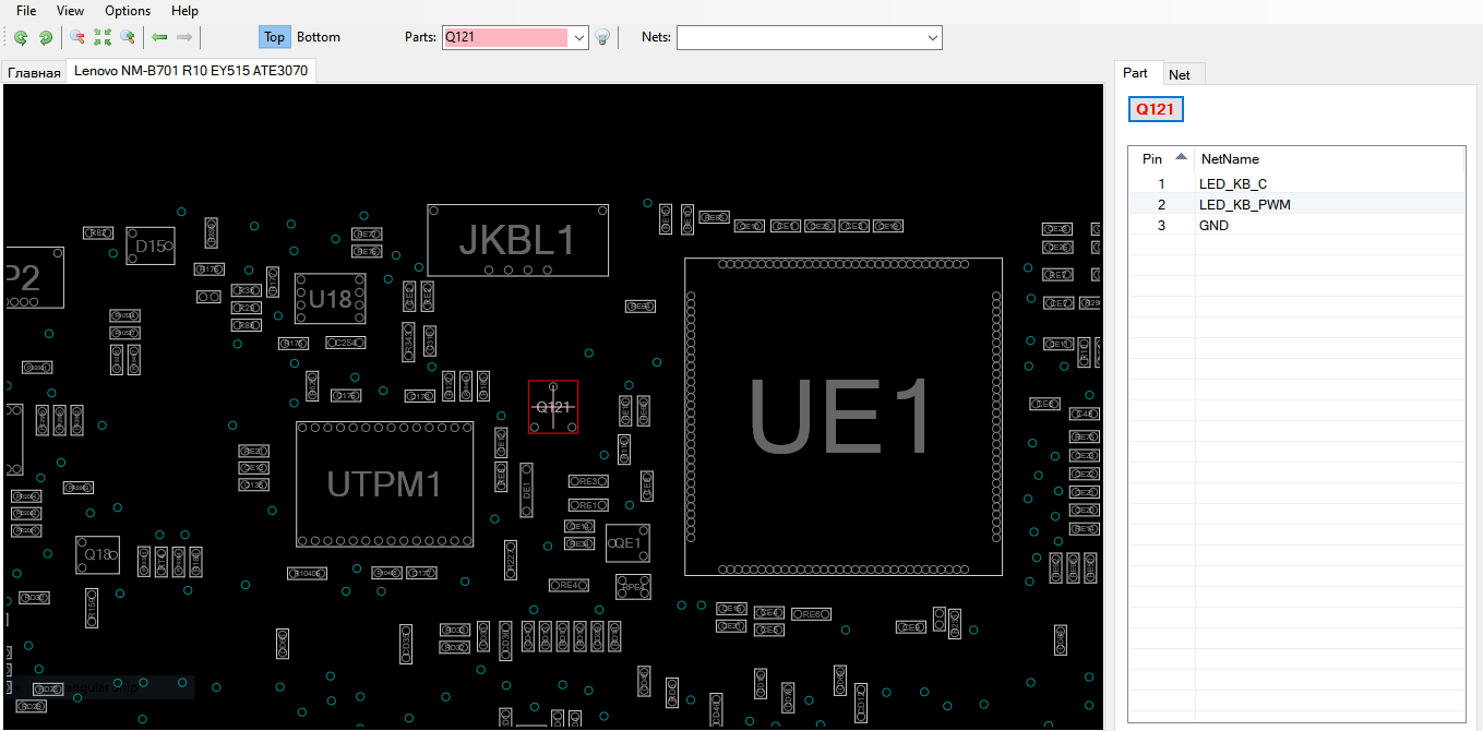

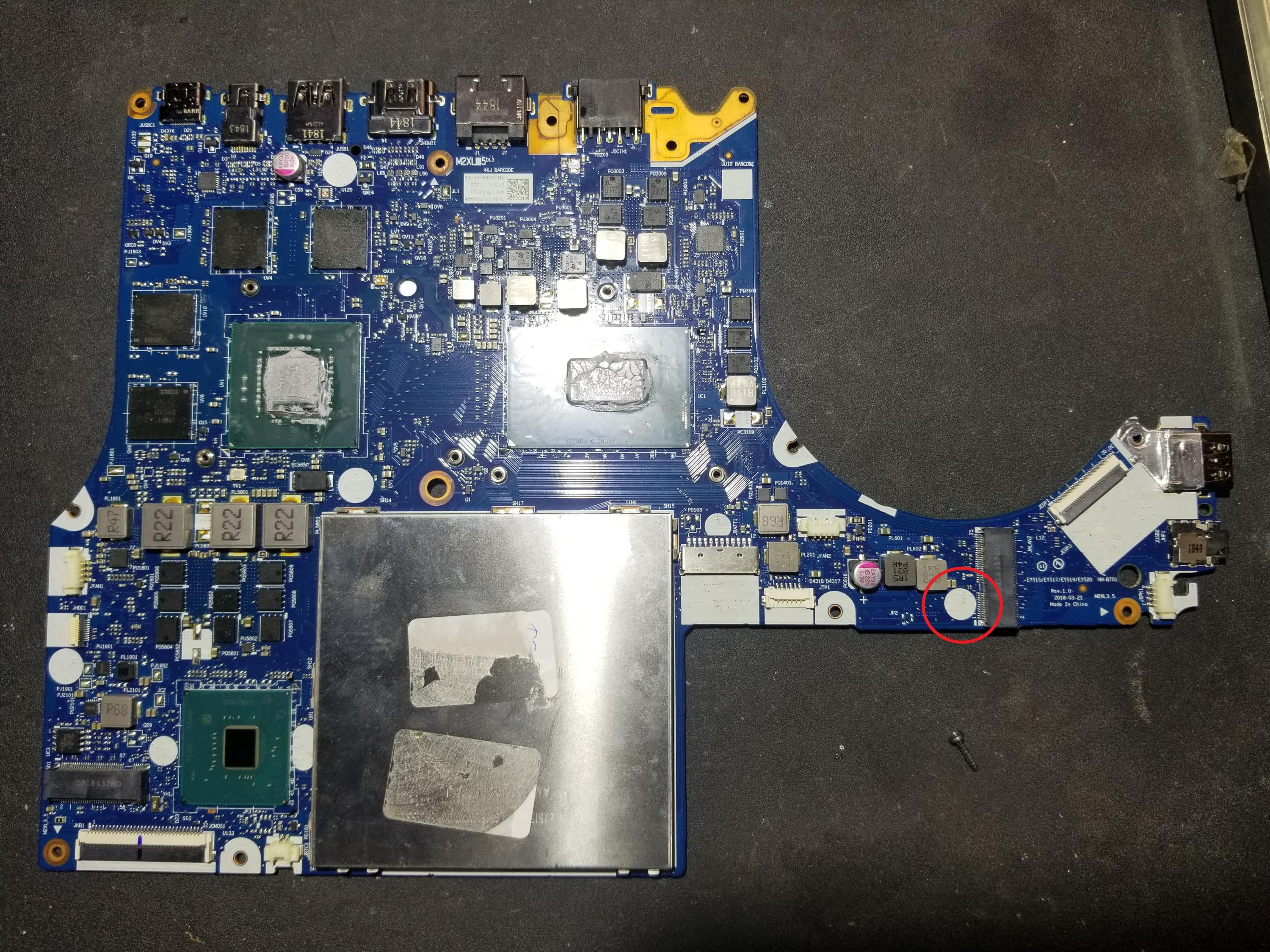

    Hello all! I recently picked up a broken legion y530 just for the fun of the repair.
    For motherboard repair, I am definitely a newbie, but I have always wanted to attempt it.
    These are the steps I've taken and what I've found so far. All images attached are relevant to the board.

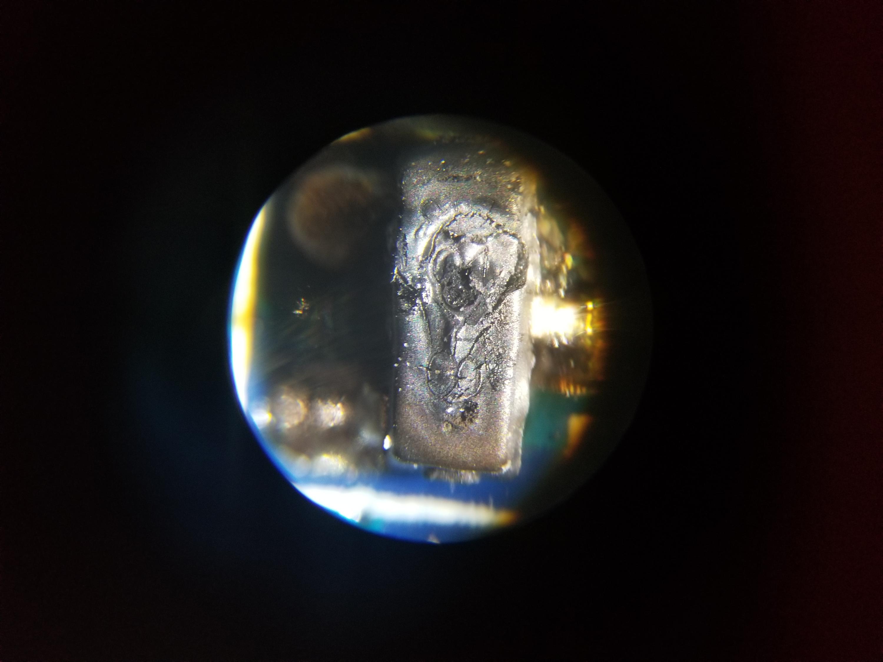

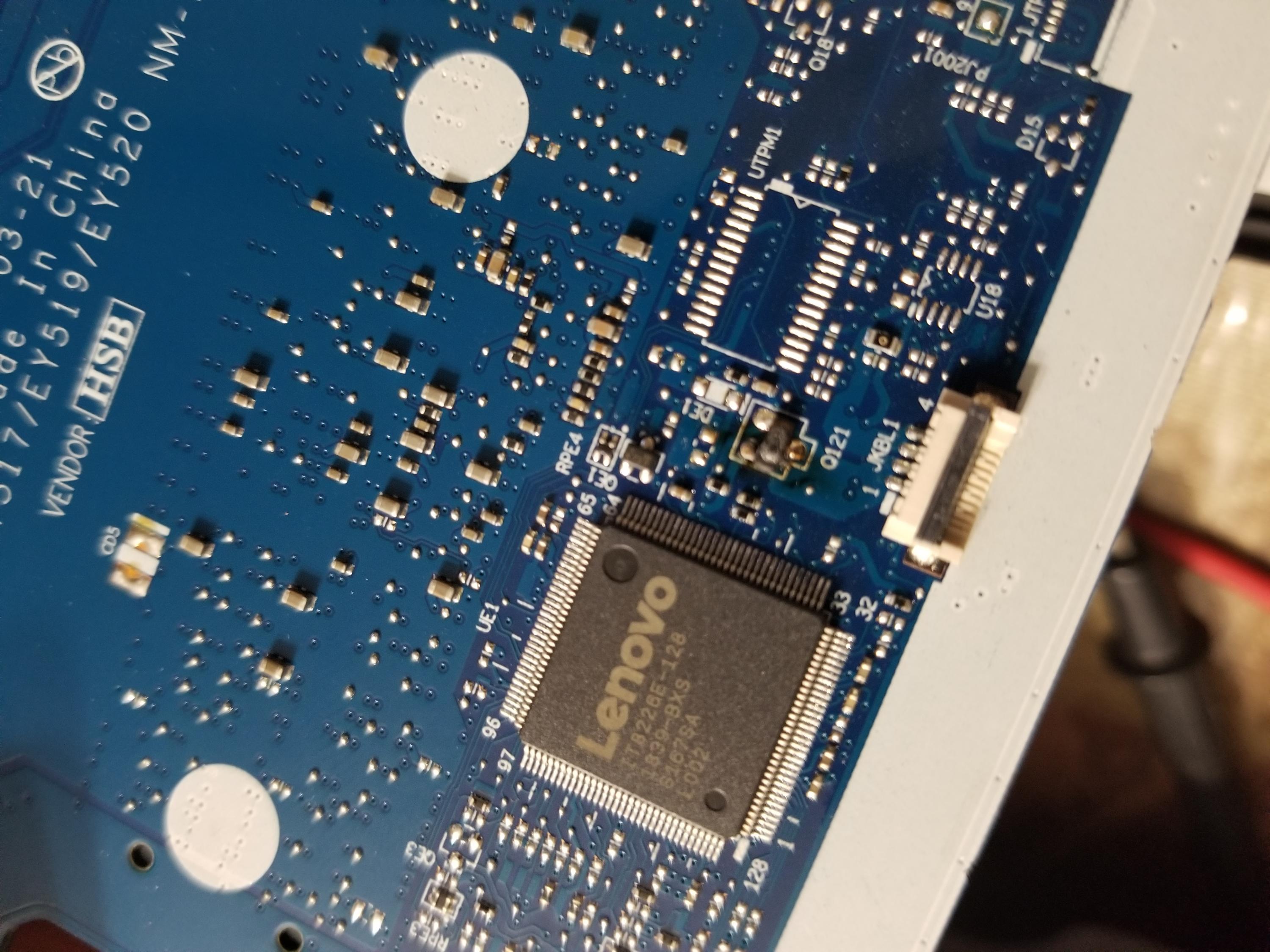

    -Machine does not power on. Light does not turn on when charger is plugged in. The charger is brand new and was not included with the laptop.
    -Laptop disassembled. Board removed. Power cable was not in all the way for one. Found a drill bit (for going through wood/metal- four inches long) on one side of the Motherboard. Found something charred on that side, I think a transistor?
    -I put it under a microscope for better visual, and attached it to this post.
    -I did a multimeter test, that charred piece appears to be grounding out on all three sides.
    -That charred piece is known as q121, two for leds, and one for ground
    -I partially reassembled the laptop and plugged it in. I looked through a thermal monocular, and noted that a spot on the motherboard was hot. Still no light or power on when reassembled again.

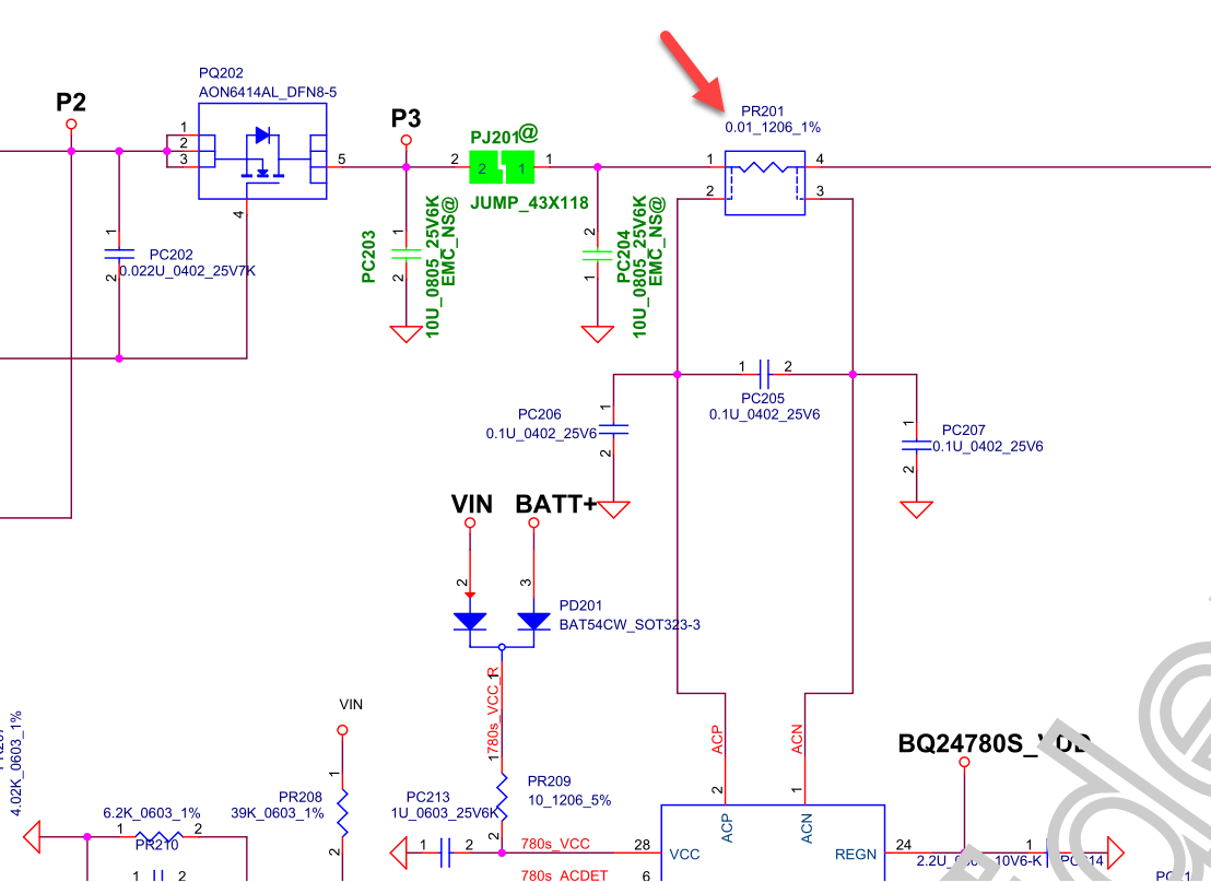

    I was curious if anyone knew what that charred piece is. Additionally, I performed a ground check on all of the areas listed on Tikanot's thread.
    Here are the values I got. I realize the power rail is good, so the others might be meaningless, but I figured I should post them anyways.
    PR201 - PR201:.000

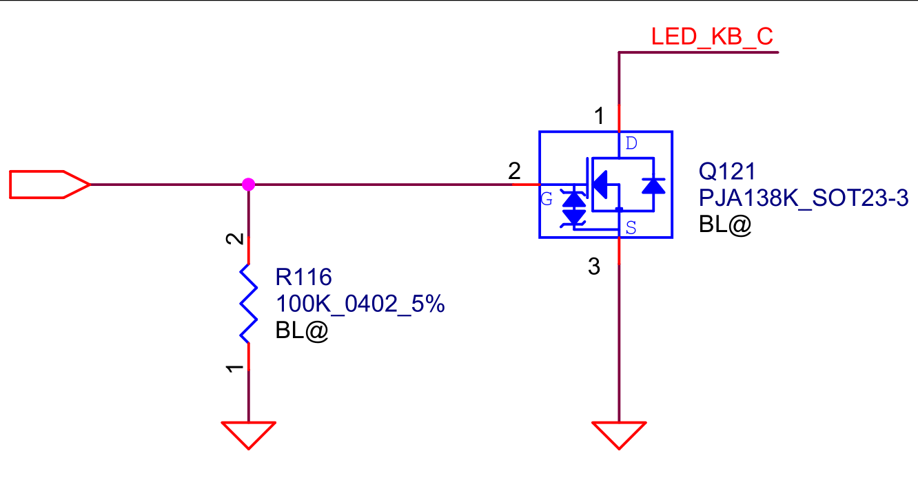

    Re: LEGION Y530-15ICH - Starting out
    Q121 = pja138k

        Originally posted by mon2
        Q121 = pja138k
        Thank you, I will begin looking into replacement mosfets.

              Can you confirm on how you are measuring these parts ?
              To check, for example, PR201 is a current sense resistor.
              One meter probe should be to the pad on the part. Other meter probe to ground (shield is ok).
              After the above, the resistance on the meter is reading @ 0.3 ohms ?
              That is a direct short to ground so does not look correct unless there is a shorted cap on this power rail.

                Sorry about the misunderstanding, the PR201 measurement in my last post is from the left side of the pad to the right side, essentially over the component.
                For all of the other components, I got a reading from either side of the soldered component, to a copper ground spot on the board.
                For the PR201 to ground, I got:
                Resistance Check: PR201 to ground - 57.3 K ohms.

                  Ok - so that leg is NOT shorting to ground. Good.
                  Perhaps a good idea to review your resistance readings again and post an updated list for a review. Some others are quite low in the list as well.

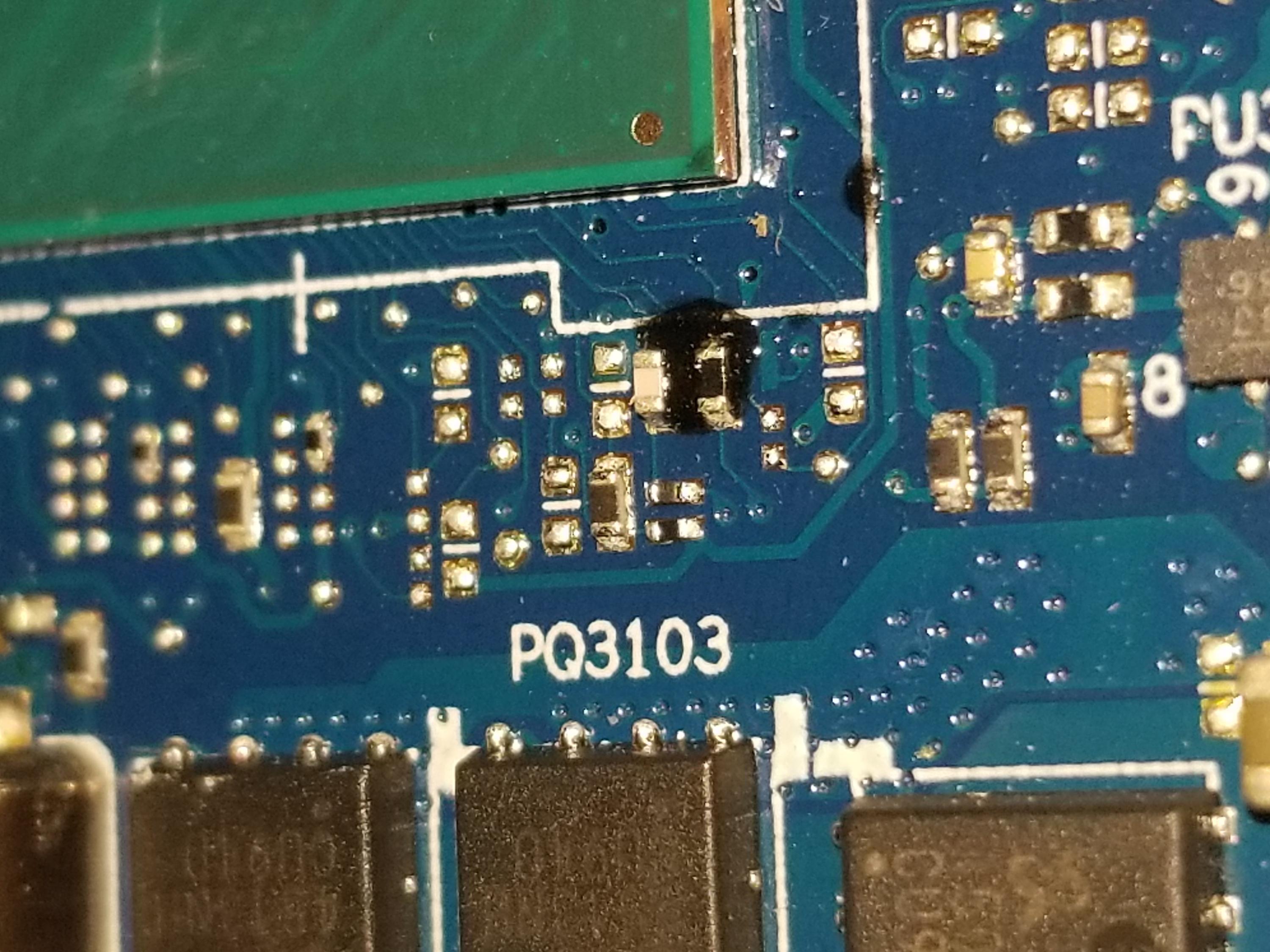

                        Additional checks this week:
                        -Checked near the previously mentioned PJ604 jumper. 20v goes in, area gets hot. The hottest spot on the board is at U132, on the other side.
                        -Near PJ604, is mosfet PQ603. 20v goes into one side, but no voltage goes out through the other pins on the fet. Expected 5v according to the schematic. Potentially bad? Or does this mosfet rely on something else being on before it can reduce voltage?
                        -PR3103 and PR 3108 are not grounding on one side. I cannot tell from the schematic or boardview if they are supposed to be.
                        -There is black stuff on the board in random spots. Especially on CC178 and 175, both have it all over them. Not sure if this is harmful. Picture attached.
                        Also, I was curious as to one of my previous posts. The resistance on PL1401 is high, and out of the specs I looked at, it can even be compared to PL2101, as that is the same part number, so this may need to be replaced, correct?
