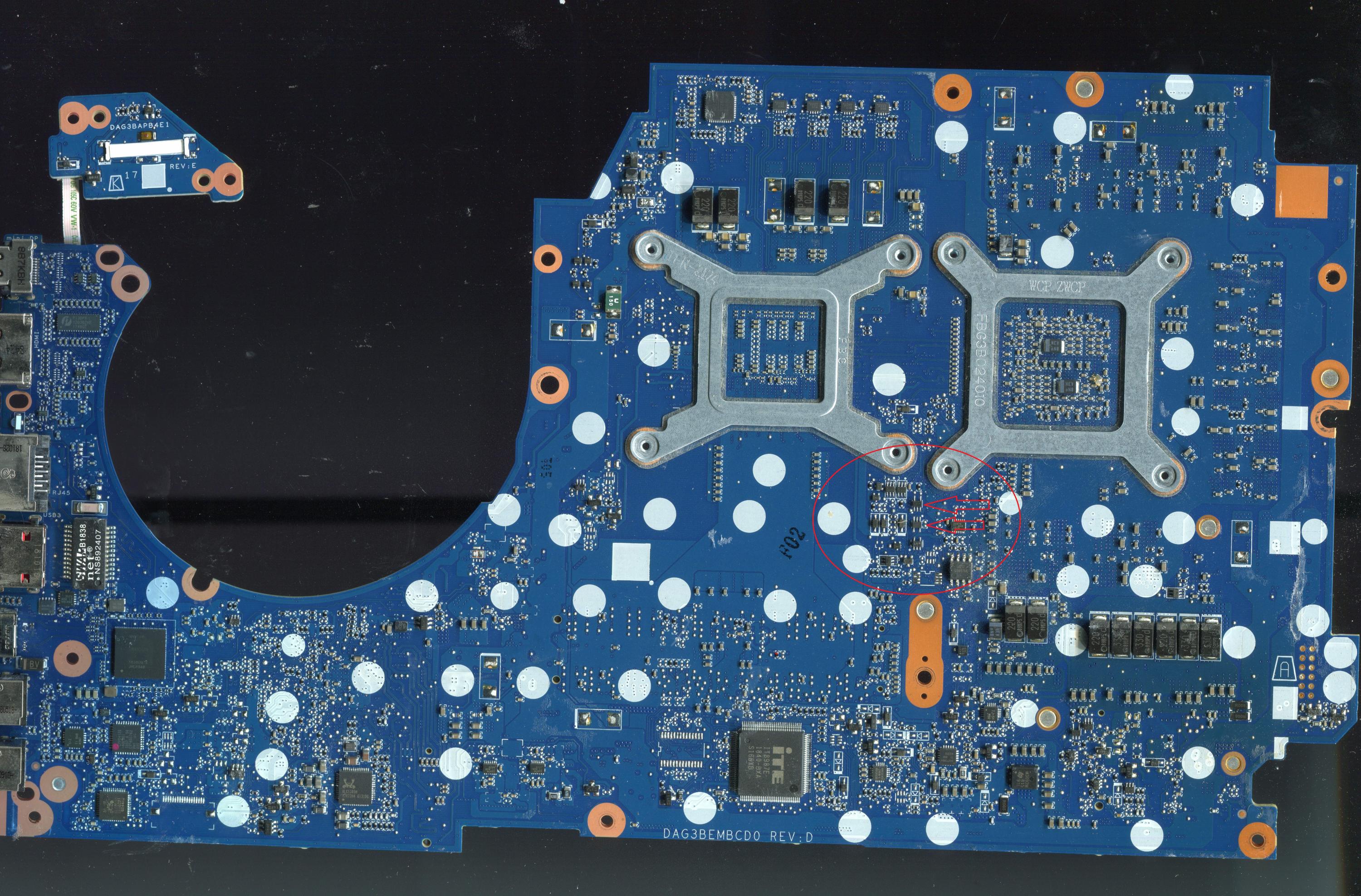

    Hi, I have a motherboard from HP Omen 17 (DAG3BEMBCD0 rev. D) with two SMD components burnt. They are labeled as "L2x" , the package is probably SOT-23-5.
    The components are labeled in the picture.
    Can someone please help me identify these components? I could not find the schematic for the motherboard. The closest in terms of SMD markings are APL3512 (marking: L2A1, L2A4, .. L2Ax).
    Thank you for any help or advice.

    Re: Please help me identify SMD components on HP Omen 17
    Unable to find a schematic as well.
    Appears to be SOT23-5 package.
    Are the markings from the topside of the burnt components?
    Measure the voltage to ground of each pin of these parts.

      Is there a dot directly under the 2A .Are there any other dots or slashes or just the letters and numbers

        My bet is on NL17SZ08, so an AND-Gate
          logic gate NL17SZ08DFT2G
          not the same schematic and brd, but very similar and good for the circuit interpretation
              to SMDFlea:
              No there is only L2x (the "x" has different font).

                  AND
                  Truth table
                  Sephir0th F
                  rediii F
                    • 21889
                    As it doesn`t have a dot anywhere i don`t think its an ON semi part. The x could be a vertical date code, or lower case x L2x
                        Hello again, I've been busier so I'll comment later.
                        I think I identified the wrong package and it could be a UML2N in a SOT-353 case.
                        https://cdn.badcaps-static.com/pdfs/...975aa47294.pdf
                        Do you think that's possible?
