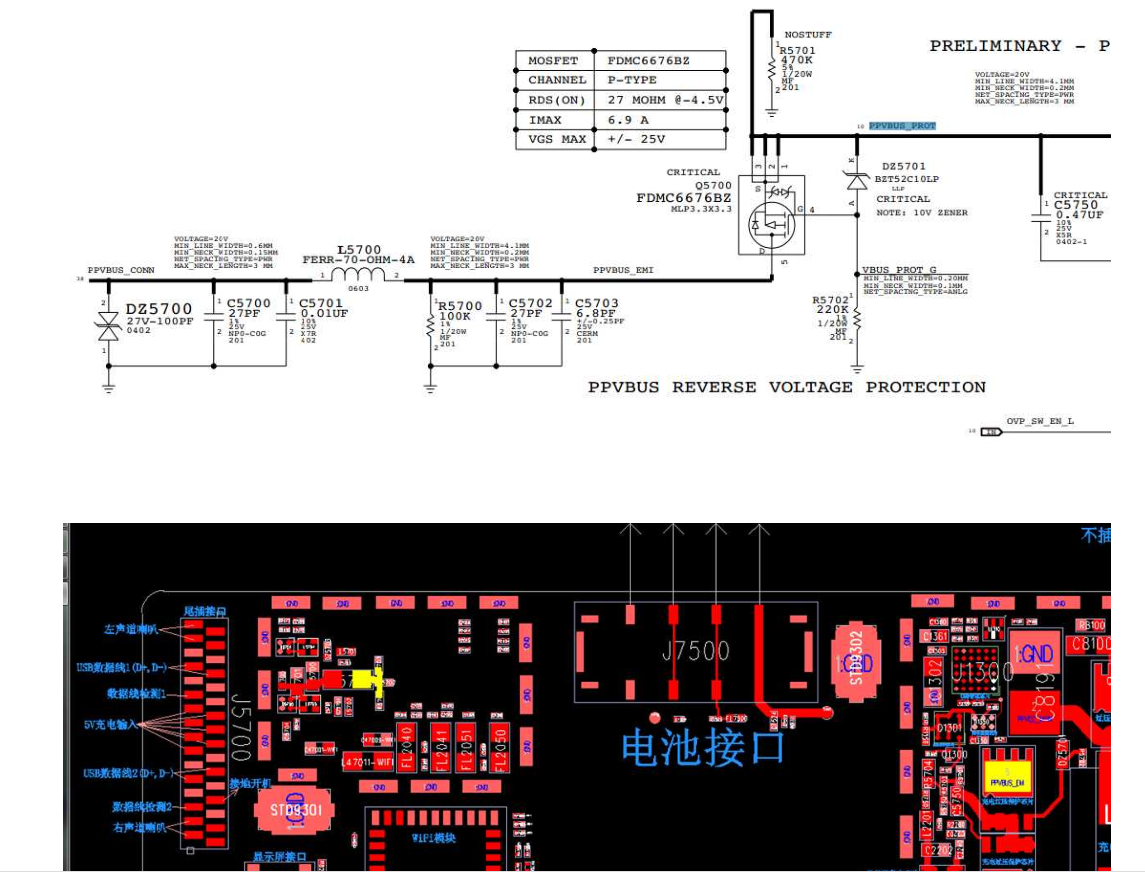

    Working on an iPad mini 1 for data recovery. At first I thought it was back docking flex, so I replaced it, but still no charge.
    Device is taking 0 amps. When checking my soldering job I measured OL on all PPVBUS_CONN pads. Traced the line, 5V gets to the tristar, so no clue how to continue from here. Should I just assume tristar is bad?

    It is very possible that the tristar IC is defective and needs to be replaced but do you have a lightning breakout test board ? Or perhaps a Tristar tester?
    Ben's Tristar from Germany is good but has a design flaw which he was being stubborn to listen to our advice. He is unable to charge the module using Type C PD power adapter connector. We shared the fix but he is in denial and does not believe there is a flaw. Our free consultation services are closed for his case.
    With the lightning breakout board, you can perform diode mode testing to determine if the tristar is defective. Plan B is to just replace it but be aware that it is a tiny bugger and will take extreme care and proper tools / skills to replace it. There are some good videos from Louis and Alex (Northridge) - both helped us to learn the process. Louis with his 'make it dance' is priceless. Lots of flux and hot air in circles till the IC 'dances' -> remove it -> apply standard leaded low temp solder -> flatten with soldering braid -> flux and apply a fresh tristar IC.
    Plan C is to seek out a local cell phone tech shop that probably does this repair daily.

      Re: iPad mini 1 - OL on PPVBUS_CONN
      Hey Mon!
      I do have a tristar tester (this one: http://tristartester.com/en/), it indicated docking flex, that's why I replaced it in the first place. But it keeps failing the test 9 out of 10 times when testing again with the tristar tester. I triple checked my work on the docking connector, so very sure that's not the actual issue.
      Don't have a breakout board, sorry.
      I have experience with iphone 7/8 tristars, did about 15 of those so far so I should be fine on replacing this one. I just like to avoid unnecessary risk. And I did learn mainly from those 2 people indeed haha, and don't forget Jessa!
      Guess I'll just replace it then, thank you for the advice!

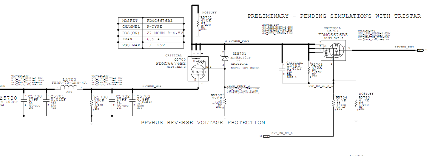

        Replaced the tristar, but no luck. Line keeps measuring as OL.
        My next assumption was that it's the zener diode, dz5701, but took it off and it measures correct.
        Mosfet Q5700 has 4.8v on source and drain, 0v on gate.
        Mosfet Q5701 is not letting power trough, I have 4.8v on source and 4.6v on gate.
        I'm lost :')

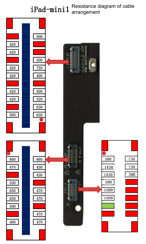

              • mon2
                • Dec 2019
                • 14002
                See attached. From my paid database which they call as resistance readings. However, believe these are DIODE readings.
                Meter in DIODE mode -> red meter lead (yes red) to ground.
                Black meter to point to test.
                Check the readings against this chart and post your updates.
                update- check the voltage to ground @ L5700. Do you see 5v from your USB power adapter ?
                  Sorry, went to bed yesterday ^^
                  Measured the connectors, all have the same reading as the chart you provided.
                  I have 5v on L5700, the dockingflex should be fine.
                  What I am wondering about atm is Q5701. I have 4.6v on pin4, the gate, but if I'm reading the diagram correct it should be <4.5v to let the mosfet pass trough power. Or am I reading this wrong?
                    Yes, P-channel requires a lower gate voltage than what is being passed between source & drain pins to enable.
                    What are the voltage readings on each side of R5704? The 2*resistors on the gate are creating a voltage divider.
                    If the bottom resistor is a logic low, then the voltage at the gate will sink down enough to enable the P-channel mosfet. Also remove all power and confirm the resistance of the voltage divider resistors on the gate of this P-channel mosfet.
                    While you are doing resistance checks, check the resistance of this mosfet as well:
                    Source & drain
                    Source & gate
                    Gate & drain
                      I got it! Been going at this all wrong. One of the feedback lines was damaged, so the iPad went into overcharge protection
                      Thank you for the assistance! This has been a very learnable experience once again!
