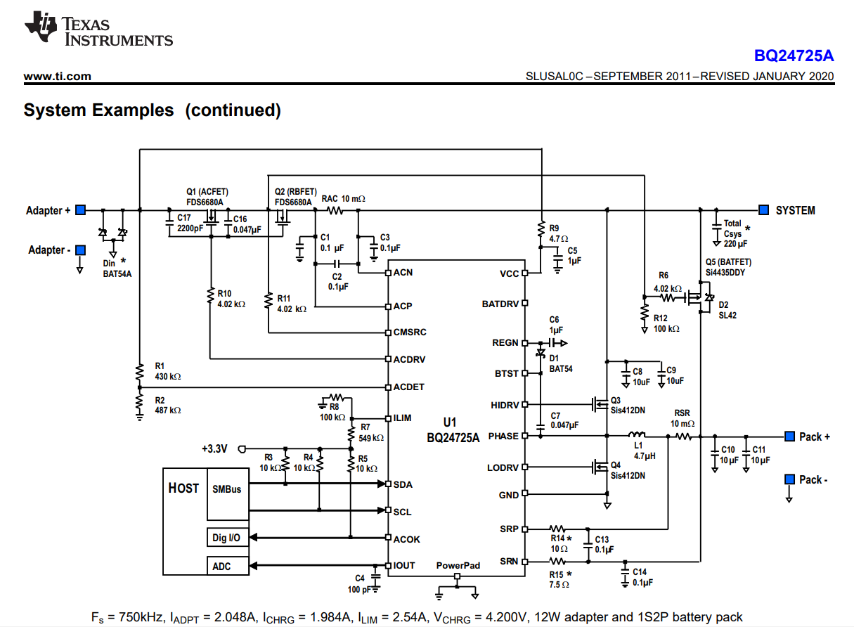

            What are voltage readings on each pin of the battery connector?
            Locate the battery connector and there will be nearby mosfets for:
            Battery mosfet that will turn on during battery only mode.
            High and low side mosfets to charge the battery pack using the 19v external power adapter feed.
            What charger IC is on your board? Likely the TI 'BQ' charger series? Share the full markings of this IC for a review.

                    From the details of the charger IC markings we will have a better idea of which logic is onboard since the schematic is in the witness protection program. Common to Asus.
                    The charger is most likely the BenchmarQ (TI) series but do post the top side markings / pics. Then we can review against reference datasheets or other schematics that feature this controller.
                    Update:

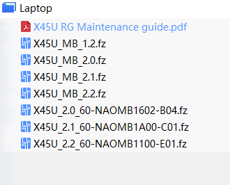

                    1) Found the repair guide and assorted BV files for this logic board.
                    2) The charger IC onboard is the BQ24725. Datasheet is attached.
                    The logic board will have a similar schematic to the one that is attached.
                    So this logic board will be fitted with 2 x DCin N-channel mosfets; high & low side battery charge N-channel mosfets; battery pass-through mosfets.
                    Which version is your logic board ?

                    • dokterpc
                      • Aug 2020
                      • 47
                      • Indonesia
                      Re: Asus X45U on off repeatly helpp
                      My version logic board is x45u rev 2.1, yeah ic charger is bq725,
