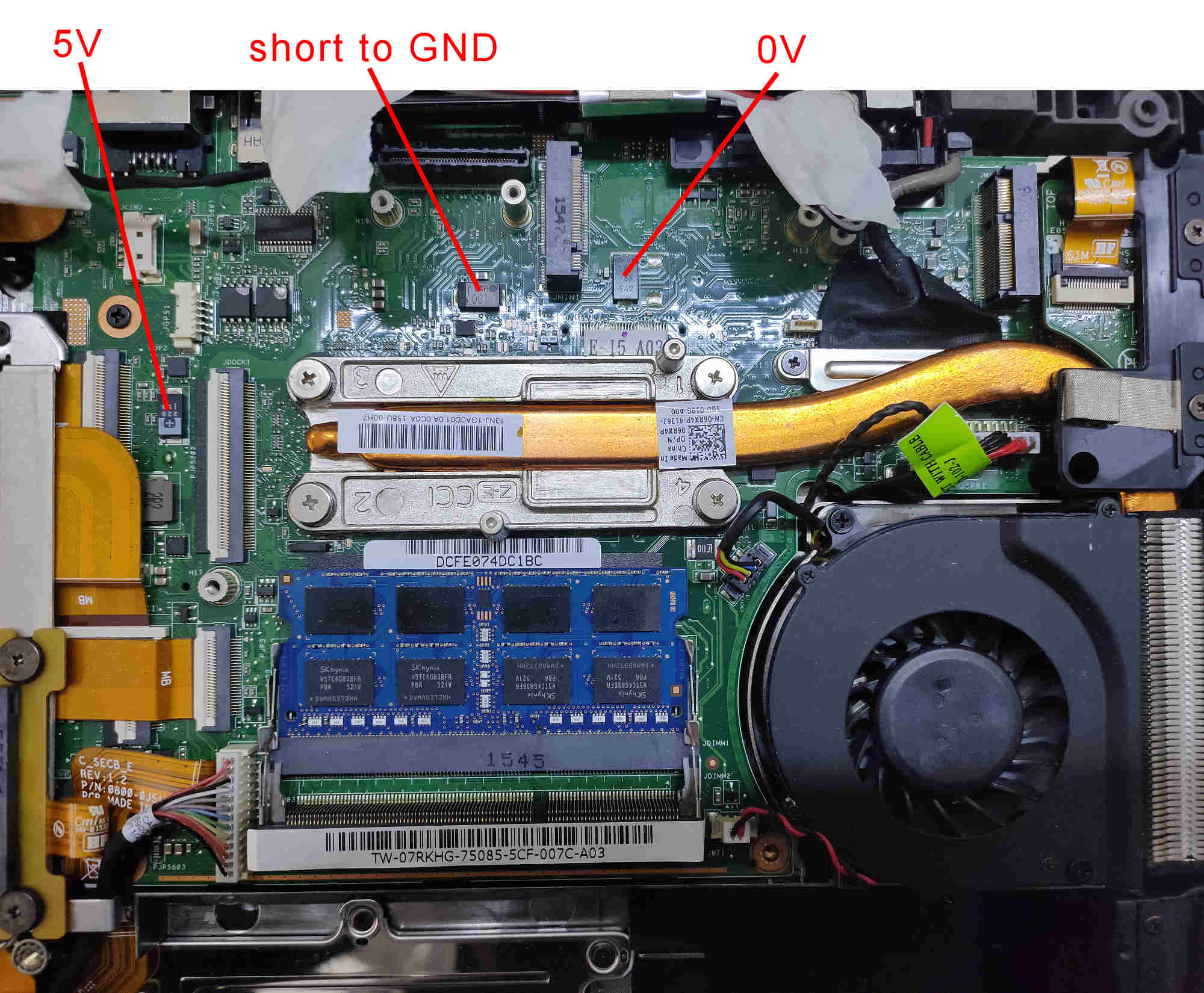

    Hello!
    A client brought a Dell Latitude 14 rugged 5404 that looks like half dead.
    In short, pressing power button:
    - power led turn on for 17 seconds
    - nothing more (black screen, fan not spinning, no sound)
    I've already:
    - cleared CMOS
    - changed RAM
    - backed up original BIOS & flashed A18 BIOS (1x 4MB + 1x 8MB chip) using istructions on https://www.badcaps.net/forum/showthread.php?p=1010808
    What else can I check ?
    I'm looking for board schematic & boardview.

    Re: Dell Latitude 14 rugged 5404 - half dead
    Some readings attached.
    5V is always present.
      What about the other rails? 3.3V, Vcore, Vram? Is heatsink getting hot?
      When you programmed the chips did they pass read verification against master file?
        Will check that with schematics and report back.
        Yes!
          Turned OFF / ON:
          +3.3V_M (@BIOS) = 0 / 0
          +VCC_CORE (@PC5612) = 0 / 0
          VRAM to be measured...
          Heatsink is cold
            +1.05V_RUN (@CC78) seems to be short to GND
            Removed CC78, still shorted.
            Removed LC6:
            - CC78 not shorted anymore
            - pin1@LC6 (+1.05V_RUN) still shorted to GND
            Removed L77 & L78 but +1.05V_RUN is shill shorted to GND.
              Usually shorted 1.05V rail is a dead PCH.
                Removed CC71, C389, CC55, CC79 but +1.05V_RUN is still shorted.
                Injected 0.8V 1A on CC71 pin1 (+1.05V_RUN), found 0.08-0.10V on remaining caps belonging to 1.05V rail (CC33, CC34, CC37, CC60, CC63, CC64 just below the MCH)
                As said by @reformatt I think the PCH is dead.
