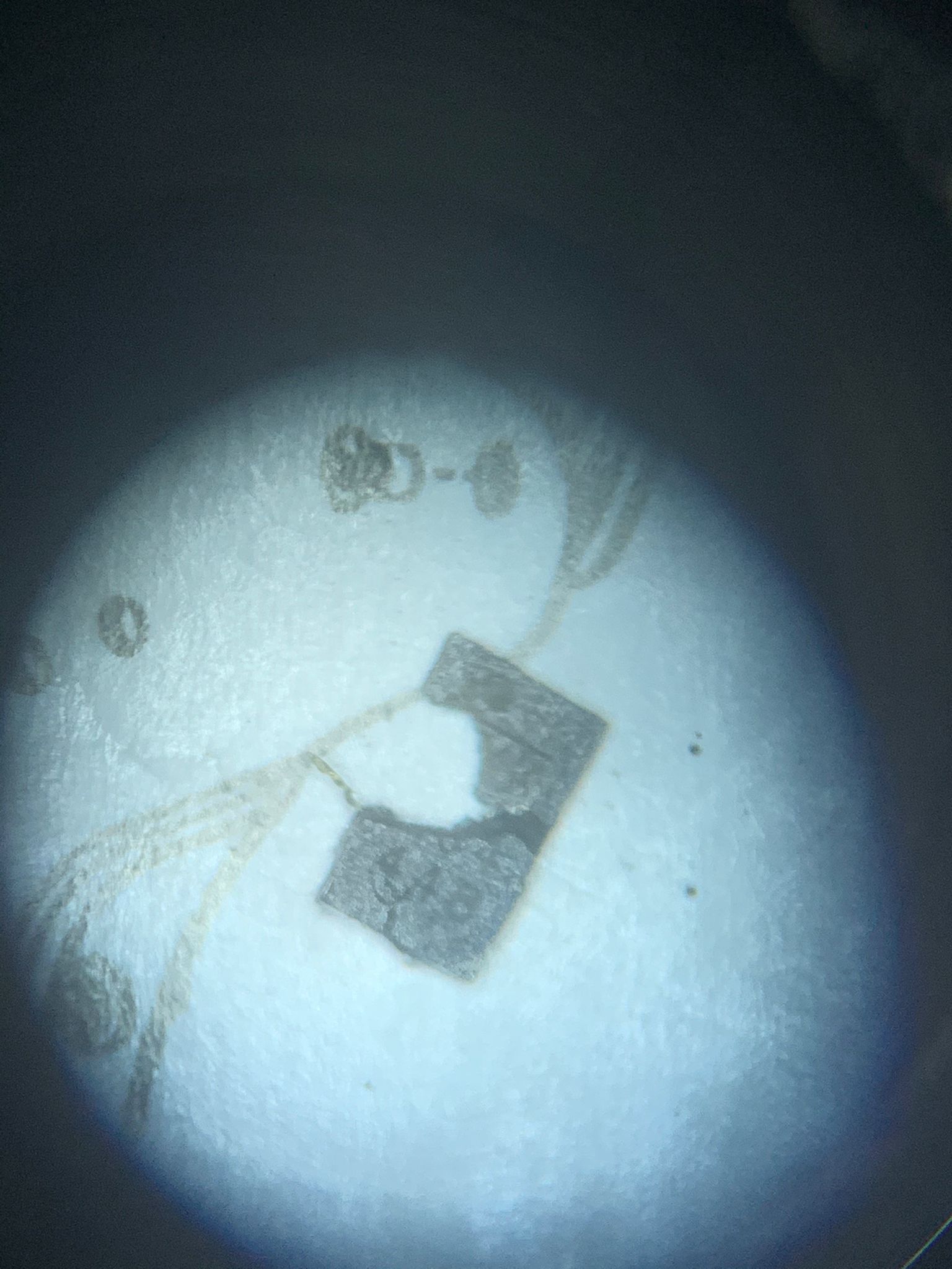

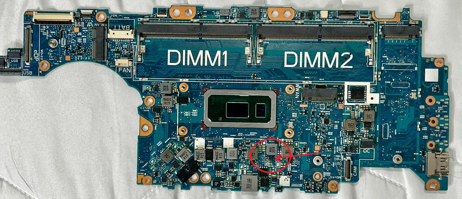

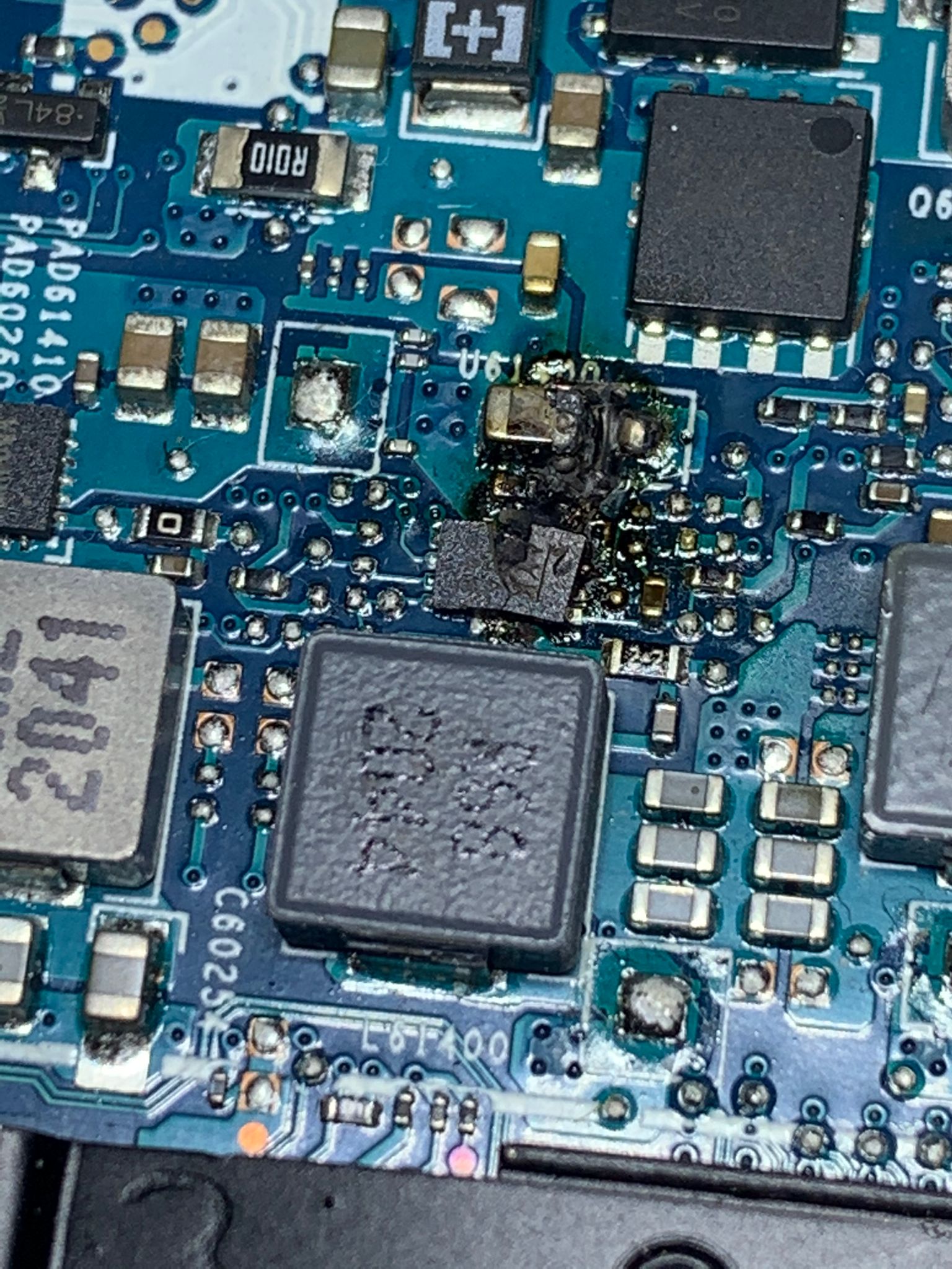

    I have a HP Elitebook 840 G7 with a couple of burned components, 2 caps and a black chip/mosfet ( i think).
    I now it's a long shot but would like to try to repair it
    I need a clear picture of the black chip so I can see if I can order that one online.
    logic board nr : m08559-601
    Thnks

    monolithic power system model number AYK?
    • rediii
      h???, spurrrn
      • Mar 2018
      • 501
      • somewhere in europe
      Re: HP Elitebook 840 G7, need clear picture of component. m08559-601
      NB692GD-Z AYK QFN maybe this? search on aliexpress

        Look like it ! Thanks !
