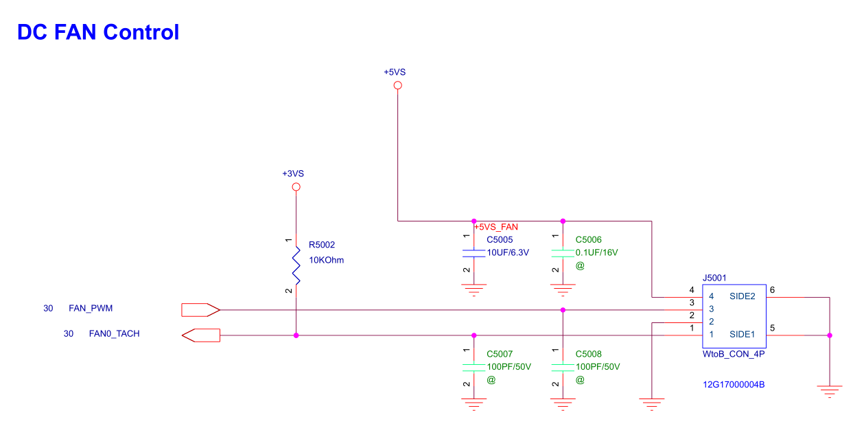

        Re: Asus X550LD Fan spining non stop
        Update :
        Try many official version ( 308 /302 ) merging and clean me same issue
        Try this solution : https://www.badcaps.net/forum/showpo...5&postcount=14
        same issue
        No short to GND for J5001 connector with pin 1,3 and 4.

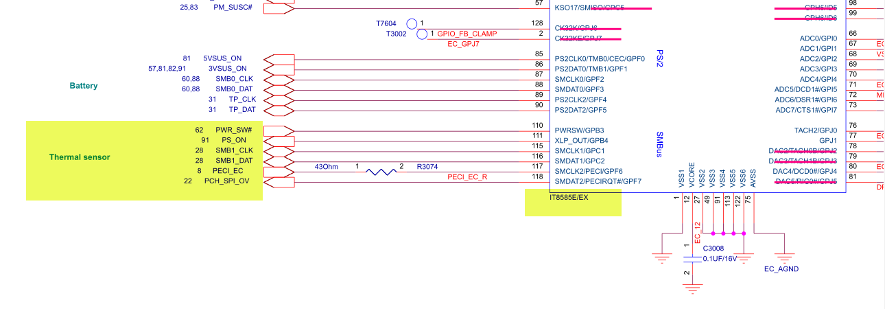

        Question : i know that IO is auto programable from bios ..is it true for this motherboard because i see many share with 2 files ; bios + io !.
        Any other suggestion !!
            Originally posted by mon2
            A fan is usually triggered by a thermal sensor.
            What are the temp readings for this logic board?
            The fault could be a bad sensor or the communication lines used by the sensor (s).
            Yes you are right , but in this case fan is controlled by sio chip , no resistor at this direct line between fan connector and io.
            i try another fan as suggested here but same issue : https://www.badcaps.net/forum/showpo...67&postcount=2
            maybe a io chip problem !!

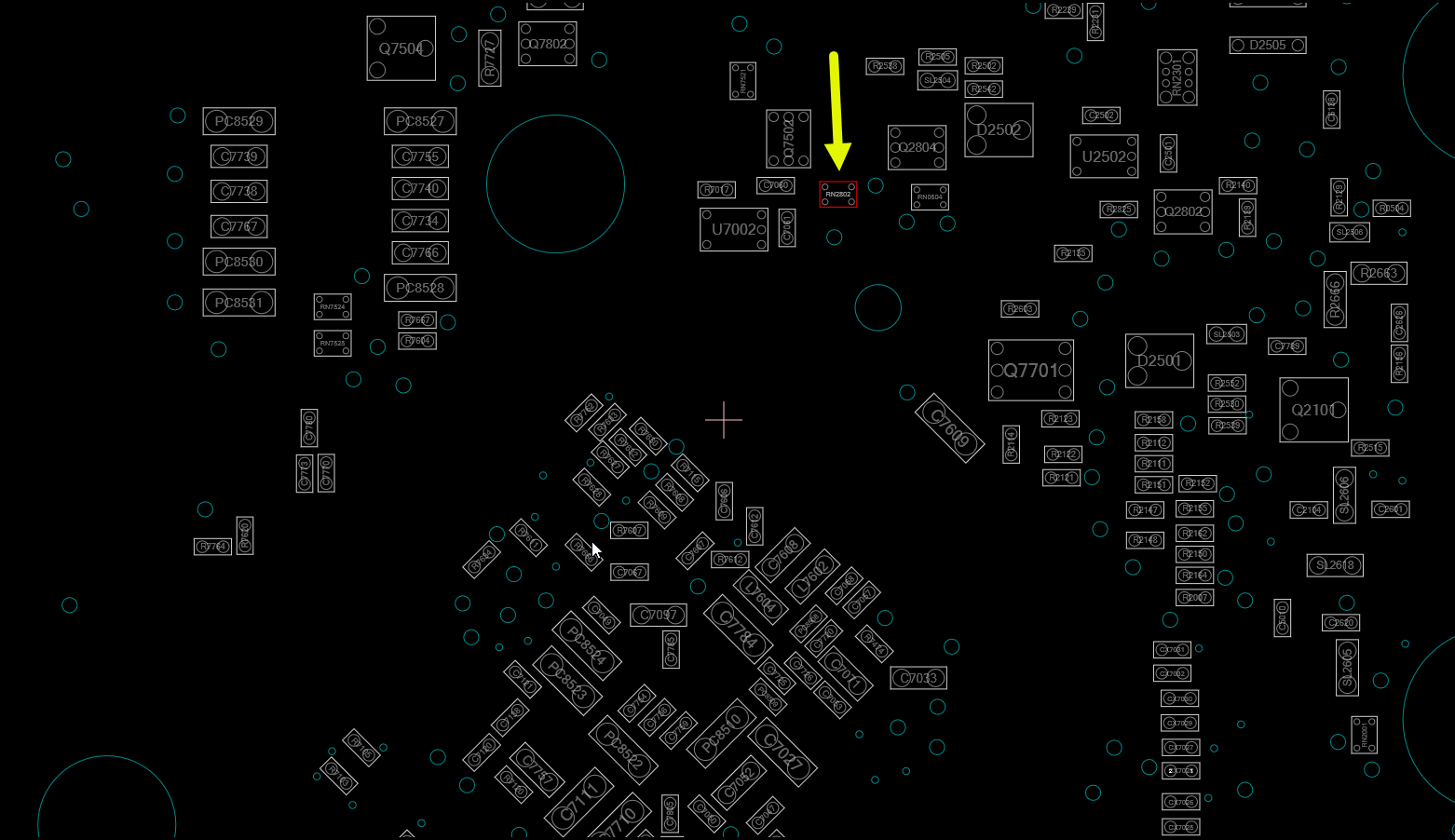

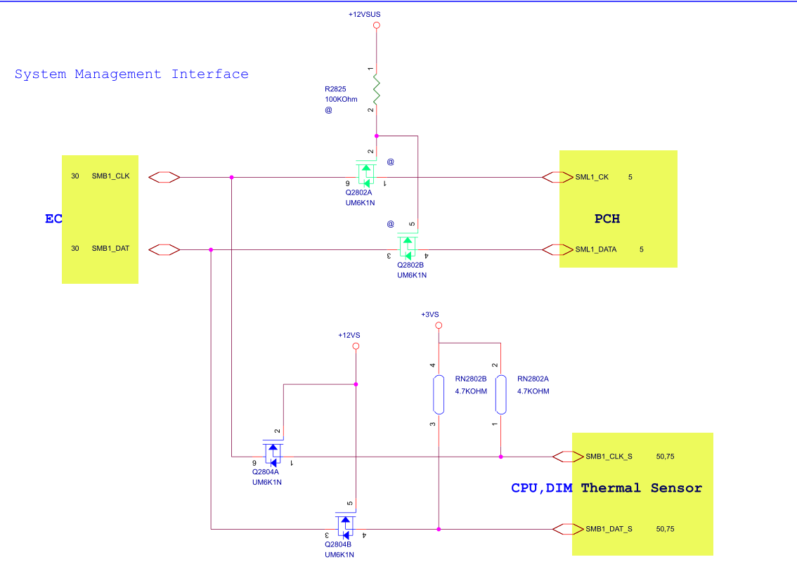

                  See attached.
                  The temps may be normal but the sensors report the true temps. If the SMBUS (aka I2C) interface is not working properly for these thermal sensors, the sensors will show that the temp is not normal and the fan will spin non-stop.

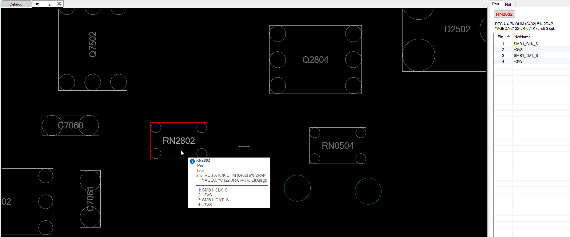

                  Locate RN2802 on the logic board and measure the voltage on each leg of the resistor network. These are the local pull-ups for this open-drain interface.
                  Next, review the voltage readings on:
                  SMB1_CLK
                  SMB1_DAT
                  The above signals are to the LEFT side of the mosfets Q2804 (pins 3 & 9). While you are there, also measure the GATE voltage of each of these mosfets (pins 2 & 5).
                  Do you have the boardview and schematic files for this logic board ?
                      yes i also see this .
                      Yes have BRD , i don't know why is deleted !
                      RN 2802 measurements :
                      4.7 K ohm OK
                      1 = 0.150v...is something wrong with this measure !
                      2 = 3.03v
                      3 = 3.3v
                      4 = 3.3v
                      Q2804 :
                      1 = 0.150v
                      2 = 13.46v
                      3 = 3.3v
                      4 = 3.3v
                      5 = 13.46v
                      6 = 0.150v
                      EC
                      SMB1_CLK = pin 115 = 0.150v
                      SMB1_DAT = pin 116 = 3.3v
                      more measure for SMB1_CLK
                      Q2804 :
                      1 = 0.150v
                      6 = 0.150v
                      i trace this SMB1_CLK until RN7521 :
                      2.2k ohm ok
                      pin 2 ,3 and 4 = 3v
                      pin 1 = 0.150v
                      And i think the signal start from U7001
                      What do you suggest !

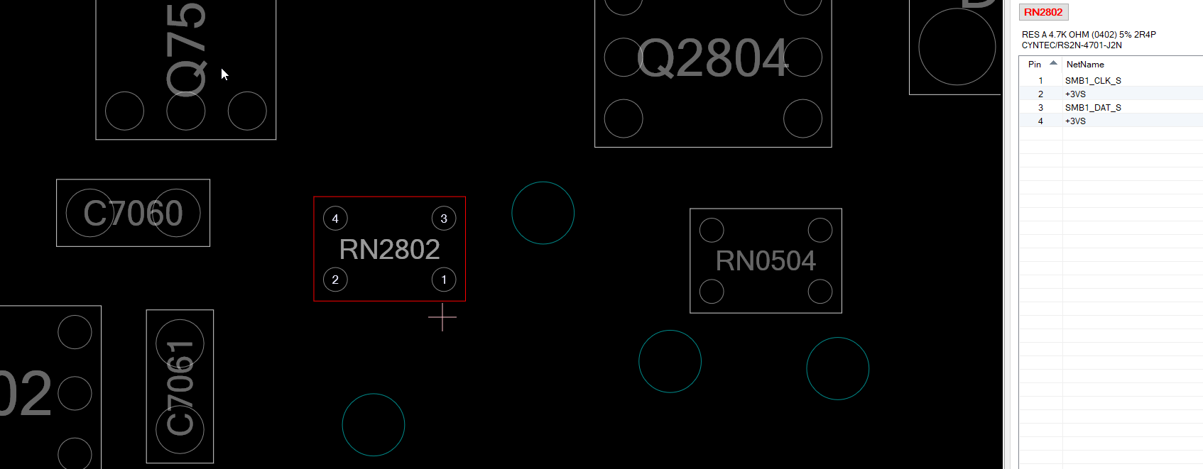

                          Remove all power -> meter in resistance mode.
                          What is the resistance to ground of pin # 1 of RN2802 ? (pull-up for SMB1_CLK_S)
                          Also pin # 2 of RN2802 should be exactly the same voltage as on pin #4 of RN2802 (confirm this).

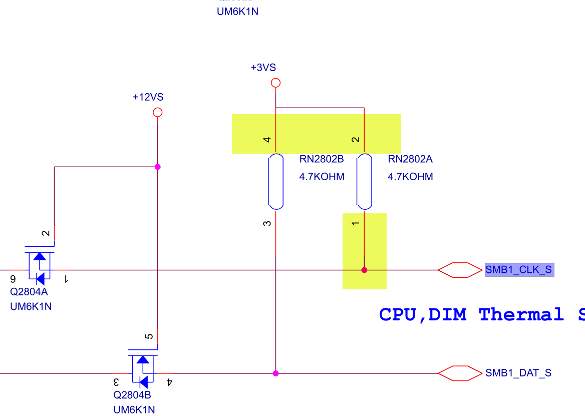

                            Good that you are also tracing and probing the entire SMBUS rails. This is important.

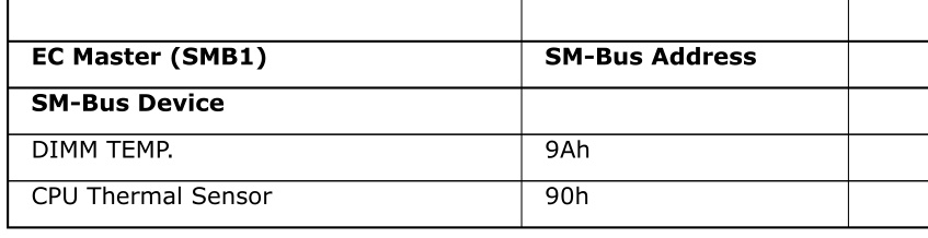

                            The SMBUS interface, typically, has a single BUS MASTER and multiple SMBUS slaves (note - the terminology is being reviewed for political reasons in the industry but this is what I grew up with).
                            Respectively, each thermal sensor is a SMBUS slave and has its own SMBUS address. Only the SMBUS MASTER can initiate the communication - not the slaves. If the SMBUS master sends out a command with an address, only the node (temp sensor in this case) with the matching address will reply back.
                            If the CLK or SDA line is stuck then none of the SMBUS nodes will be able to offer the correct sensor readings. Then only the code inside the IO controller will 'assume or default' to some kooky value for which turning on the fan may be the default action. This is the operation of the SMC bypass on macbooks - ignore sensor readings and run the fan full speed.
                            Using a $5 I2C bus analyzer from Aliexpress will show all of the gory details.
                            Each mosfet in this leg of the circuit is acting like a level translator between different voltage rails. The mosfets are bidirectional so if ANY part of the circuit is LOW on the CLK line (or SDA line) then the entire CLK line will be low. It does not matter who does this pull-down but a single participant can haul down the line to a low level.
                            If you are ok with it, consider to flux and remove (for a quick test) - the dual mosfet @ Q2804. Proceed with caution so that other parts are not disturbed.
                            After this Q2804 is removed, check the voltage again of this SMBUS line.

                              RN 2802 = resistance mode. =
                              pin 2/4 = 4.8k ohm
                              pin 1 = 11.60k ohm
                              pin 3 = 11.60k ohm
                              Q2804 removed
                              Rn2802 pin 1 = 0.109v
                                Resistance is OK.
                                Someone on this line is pulling SMB1_CLK_S LOW.
                                Remove the dual mosfet @ Q2804 and test the voltage again on SMB1_CLK_S.
                                Update - still LOW so the IO chip is NOT the fault. This is a good sign.
                                Next, proceed to remove Q7502. Then measure again the voltage.
