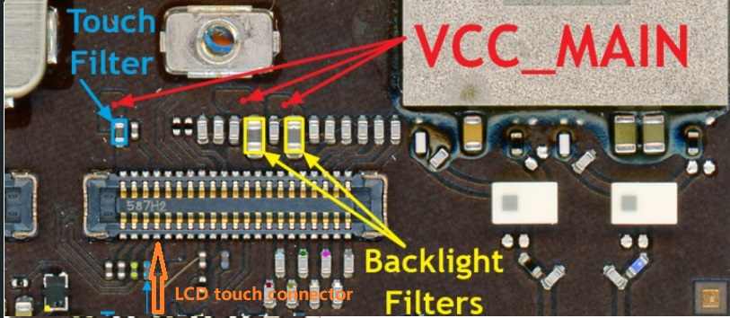

    hello,
    does anyone have schematic and boardview for iPad pro A1652.
    i have problem with no image and backlight.
    before the 0.7 ohm coil for image was burnt and i replace with coil from iphone 6 but it burnt again, and i replaced with coil from 6s plus but now no image at all. please advice

    What is the current draw? Perhaps the backlight fuse or backlight IC is now defective?

      hi @mon2,
      current draw on usb meter 1,8 amps and i hear ding sound.
      backlight fuse is beep when test with continuity mode

        https://www.youtube.com/watch?v=jhbr4qVc65Q
        Check for missing / defective parts in the attached pic.

          already check, filters and coils are ok.
          or maybe the amps of the coil i changed is different?

            Yes, be sure to use the proper rated coils. Not sure if the parts you have applied are able to handle the required current. Start with replacing them again but with confirmed higher current components. Vipphonefix and similar shops in China sell coil and diode kits for this type of work. Confirm before buying.

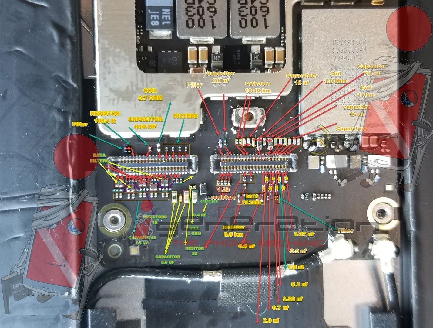

              do you know the amps value of these coils for backlight and image? because from the picture it only shows the value in ohms

                Remove all power.
                Do connect the lcd display.
                Meter in resistance mode. Measure the resistance to ground of the coil that was burnt and do measure each side of this coil to ground. This is to confirm there is no short.

                  update:
                  i changed the flexible and the image and backlight is ok except for touch...sigh.
                  checked filters and coils all are ok.
                  any suggestion?

                    Re: iPad pro A1652
                    Fault may be with the touch IC but first watch the related videos from Alex at Northridge repair on this topic.

                      update:
                      i decided to resolder the flexible and the touch is ok now.
