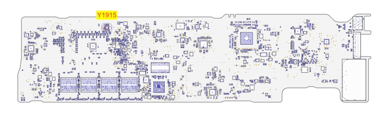

          Re: Apple MacBook Air A1466 (820-00165-A) no post
          I have found some corrosion here in pic
          measured resistance on R1915 R1916 0.99Mohm C1915 C1916 no short

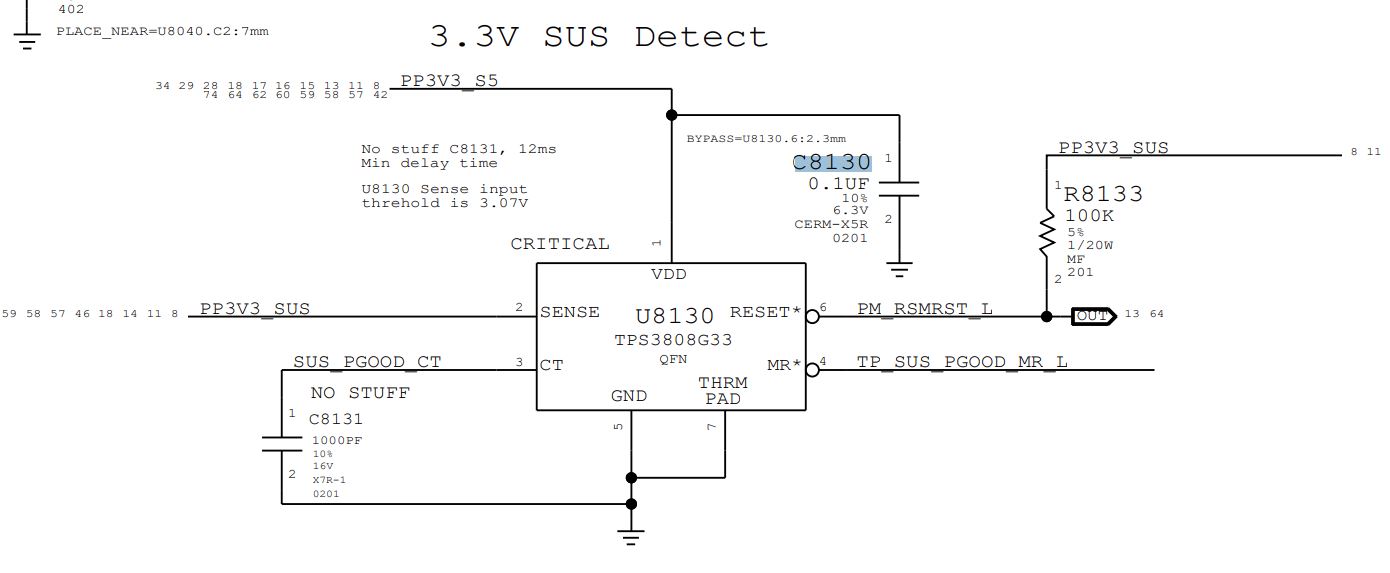

                  Thanks this was a great idea
                  found out in the corrosion area that PM_RSMRST_L is low
                  while on U8130 pin1 PP3V3_S5 is high 3.3
                  resistance on R8133 is 38K should be 100k.
                  what do you think is the next step ?
                  • reformatt
                    • Feb 2020
                    • 1451
                    Remove the IC and check all connections to it. PLT_RESET_L should be pulled high by R8133, and only pulled low by U8130. This is either after a preset delay, or when PP3V3_SUS is missing on pin 2. Also check resistance of pin 6 to ground.
                    • koby058
                      • Jan 2017
                      • 387
                      • israel
                      Hi
                      Since i can only remove the chip in the morning, i have measured what you have asked today. but then i have measured also pin 3 of U8130 and the minute i have touched it with the probe the fan start spinning and i see the mac boots.
                      also i have found out that C8131 is totally missing from the board.
                      but it is present in the board view.
                      Is it better if i just install a new 1000pf cap ?
                      • reformatt
                        • Feb 2020
                        • 1451
                        C8131 is NO STUFF and not fitted.
                        • koby058
                          • Jan 2017
                          • 387
                          • israel
                          OK, so for today i have found out that PP3V3_SUS is present on pin 2
                          and 330Kohm on pin 6, tomorrow i will remove the chip and test again
