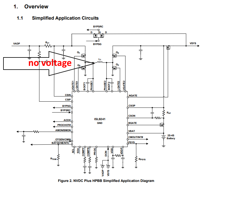

    I found traces of liquid.
    RT8249CGQW (2N = **) and SY8288RAC (AWS **) faulty.
    Fix the traces of liquid and replaced the regulators, now it turns on perfectly both on battery and with power supply (usb-c) but does not charge the battery.
    The charger is Intersil 9241H.
    Unfortunately there is no motherboard diagram and I cannot find examples of connections with this charger. Can anyone suggest me a schematic motherboard with this charger?

    https://www.badcaps.net/forum/showth...ighlight=9241H
    EDIT: Its in this schematic https://www.badcaps.net/forum/showthread.php?p=1174688

      thank you so much
      i found a resistor wrong value
