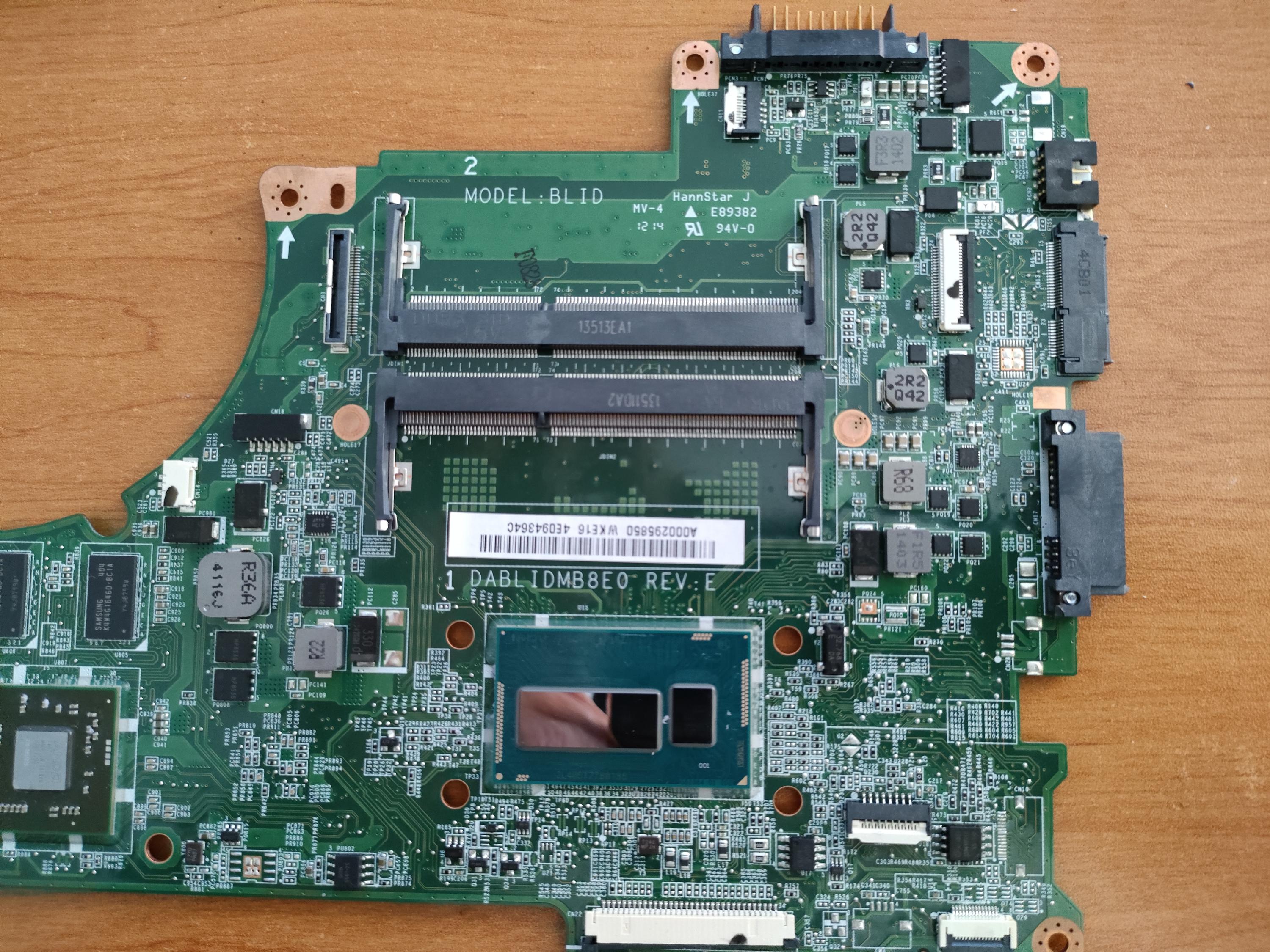

    This laptop has a too long history already. I bought it working but with the hinges broken. When I was trying to fix it, pulled the motherboard out and when I was assembling it again, like many people, I plugged the speaker cable in the wrong connector (white one near the ram slots) and killed the CPU.
    I then replaced the CPU i7-4500U with a i7-4510U. Cleaned ME and it was working again fine, or so I thought until I installed windows and saw that it was not completely true.
    The issue is, when I shut it down, it shuts down normally and if it has the battery or the power adapter or both are attached, it powers itself on again after around 3s. The power button it working fine.
    It only stays off if no battery is connected and I pull the power cord right after it shuts down. Then I can plug the power back and it stays off.
    The only thing I can think of is some power signal is telling it to turn on again. Could it be that the i7-4500u and i7-4510u have some different power signal pins?
    I have another board with the same reference (DABLIDMB8E0 REV:E) but with a 5th generation i5-5200U and around the CPU there are 2 or 3 resistors set in a different configuration
    In bios configuration I don't see any enabled option that could cause this behavior.

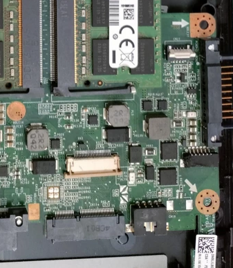

          Board pictures:
          https://imgur.com/gallery/SXXAlUf

            Focus on the attached area of the PCB -> your battery connector is visible and so are the HIGH and LOW side mosfets that are used to charge the battery.
            Respectively, the PCB designer will house the charger IC in this area as well. Look around and share closer pictures. The charger IC should be nearby and also the battery mosfet.
            Post the TOPSIDE markings of each such mosfet (black / square looking parts). We can then determine if they are N-channel or P-channel (most likely will be N-channel).
            So far, unable to find a similar looking PCB / schematic but for now, it does not matter.

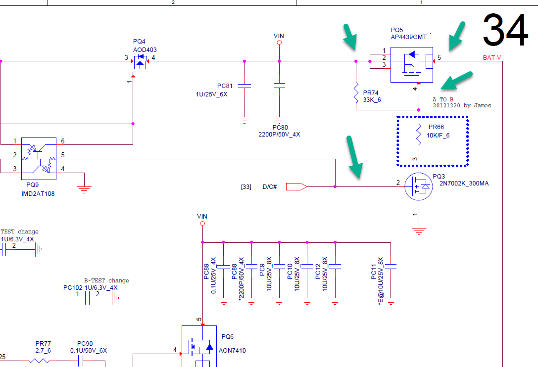

              Ok - just received your schematic. Thanks.
              Attached for future readers.
              See attached mosfet area - interested in the voltage at pin # 2 (gate) of PQ3.
              PQ3 will be a small 3 pin part (perhaps SOT23 or SC-70 package). You can post close up pics so we can verify.
              This gate voltage will decide if the battery mosfet @ PQ5 is ON / OFF to power the logic board. If this part of the circuit is working then PQ5 needs to be reviewed to see if it is defective.
              You can check if it is defective by removing all power / no battery and then checking the resistance across PQ5 pins.
              source (1-2-3) & drain (5-6-7-8)
              source (1-2-3) & gate (4)
              gate (4) & drain (5-6-7-8)
              Low resistance = defective mosfet
              PQ5 = battery mosfet.

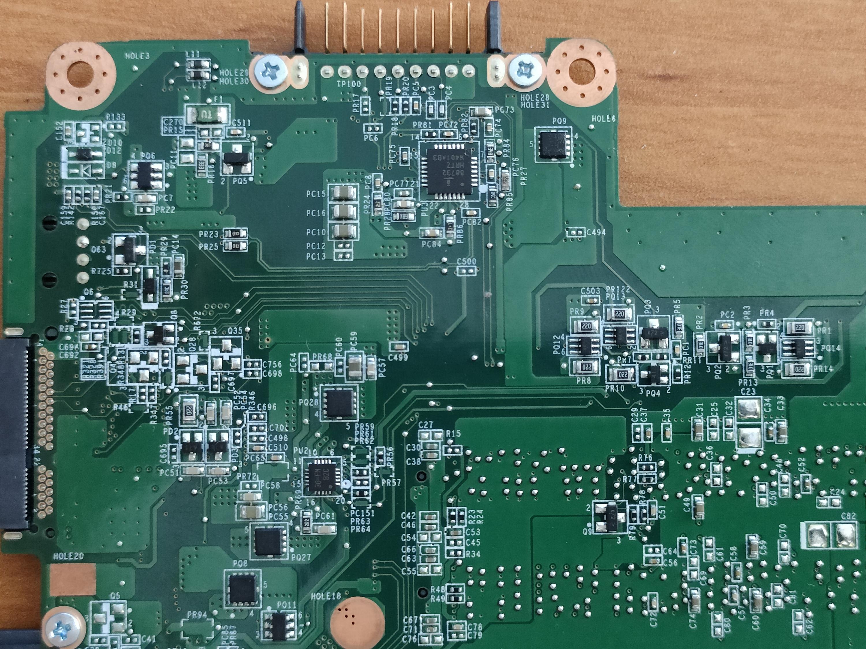

                Sorry for taking so long.
                I think the markings on the board are different from that schematic.
                The components do not match what I see in the board labeled PQ3, PQ5 or PQ9.

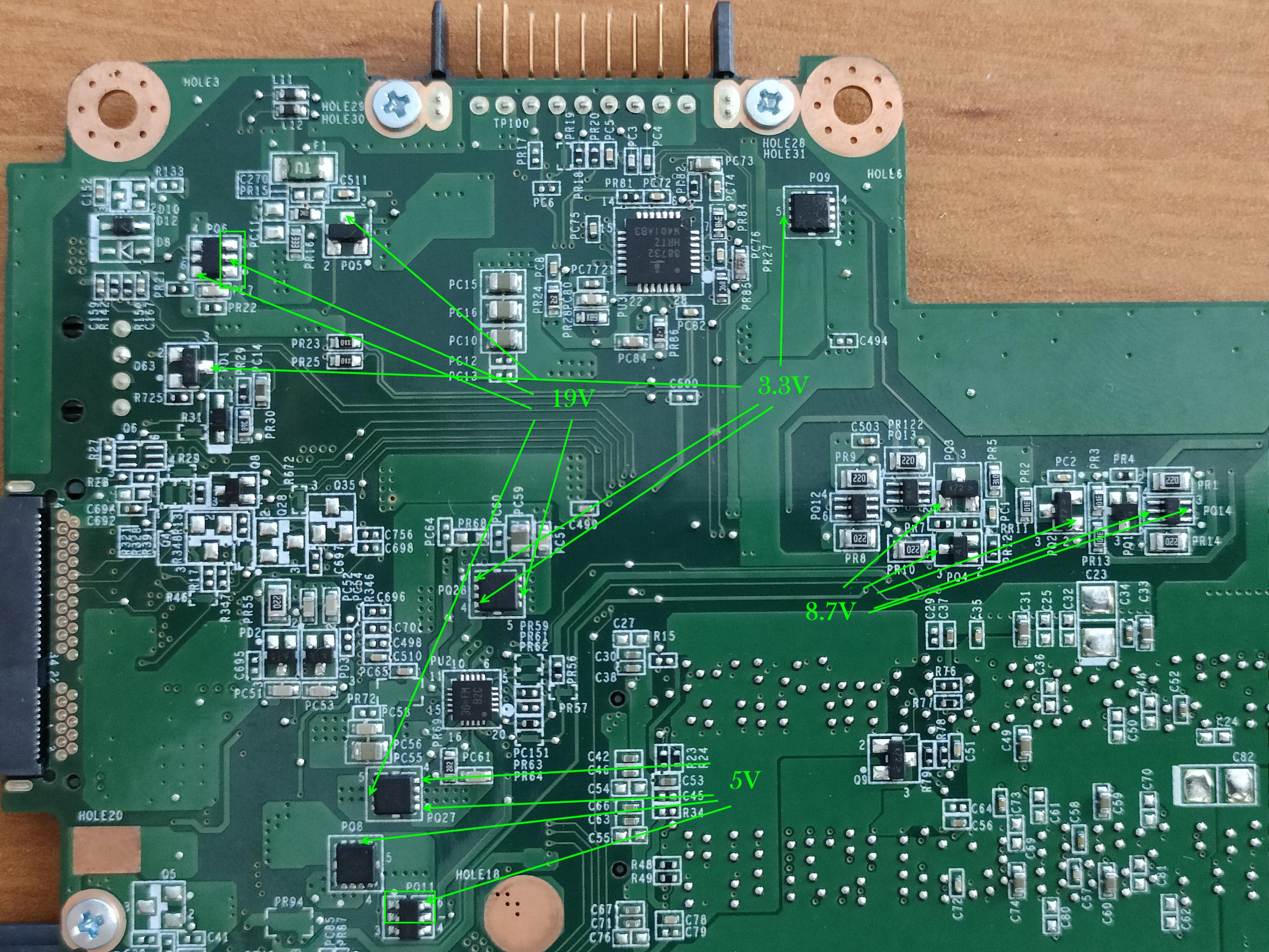

                edit: Should I measure with the laptop on or off? I ask this, because If I power off and remove all power sources and then connect them back, it stays off. If I power it on and leave them on, it powers up again by itself.
                I'll measure some voltages around with it powered off, just the power adapter connected and post new pictures with some measurements.

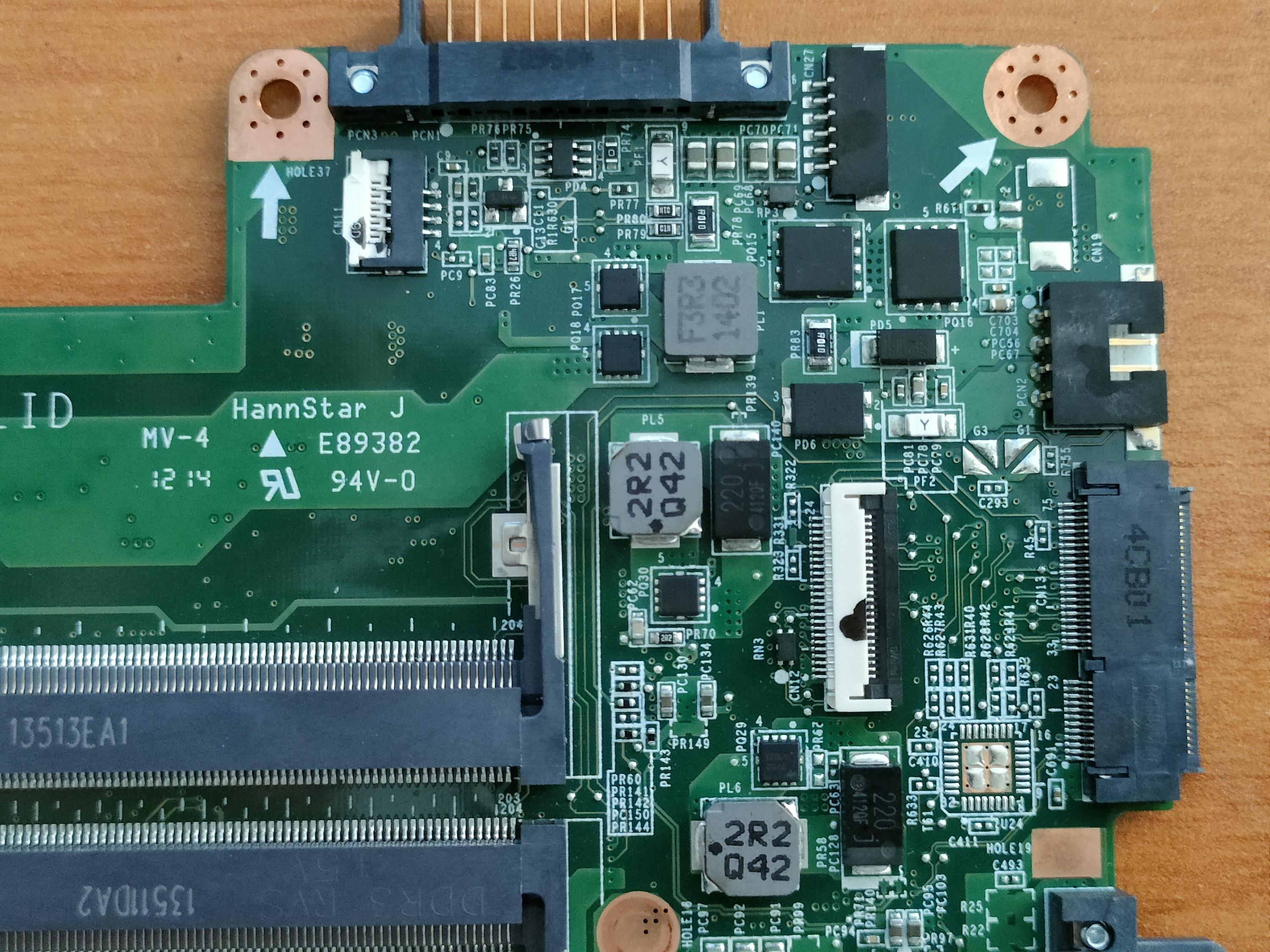

                Hope you can guide me better with these closeups
                edit2: here are the measures with just the power adapter connected and laptop powered off.
                thank you
