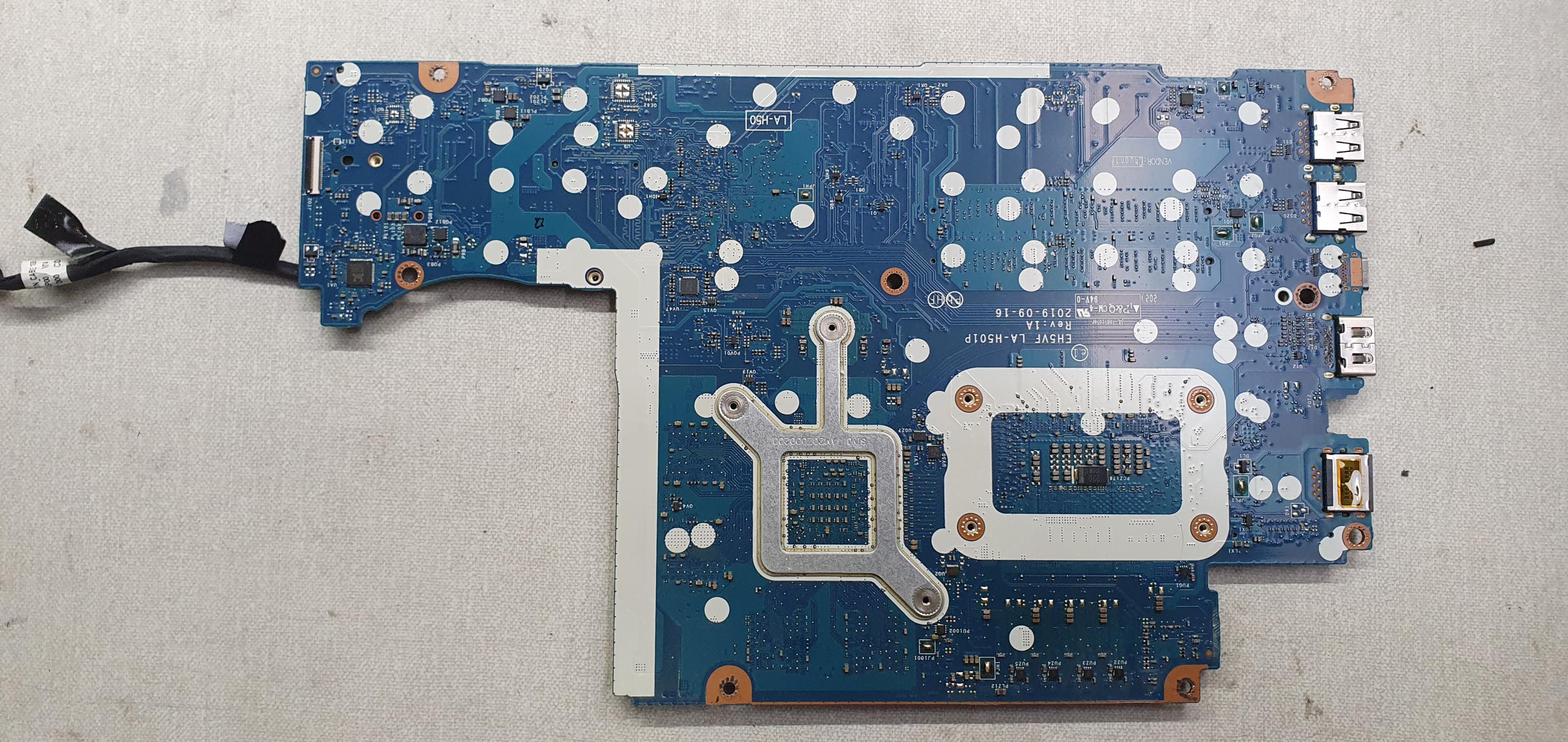

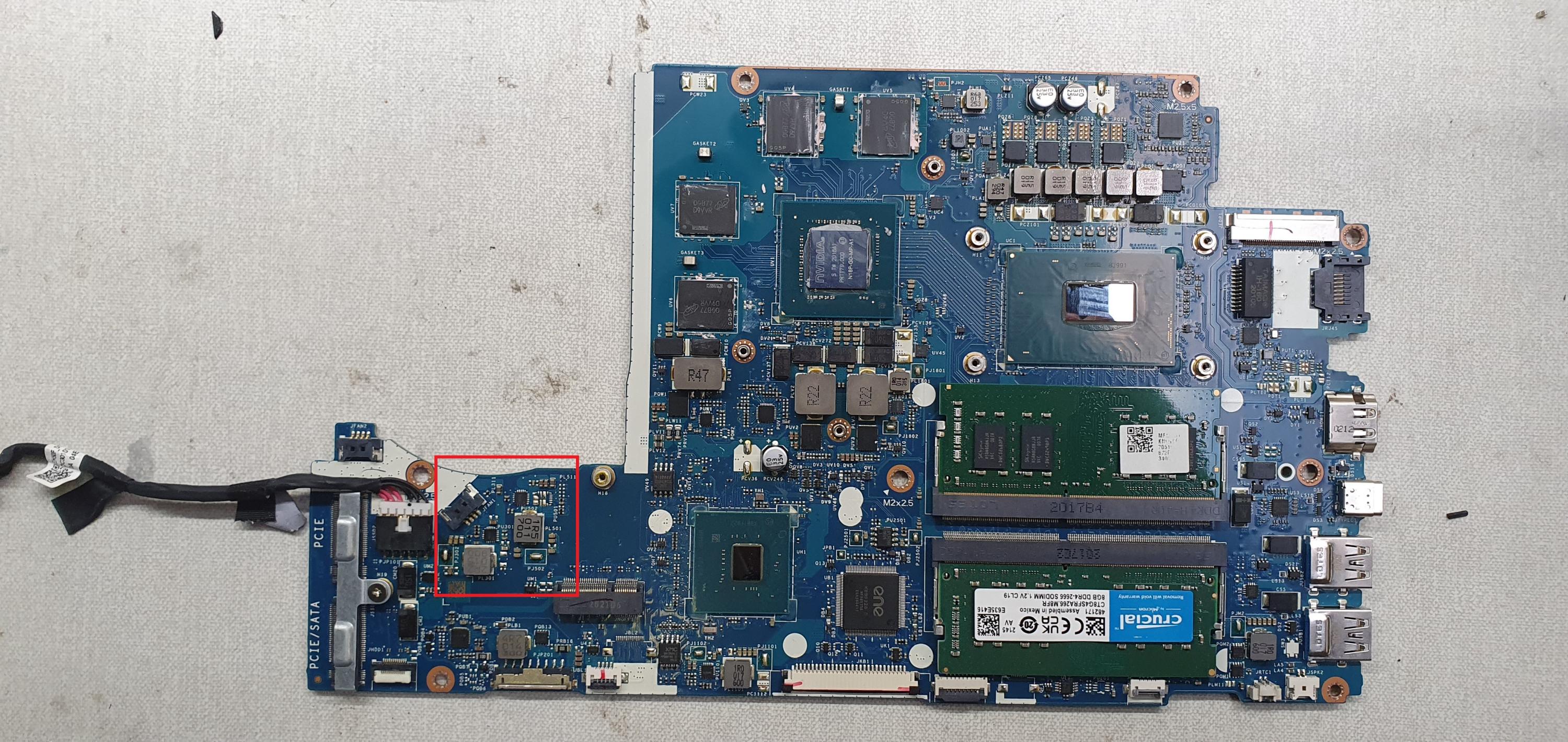

    I can use some help figuring out where the problem is. I do not have any schematics.
    I do have 19V on the first 2 mosfets but I don't have 3.3V on the BIOS chip.
    It seems that I don't have voltage on the (marked in red) 5V and 3.3V power supply, at least I think it must be there.
    I have attached images of the motherboard.
    What should I measure now to figure out what isn't working?

          Re: Acer NITRO 5 AN515-54-52UH Not booting

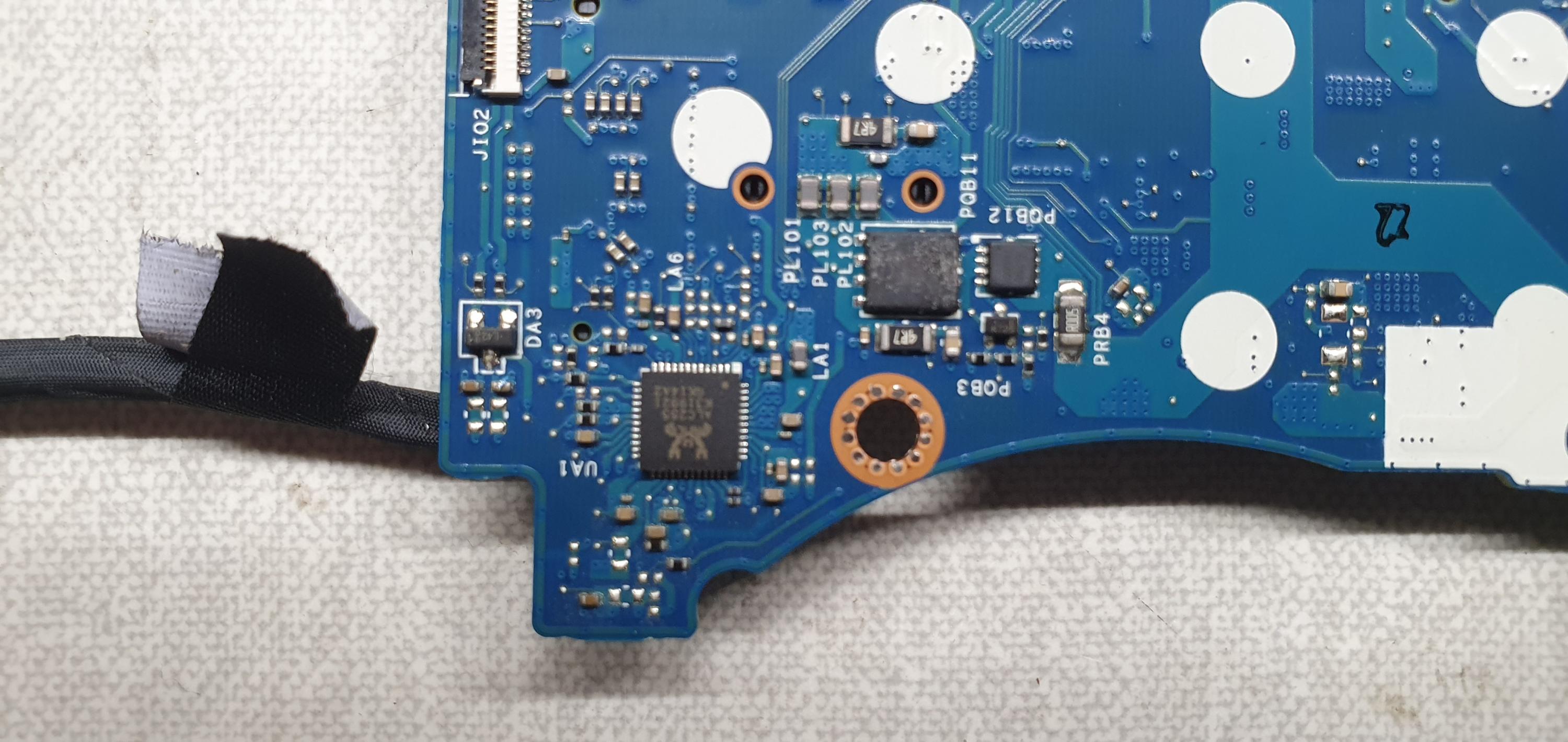

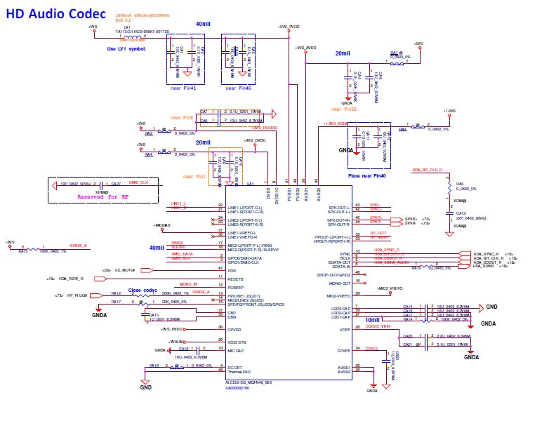

          I noticed that some capacitors were shorted as marked in red so I desoldered these. After the caps were desoldered there still was a short so I soldered them back on (although not that clean but I fix that later)
          After further searching I noticed some of the caps around a chip were shorted as well. The UA1 which appearantly is the HD Audio Codec.
          How likely is it that this is the issue?

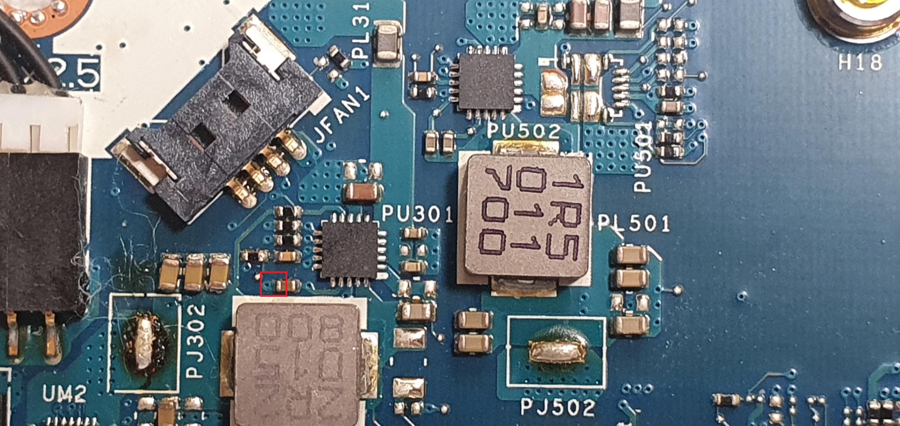

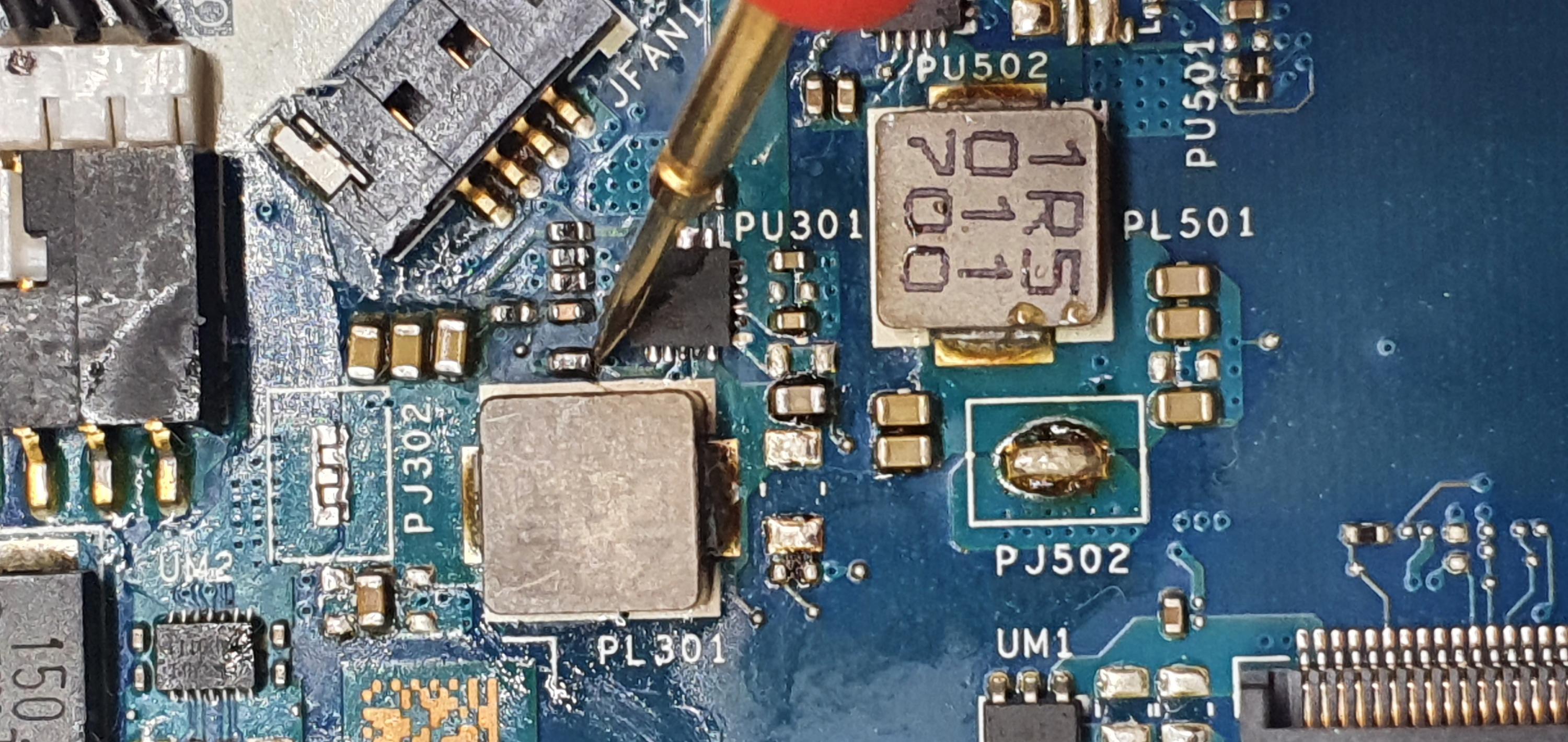

                  I dont understand. On the schematics I count 49 pins. To verify, it's the IC in the image right?
                  I have marked the pin that needs to be measured with an arrow. Is that the pin we are talking about?
                    In post # 6 -> the test is of the 3 volt rail on PU301 (not the audio HD codec IC).
                    PU301 = 20 pin QFN device.
                    Share a picture of the 20 pin QFN device for a verification.

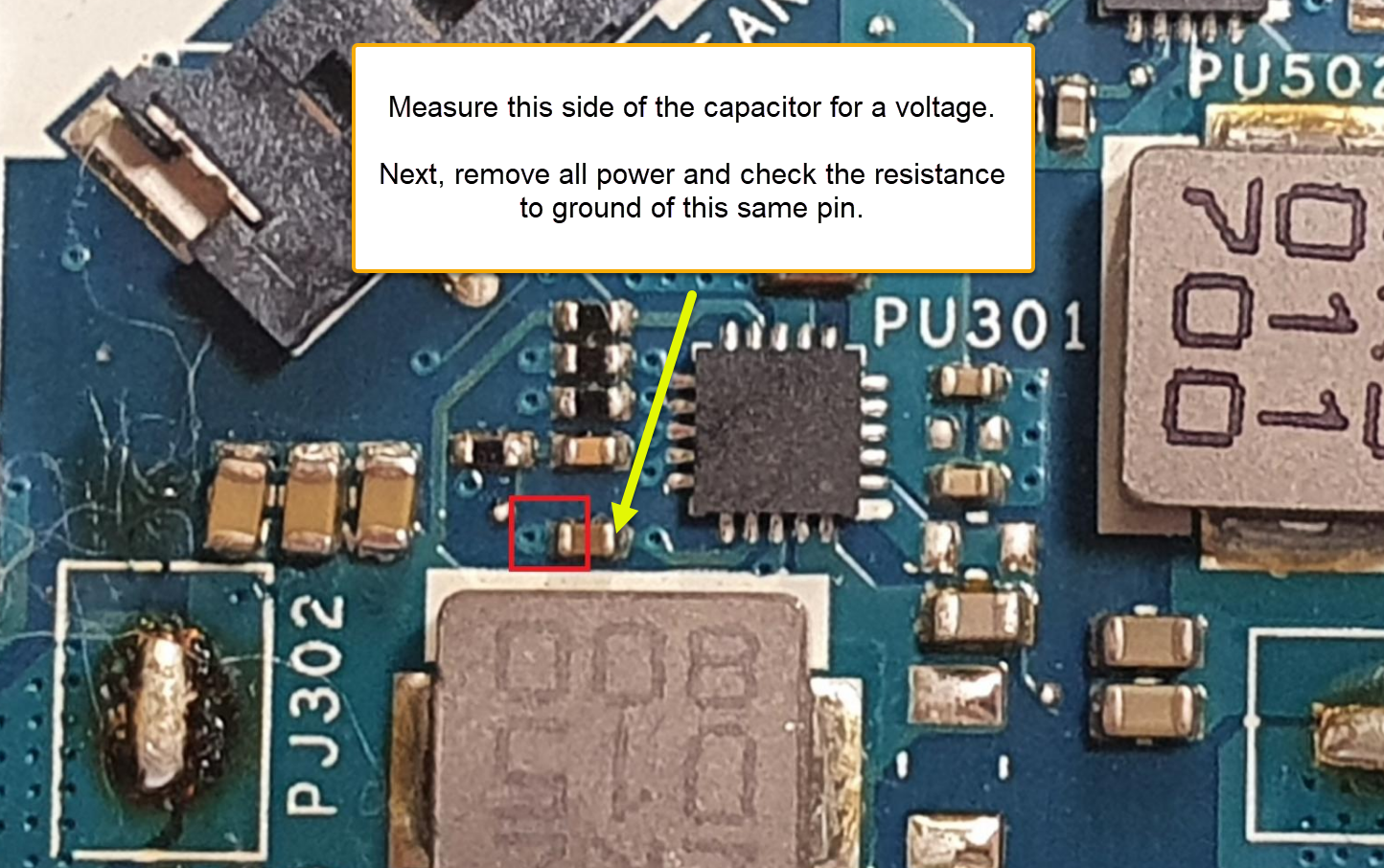

                      That makes sense. I have measured right after the cap behind the pin which I have marked with a red square.
                      There was no voltage and the resistance was 0.1 OHm
                        Yes, this is the IC of interest (PU301).
                        The capacitor pin that has been measured for the voltage is very likely the GROUND pin so it will be 0 volts and the resistance also sounds correct.
                        Be sure that when you measure resistance - REMOVE ALL POWER - then meter in resistance mode to take your measurements.
                        Can you proceed to check the voltage on the other side of this same capacitor?
                        After this voltage check -> remove all power -> meter in resistance mode.
                        Check the resistance to ground of this other capacitor pin. Checking to see if there is a possible short on the other pin of this capacitor.
                        PS: Nice picture. Is this through a microscope or a standard phone camera? Which one do you have?

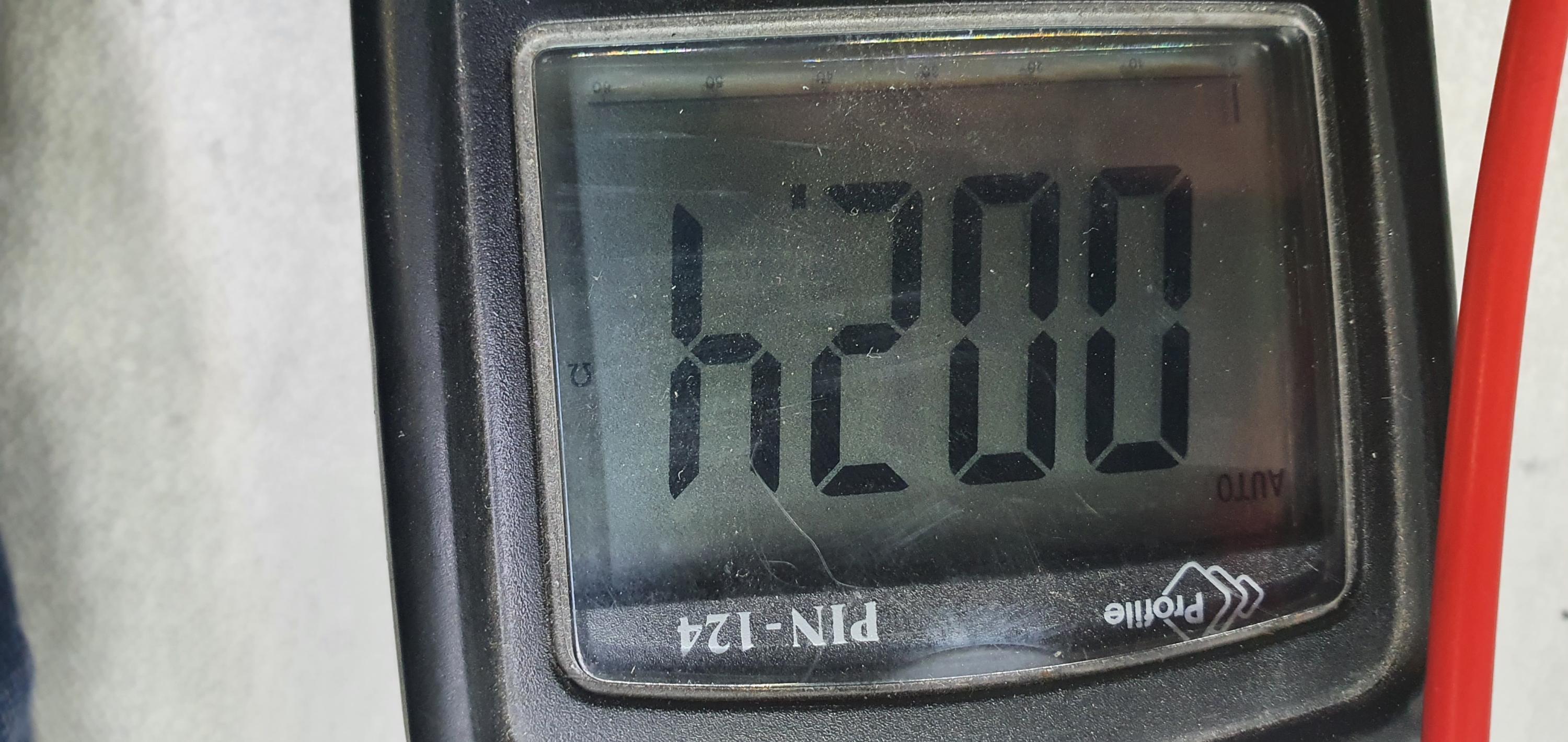

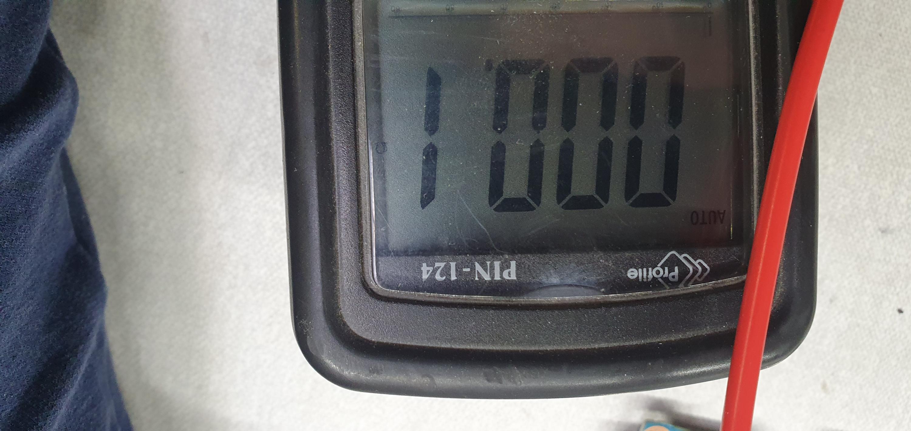

                                  It's an automatic range detector but I put it on manual now and got the exact same readings.
                                  This is measured on the cap from both sides. The one with the highest resistance is the side where the chip is.
                                  Both the IC and the cap is soldered on now. I have measured shortage on the cap itself when it was detached from the motherboard but there was no short.

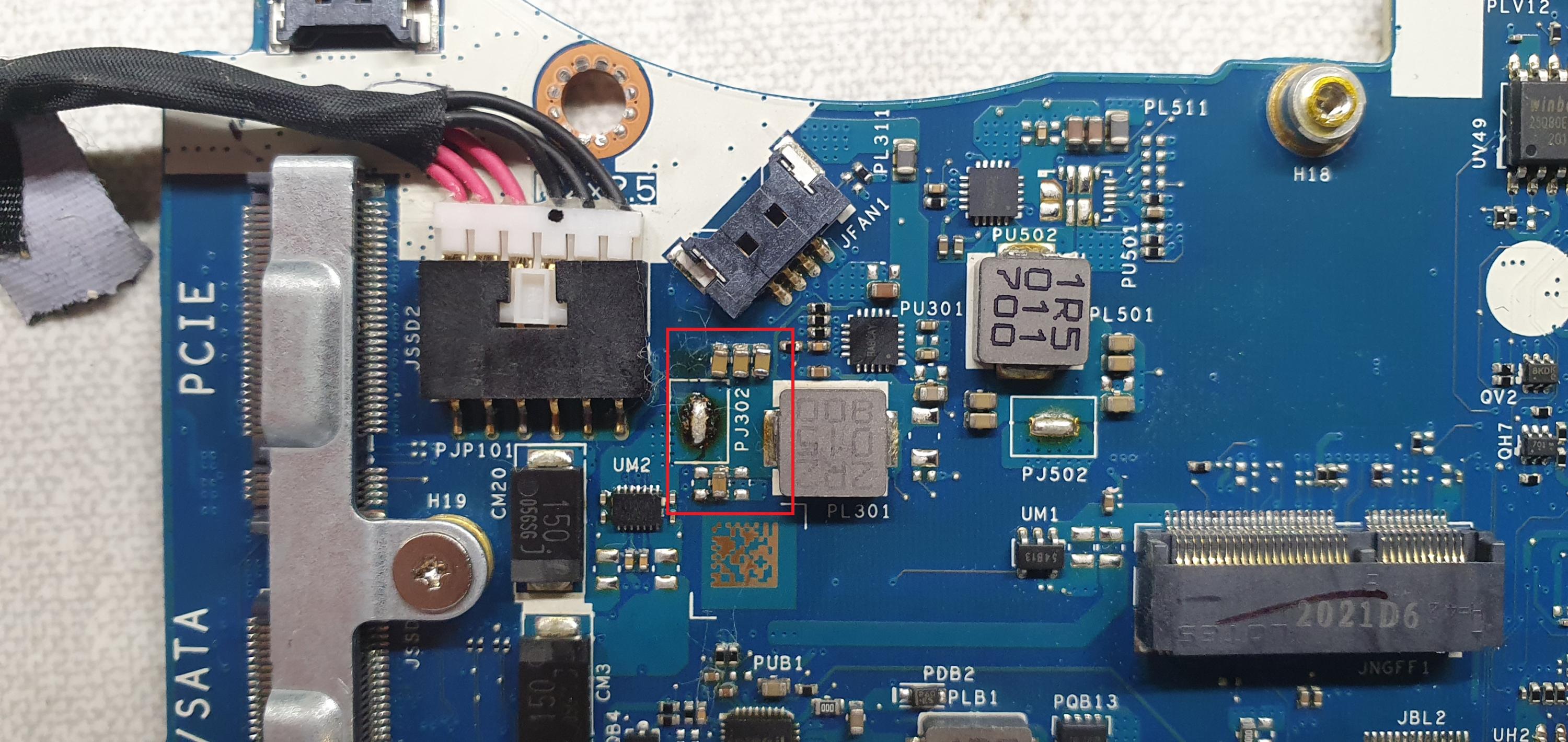

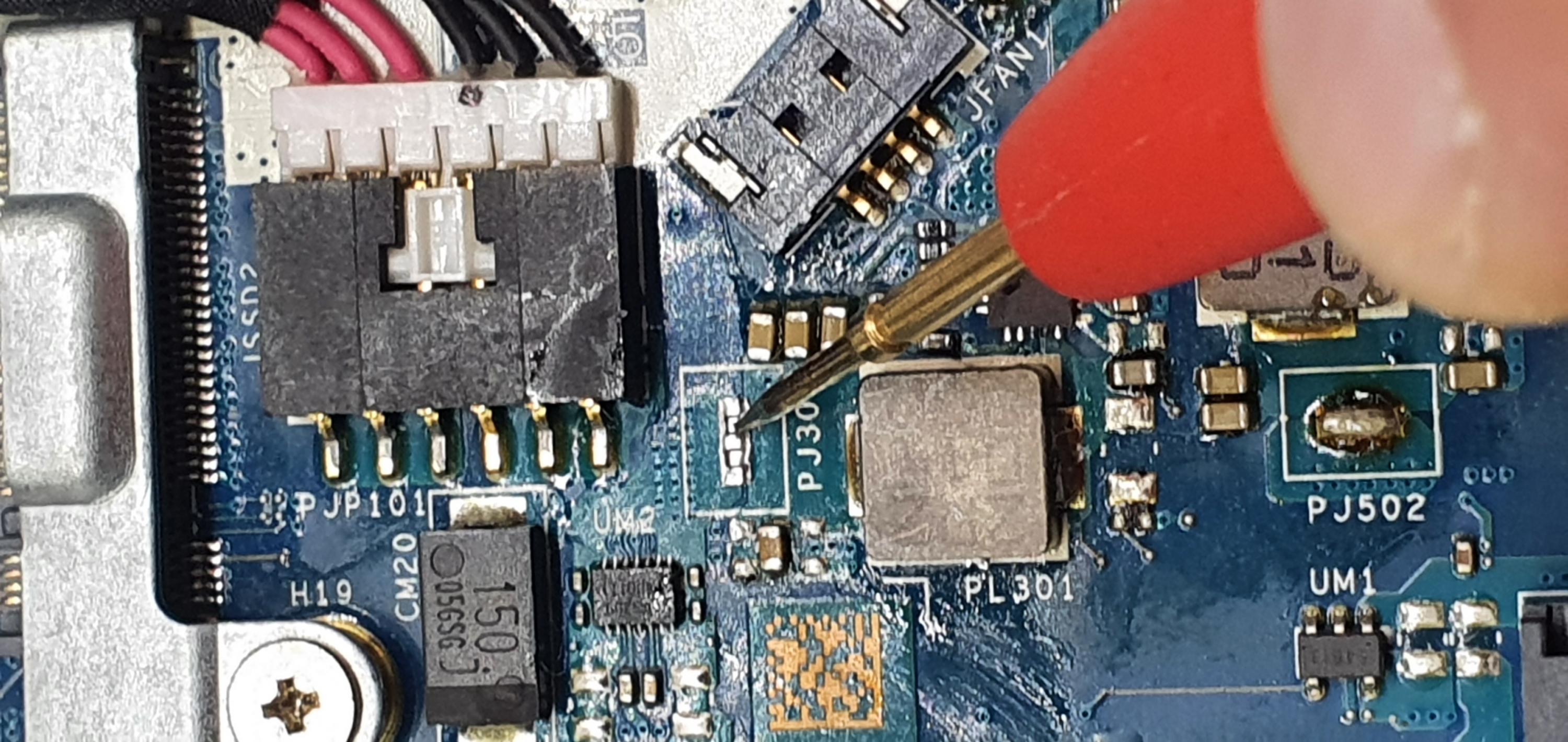

                                      The readings are good but with a 2R4 (2.4 ohms) value, there is a short.
                                      See the solder blob inside the white rectangle nearby at PJ302. Remove this solder blob to isolate the main LDO rail producer from the load (consumer side). This PJ302 is acting like a short circuit to pass the voltage downstream.
                                      Then check the resistance to ground again of this capacitor.
                                        I have desoldered the blob but the resistance stays the same. The short is still there.
                                        At the chip side of the blob there is no short.
                                        This does indicate that the IC is shorted right?
