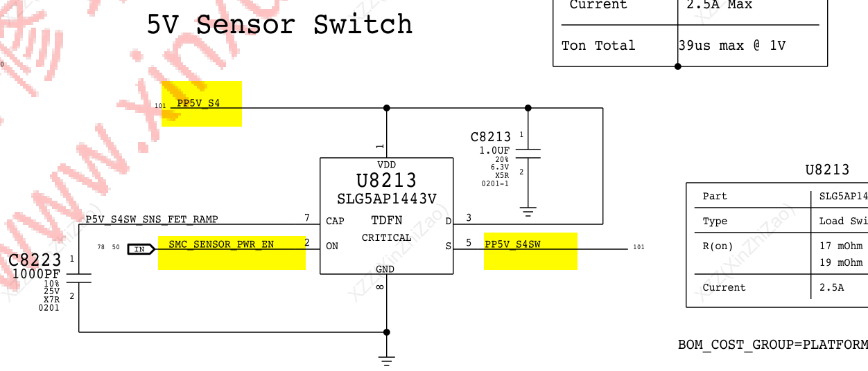

                            • mon2
                              • Dec 2019
                              • 14672
                              PP5V_S4SW (5V) - 0V
                              PP5V_S4SW_ISNS (5V) - 0V
                              Double-check this one.
                              Inspect U8213. Measure the voltage to ground of each of the pins that are highlighted. This load switch may be defective. Also be sure that there is not an excessive load (short) to ground of the PP5V_S4SW power rail. An excessive load / short will kill this load switch.
                              • Mateusz200
                                • Apr 2024
                                • 9
                                • Polska
                                There is no U8213 on my board, no u5700 aswell with all components around. Its like this board doesnt have them originally.
