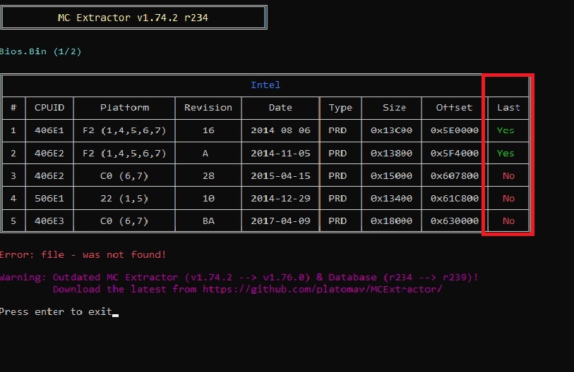

    I have a Lenovo IdeaPad 110-15ISK M.B LA-D562P REV: 1
    The primary problem is shorted RTC section with no power.
    After replacing soc (i3-6300U) with i5-6300U (SR2EY) CPUID 406E3
    Now RTC is OK and m.b is power on OK for a few seconds and then shutdown, I need to know if this MB supports this CPU or not
    latest bios ver
    i need to know what is this column
    thanks for help

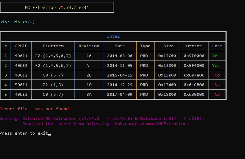

    What is the CPU ID for i3-6300U?? As long as bios has listed CPU ID 406E3, it should work. You need to write clean me bios after SOC replacement. Are you sure you didnt damaged any pads while removing the original SOC as lenovo has strong black glue under it??

      i replaced bios with new bios from lenovo website
      i3-6300u CPU ID 406E3
      there are a few NC pads was damaged while removing

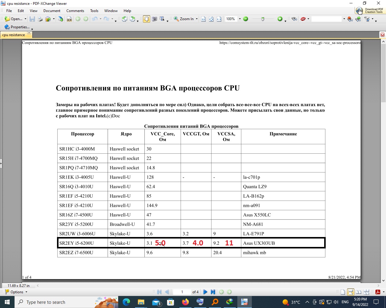

      CPU Coils resistance

        Since both the SOC has same cpu id, there is no question of non compatibilty on this platform.
        Either new SOC is bad/Not properly soldered/damaged pads under SOC.
        To be honest, i've stopped replacing SOC on Lenovo's as i tried on 3 mobo's without success as some pads invariably gets damaged while de-soldering or cleaning. May be, your skill set is higher.However, i successfully replaced SOC on may HP's/Dell's etc.

          Are there other requirements other than cpuid to choose the alternative SOC ?
          • mcplslg123
            • Jun 2015
            • 7262
            • india
            Re: Lenovo IdeaPad 110-15ISK CPU upgrade
            Technically, any cpu should work as long as cpuid is listed in bios.Some SOC's have bootguard locked and they wont work on another board unless the bootguard is removed As per some russian forums. However, i dont know how to remove bootguard.
