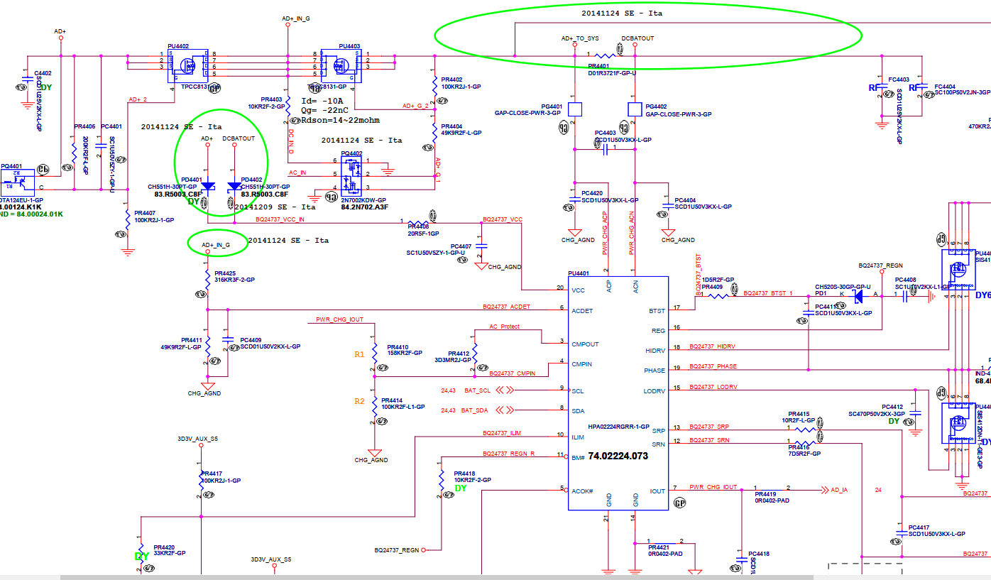

    HP Envy X360 Laduree 1.0 MB 14257-2 turns on and off
    HP Envy X360
    Motherboard:Laduree 1.0 MB 14257-2
    CPU:SR23W i7-5500U
    KBC:ENE KB9028Q C
    At first, the board was dead no lights nothing after connecting the charger.
    After visual inspection, I noticed damaged components in the charging circuit:
    PR4408, PR4415, PR4416, PU4406
    I replaced them (including high side and low side MOSFETs PU4406 and PU4405).
    Later on the 20th leg of the charger, I still had low resistance, so I replaced the charger chip
    After replacing the charger chip I have a white led when I plug the charger.
    At this moment laptop behave like this:
    After I press the power button the light on the power button blink white for a second a fan twitch for a little
    After further measurements, I've noticed no voltage 3.3v and 5v on coils PL4501,PL4502
    Here are my measurements:
    Resistance on coils :
    PL4501 - Resistance in mega Ω
    PL4502 - Resistance in mega Ω
    PL4901 - 660k Ω
    PL1 - Resistance in mega Ω
    PL4701 - 62.9 Ω
    PL4801 - 233k Ω
    PL8201 - 21 Ω
    PU4503
    Pin 3 (VREG3) - 3.29v
    Pin 6 (EN2) - 0v
    Pin 12 (VIN) - 19.5v
    Pin 13 (VREG5) - 5v
    Pin 20 (EN1) - 0v
    Resistance:
    Pin 6 (EN2) - 12k Ω
    Pin 20 (EN1) - 12k Ω
    U2401
    Pin 67 (AVCC) - 3.29v
    Pin 91 (5V_S5_EN) - 0v
    Pin 101 (3V_S5_EN) - 0v
    Pin 103 (RSMRST#) - 0v
    Pin 110 (ACIN#) - 0v
    Pin 111 (VCC) - 3.29v
    Looks like KBC doesn't issue a turn-on signal for 3v/5v driver chip.
    I've tried to reprogram Bios and KBC chip with a dump from HP update and still, nothing changed, then I replaced KBC with a new one and programmed it with a dump from HP update and still nothing.
    I'm out of ideas right now.
    Thank you for any help and ideas on what I should do next.

            What is the voltage of ACDRV pin on the charger IC?
            Check the voltage on the gate pin #4 of the 2x DCin mosfets.
            Post all measurements.
            • TTR
              • Apr 2020
              • 24
              • Poland
              Re: HP Envy X360 Laduree 1.0 MB 14257-2 turns on and off
              Can't find ACDRV pin on my charger IC.
              I'll attach a part of schematic with my charging ic.
              On the gate of PU4402 and PU4403 I have 6.5V
