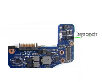

    Hi ,
    After polaritie reverse of the power supply my laptop works only without battery (motherboard QAL81 LA-7782P) , can you help me to solve this problem.

    Re: Dell Latitude e6430 problem inversion of polarities
    You will have to review the 2*DCin mosfets.
    Remove all power. Meter in resistance.
    Check the resistance of the mosfet pins:
    Source and drain
    Source and gate
    Gate and drain
    Post each measurement. Repeat for the next mosfet.
      Thanks for replying.
      do you mean these two ones near dc input in picture
        It is a good start. What are the markings on these 8 pin mosfets?
          4423 / 4435 and i think the second one short (all drain - source - gate make bips on multimeter)
            Good. If you have a good replacement for this mosfet, replace it and test again.
              Thanks a lot i found mosfet 4435bz by chance and everything works like a charm ,my laptop detect the battery now .
