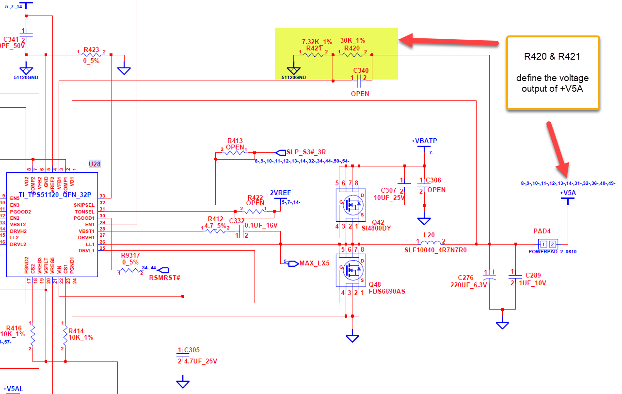

    Remove all power -> meter in resistance mode -> check the resistance to ground @ L20.
    One meter probe @ L20 (either side is ok) -> other meter probe to ground.
    Someone is consuming too much current and causing this regulator to heat up.
    It is possible that U28 is now defective but start with the resistance check.
    Also check the other half of this regulator by checking the resistance to ground @ L21.
    Post the readings.

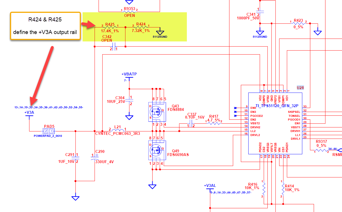

                  The voltage output of each of the buck regulators inside U28 are defined by the FB pins (feedback pins). Respectively, each resistor on the FBx pin must match the values shown in the schematic.
                  To confirm, remove all power / no battery -> meter in resistance mode.
                  Check the resistance of each of the resistors on the FB1 pin. Then repeat for the FB2 pin. Be sure that each resistor matches the schematic values.
                  • vettouch

                    @mon2. I can't locate R425, R424 resistors. I feel they are not labeled. Please, how can I locate them?
                    • mon2
                      • Dec 2019
                      • 14679
                      Re: HP Compaq 6510B inventec Rev 1.0 - U28 IC GETTING HOT

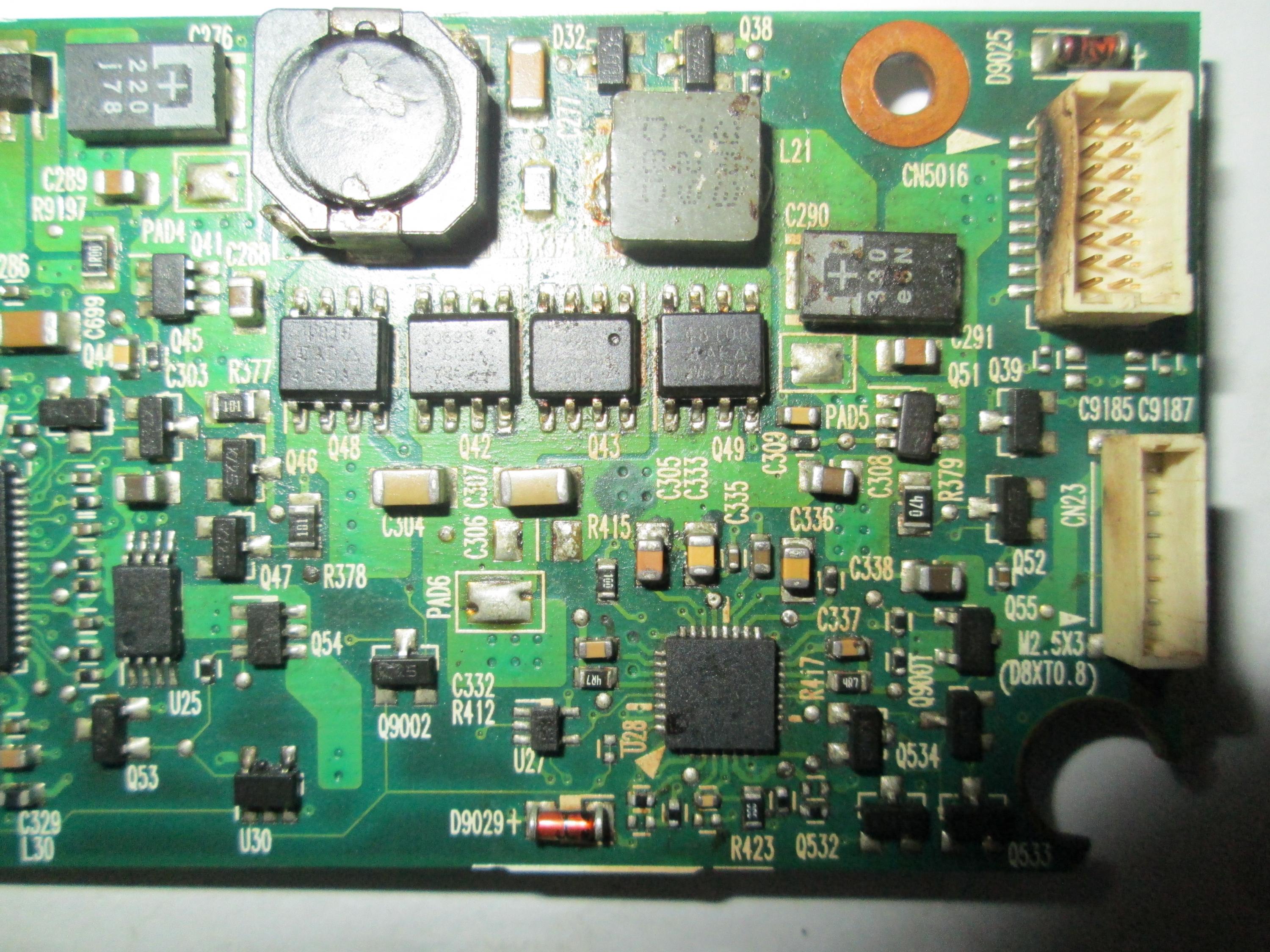

                      Locate pin #1 of the ic -> then find pin #6 on the device.
                      This the the feedback pin for this voltage rail.
                      With no power, meter in resistance mode, one meter probe on pin #6. Other meter probe to a close by resistor. When you find a resistor with 0 ohms, that will be the feedback resistor circuit.
                      Post close and clear pics of the area on your logic board.

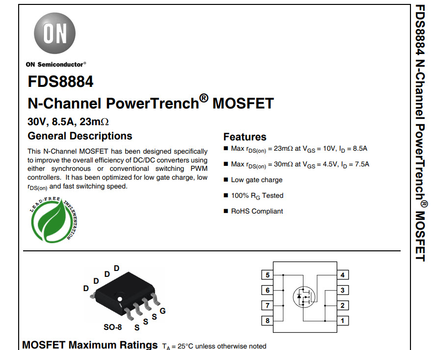

                        @ mon2. While diagnosing this board yesterday, I suddenly discovered a burn on Q43. So, I found a replacement for it. After that, I also discovered shorts on Q49, C290, C291, and C336. What have I done wrong? See the attached picture of the board.
                        • mon2
                          • Dec 2019
                          • 14679
                          What was the part # on the original Q43 ?
                          What part # was used to replace the burnt Q43 ?
                          With no power, what is the resistance to ground of the parts you are observing to be shorted ? Select the lowest resistance scale on your meter for these measurements. Post the readings.
                          • vettouch
                            • Sep 2020
                            • 68
                            • Nigeria
                            original part # for Q43 = FDS8884
                            replaced it with same part # from another board
                            resistance to ground for parts observed to be shorting
                            metre @ 200 ohms
                            Q49 = 16.2
                            C290 = 16.9
                            C291 = 16.7
                            Q51 = 16.5
                            C336 = 17.9
                            C308 = 38.9
