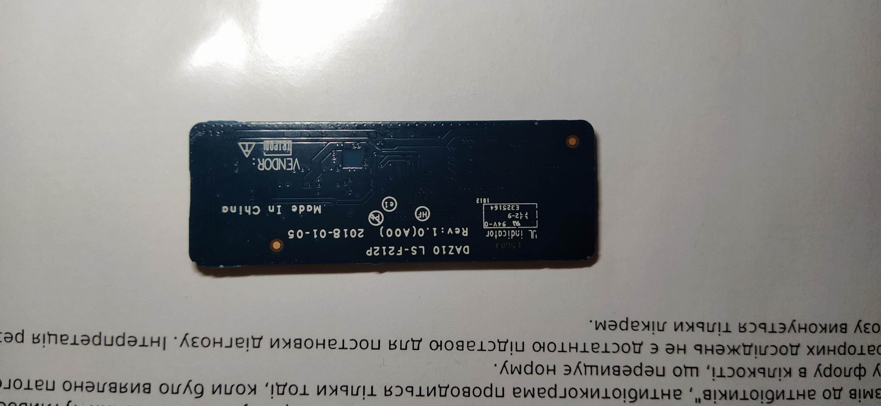

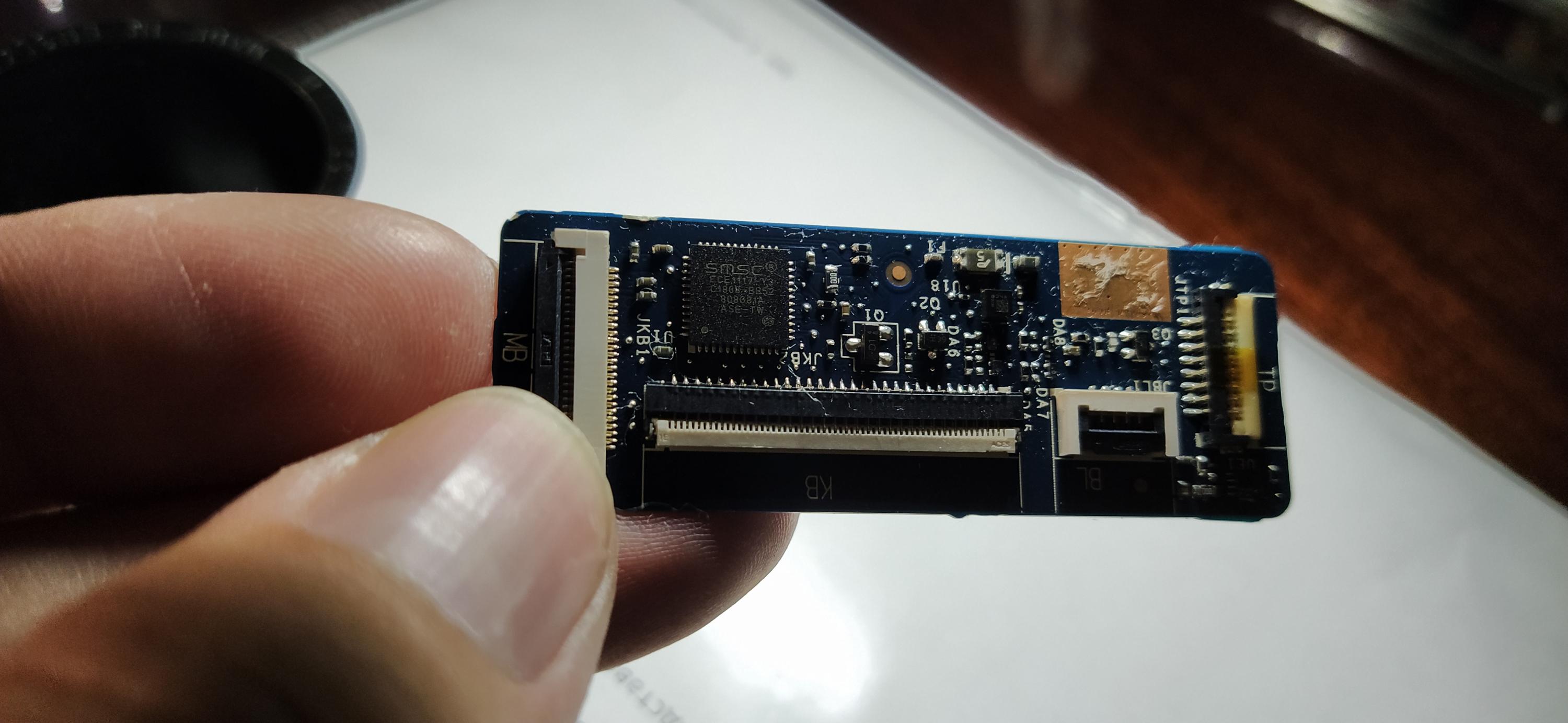

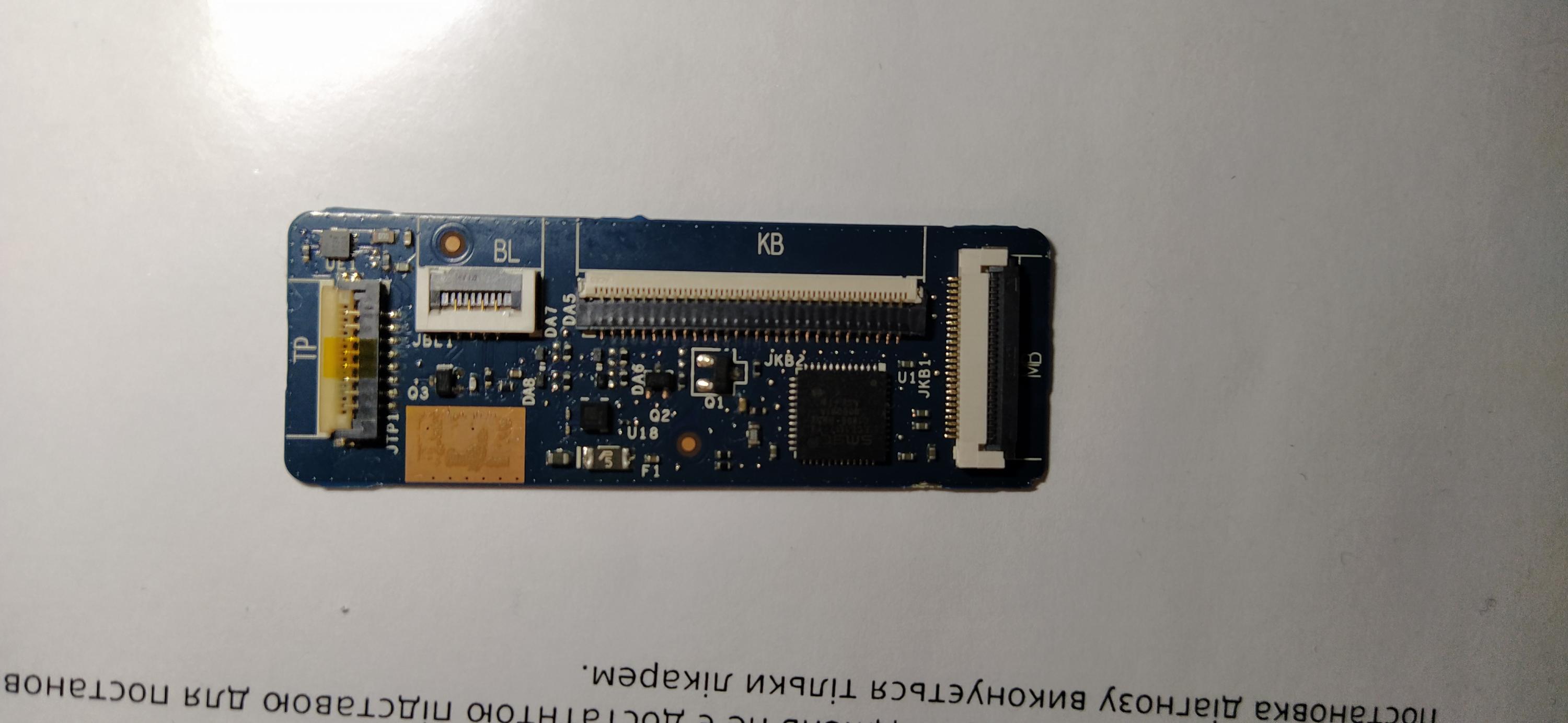

    MODEL NAME AZ10
    PCB NO :LA-F211P
    After bumped battery removal the keyboard doesn’t work properly. When pressing any key, it will react 5-7 times after 5-15 seconds.
    The keyboard connected to KBC board. The cables are fine, all signals are checked

    Dell XPS 15-9575 2-in-1
    Schematic: https://www.badcaps.net/forum/showthread.php?t=106363
    The problem comes from kbc board. That board is connected to EC through I2C interface. Will analyse data packages. My theory is based on EC as master sends command to read KBC ECE1117 buffer, but the buffer is empty or stuck with keycode.
    In different laptops I have saw the internal iospace ram buffer with keycode, and keycode always remain the last status. So if ECE1117 has a failure, then it will not fill a buffer, it will not reset a buffer

        I2C data and clock present. Have captured traffic, will analyze for difference between keypress “1” and key “2”
        KBC_Det is gnd connected
        KBC_Int is pull up 3.3v, but goes to 0v when key pressed
