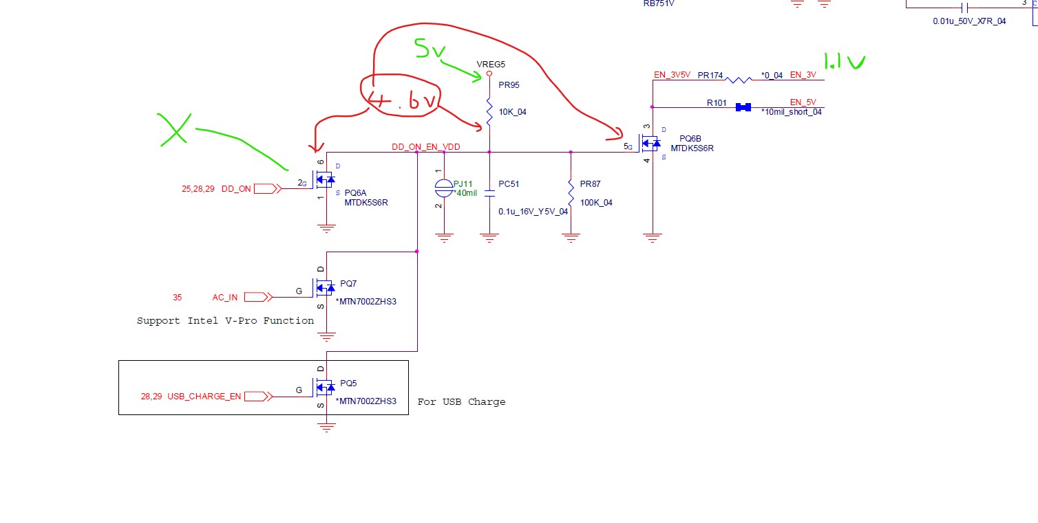

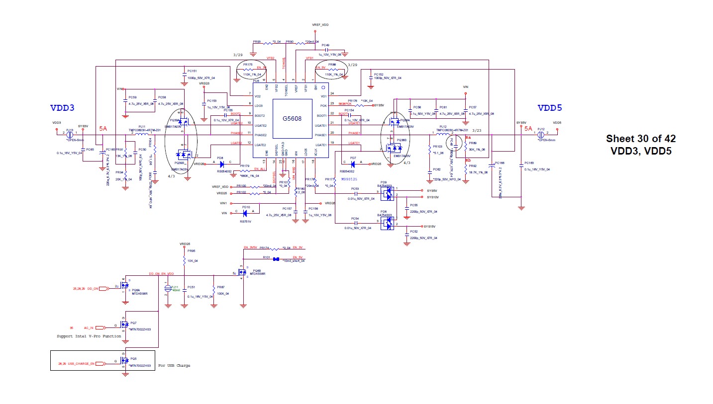

    I have no power board(w540eu). no 3v 5v presents.. checked ic pins. EN pin only show about 1v.. according to schematic, I guess EN not generate by io chip. I attach pdf files and voltages presents.
    see the image plz.
    no voltages on the gate 1 of the mosfet(DD_ON signal) is that the problem.??

    Does SIO releases DD_ON??
      No it does not.. does SIO need VDD 3 to work..??
