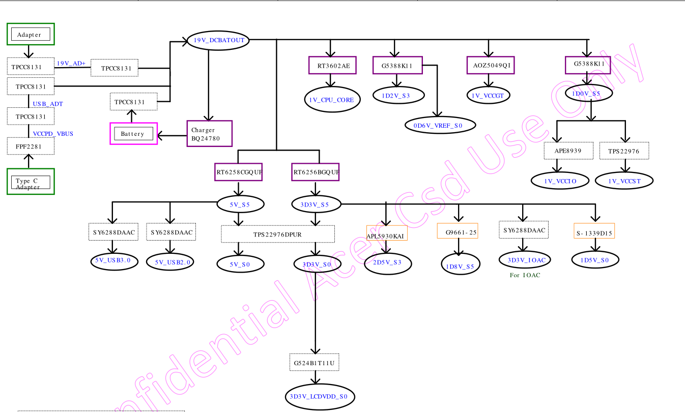

    COILS
    PWR_5V PL4502 O.L
    PWR_3D3V PL4501 O.L
    PWR_CHG_PH/BT+_R PL4401 O.L
    PWR_VCCGT PL4801 9.3
    PWR_VCORE/1V_CPU_CORE PL4702 5.74
    PWR_VCORE/1V_CPU_CORE PL4701 5.75
    PWR_VSSA/1V_VCCSA PL5001 19.34
    PWR_1D0V PL5201 39
    PWR_VDDQ PL5101 243

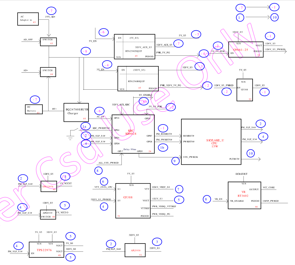

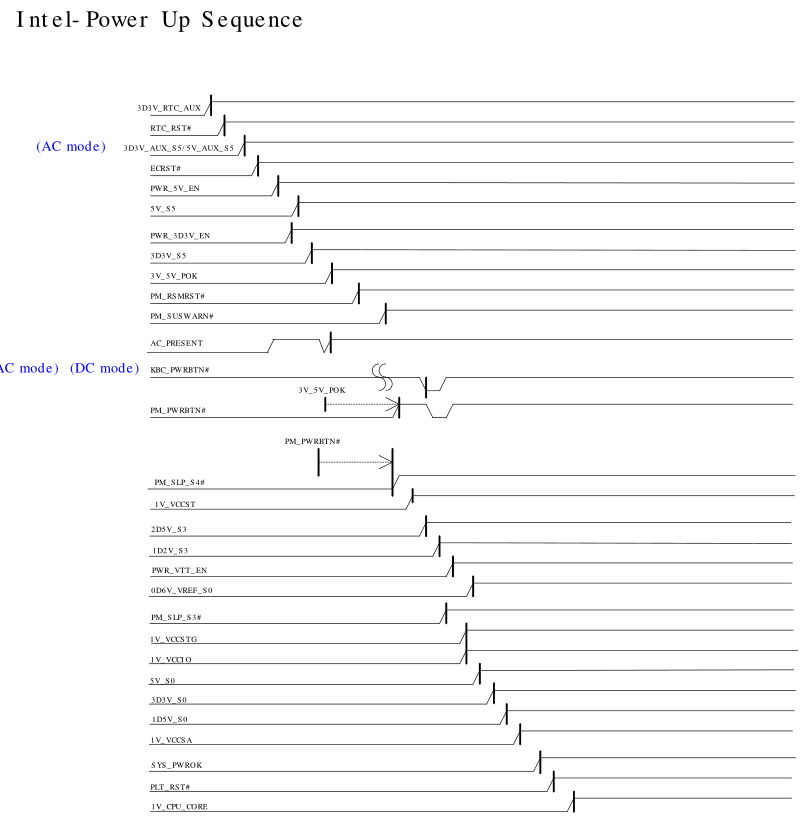

    POWER SEQUENCE SIGNALS IN ORDER OF MEASURING VOLTAGE READINGS, skipped some signals to show the point of failure:
    5V_S0 = 5.10V
    3D3V_S0 = 3.0V
    1D5V_S0 = 1.507
    1V_VCCSA = 1.04
    SYS_PWROK = 3.25 (THIS COMES FROM SUPER IO ENE KB9028Q PIN 106)
    PLT_RST# = 0V
    1V_CPU_CORE = 0V
    ALL_SYS_PWRGD = 3.09
    VCCST_PWRGD = 0.98
    1V_CPU_CORE = 0V

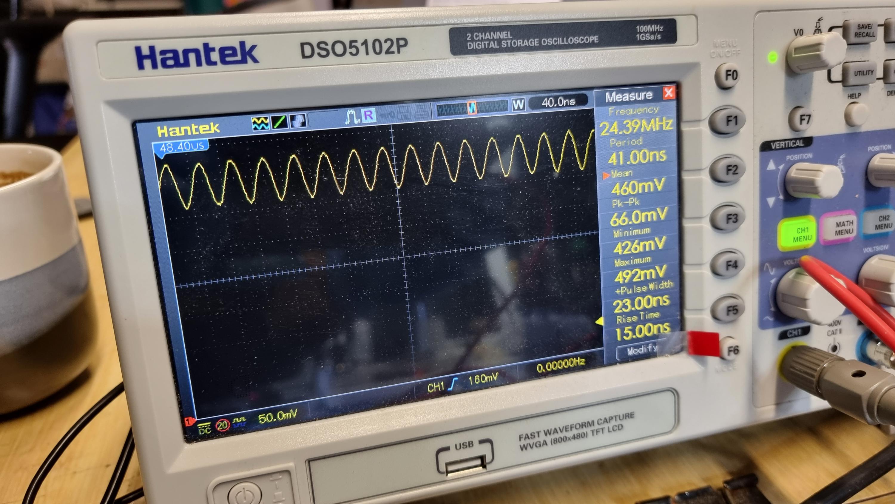

    CLK_CPU_BCLK CRYSTAL READING 24.39MHz AS PICTURED
    VR_RDY = 3.29
    PCH_PWROK = 3.29

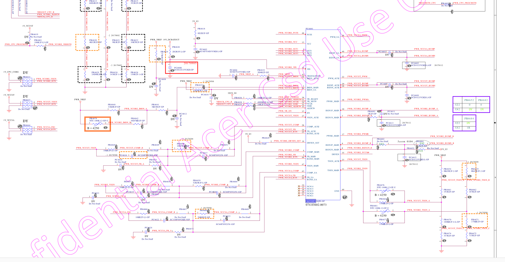

    H_CPUPWRGD, RED IN SCHEMATICS. CAN'T FIND.
    SYS_PWROK = 3.25
    PLT_RST# = 0
    VCC = 0
    VCCGT = 0

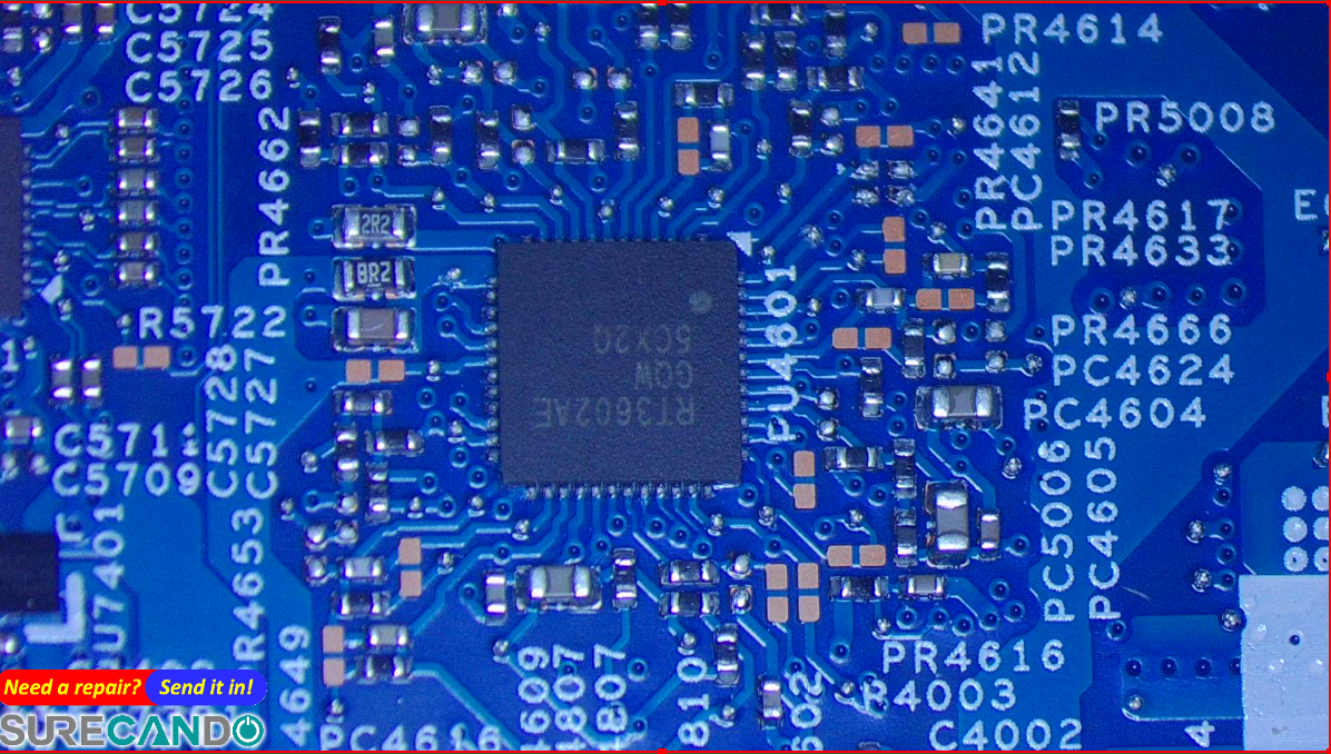

    CHIPS OF IMPORTANCE
    RT3602AE AT PU4601*- It's responsible for enabling giving the 1V_CPU_CORE

    I have uploaded the following for you:
    1. Original BIOS bin as well as flashed BIOS bin.
    2. Original EC bin and flashed EC bin.
    3. Schematics & Boardview
    4. Images of interest.
    Re: Acer spin 5 sp513-52n power on no display

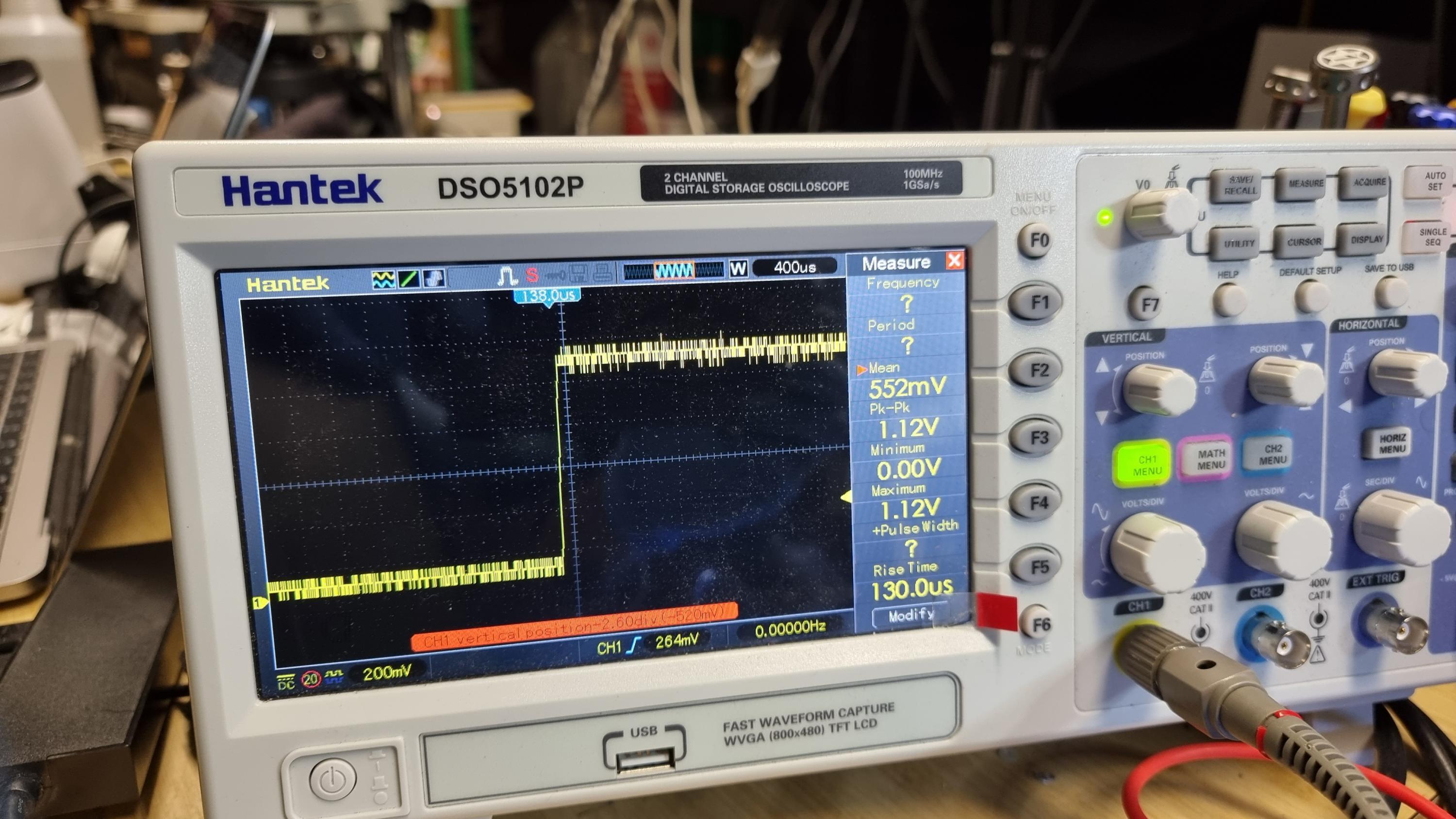

    Clock image.

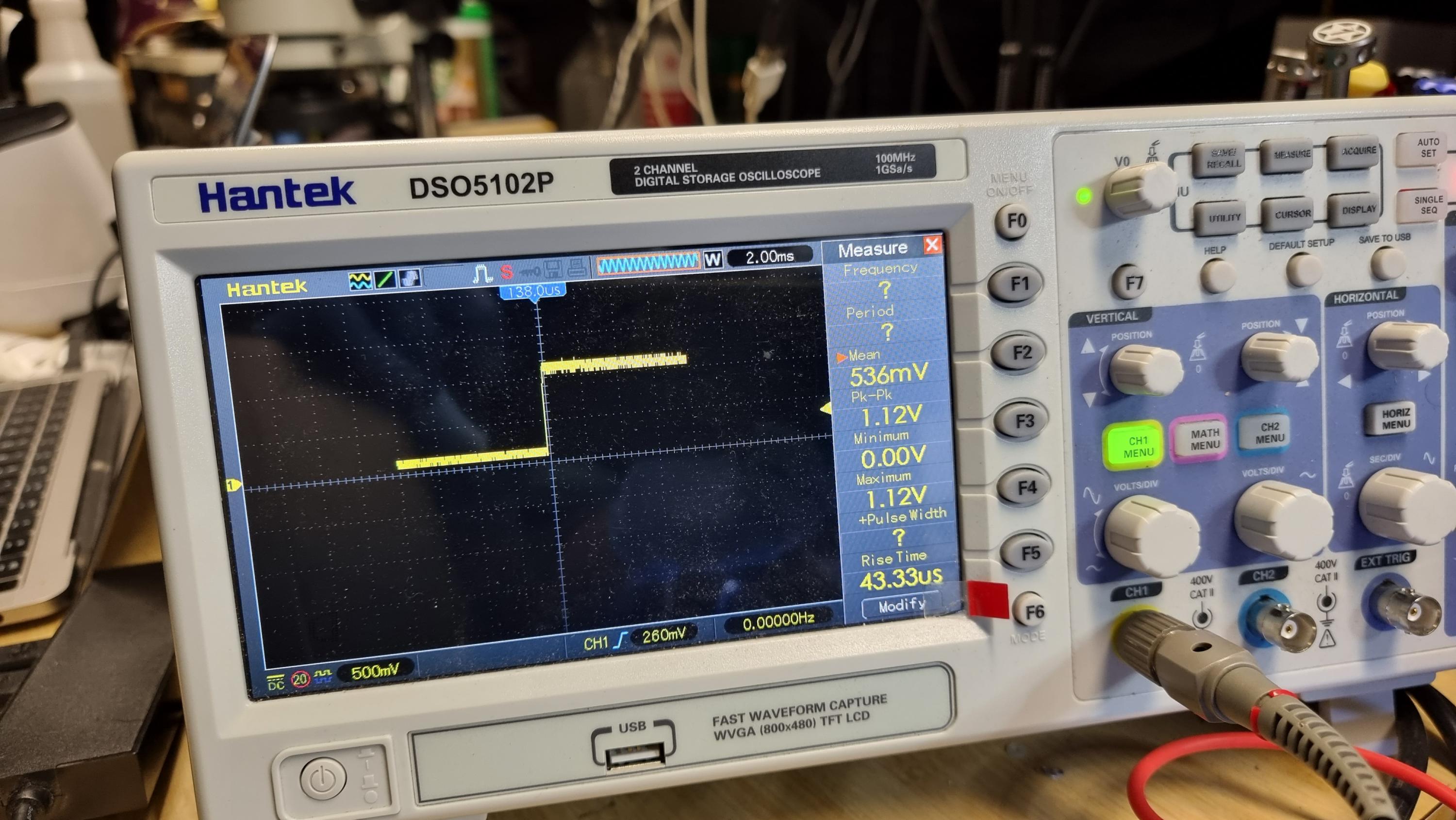

      PROCHOT_CPU 1M 0.99V
      SVID_ALERT#_CPU 3.17k 0.123V
      SVID_CLK_CPU 495 0.99V
      SVID_DATA_CPU 496 0.99V
          That's the SVID_DATA_CPU with trigger menu on oscilloscope.
