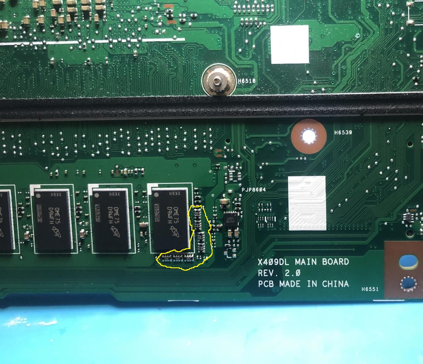

    hi everyone
    i have asus d509dj with board code x409dl rev 2.0 its randomly blue screen ,restart ,frozen so i suspect it's a Memory issues
    serched on the internet there is no boardveiew or schematic Available so i tryed and manged to disable onboard ram by removing those 7 groub resistors and flashing bios with thise uma version bios file X409DL REV 2.0 (barkod X509DAP ) UMA**********************
    now its work fine .
    the Problem is when i start laptop
    I should get into bios screen and reset default seeting and restart otherwise laptop stuck on windows logo
    (I DO NOT MAKE ANY CHANGE ON THE BIOS SEETING)
    any helpful idea
