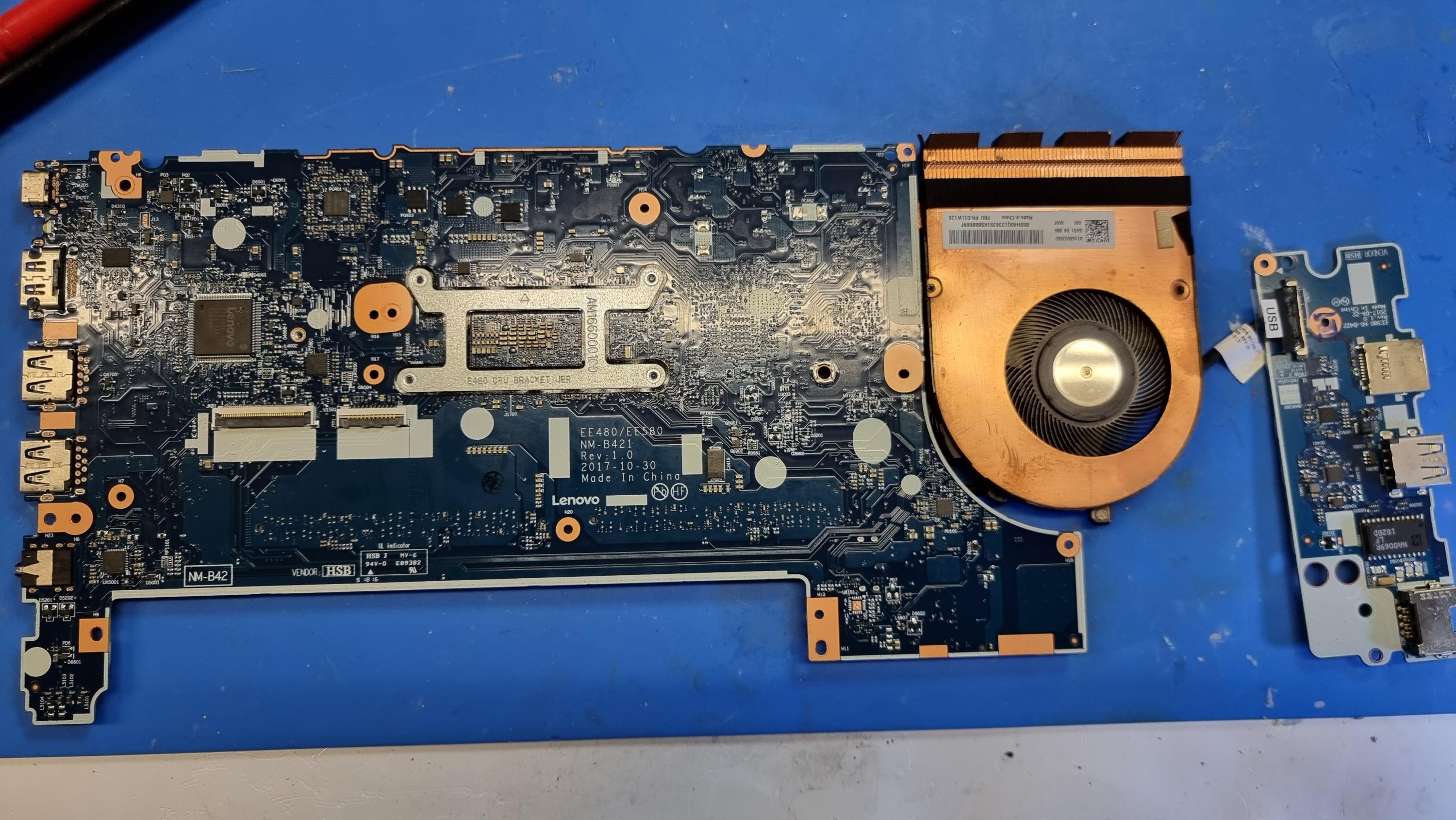

    Can I please get some help, I can't figure this out.
    Board: NM-B421
    Model: Lenovo ThinkPad E570
    Charger plugged in, flashes 3 times. Power button pressed, it turns on 2 seconds then off. Occasional fan spin slightly until it turns off again. Never more than 2 seconds.
    Attached PDF shows readings I gathered.
    Things tried:
    Flashed 5 different BIOS files, original bios dump + 5 others linked, schematics and board readings are all here:
    https://drive.google.com/drive/folde...US?usp=sharing
    Here is the video of the fault:
    https://youtu.be/OB6xf7211Mg
    Aditya11ttt says on a forum:
    'In this board u don't need to program io it will program auto , but still it's a theory u should try to program and update me it's done or not !!"

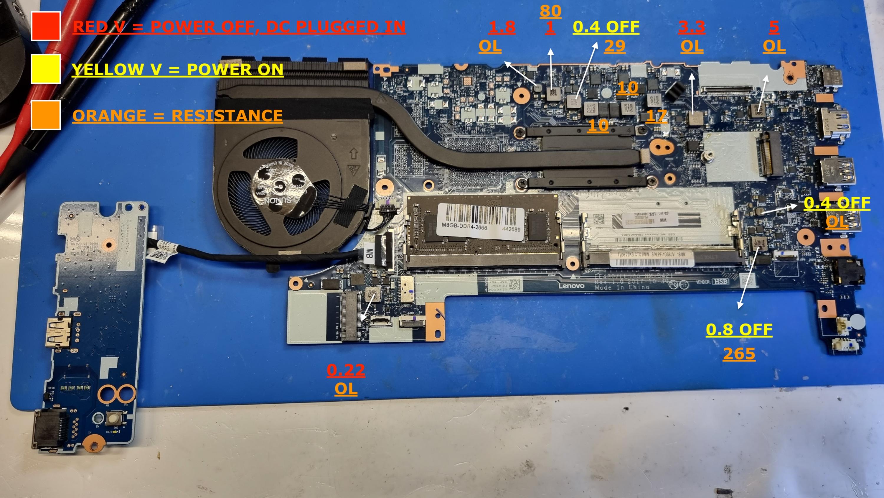

    Attached also the image of the board with readings.
    Anything else I can try? Thanks!

    PQ301 Mosfet is playing weird. I've replaced the Mosfet already. The PU301 which is a RT8231AGQW is acting up I suspect. See measurements.

      Sorry this is the correct readings.
