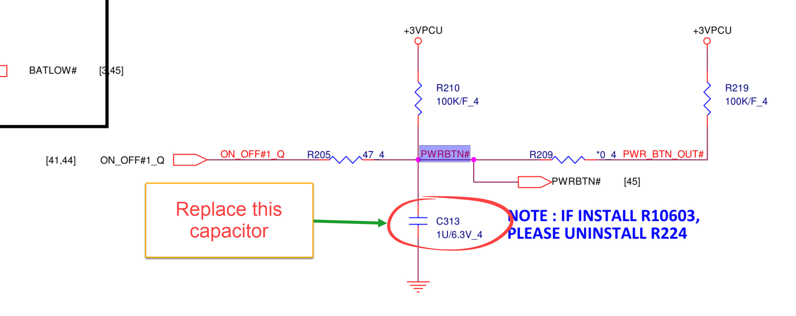

        Re: hp probook 430 g4 DA0X81MB6E0 rev:E
        this MB:HP 440 G4-DA0X81MB6E0 REV E does not turn on but when I put the multimeter to PWRBTN# and plug in the charger and press the button it turns on. if I turn it off and remove the multimeter, it does not turn on. anyone have a solution please.
          Review the charge capacitor @ C313. Replace it and test again. The value is not critical so any value, even 22uf, etc. is ok.
            I changed C313 it didn't work, I also changed Q36 and Q37 nothing.
              Measure the voltage to ground of PWRBTN#.
              Measure while the switch is open.
              Hold down the power switch and measure again.
              Release the switch and measure again.
              Post each measurement.
