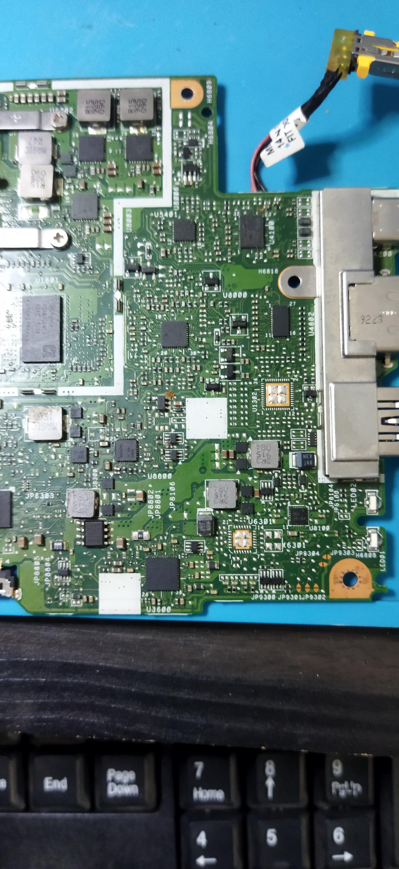

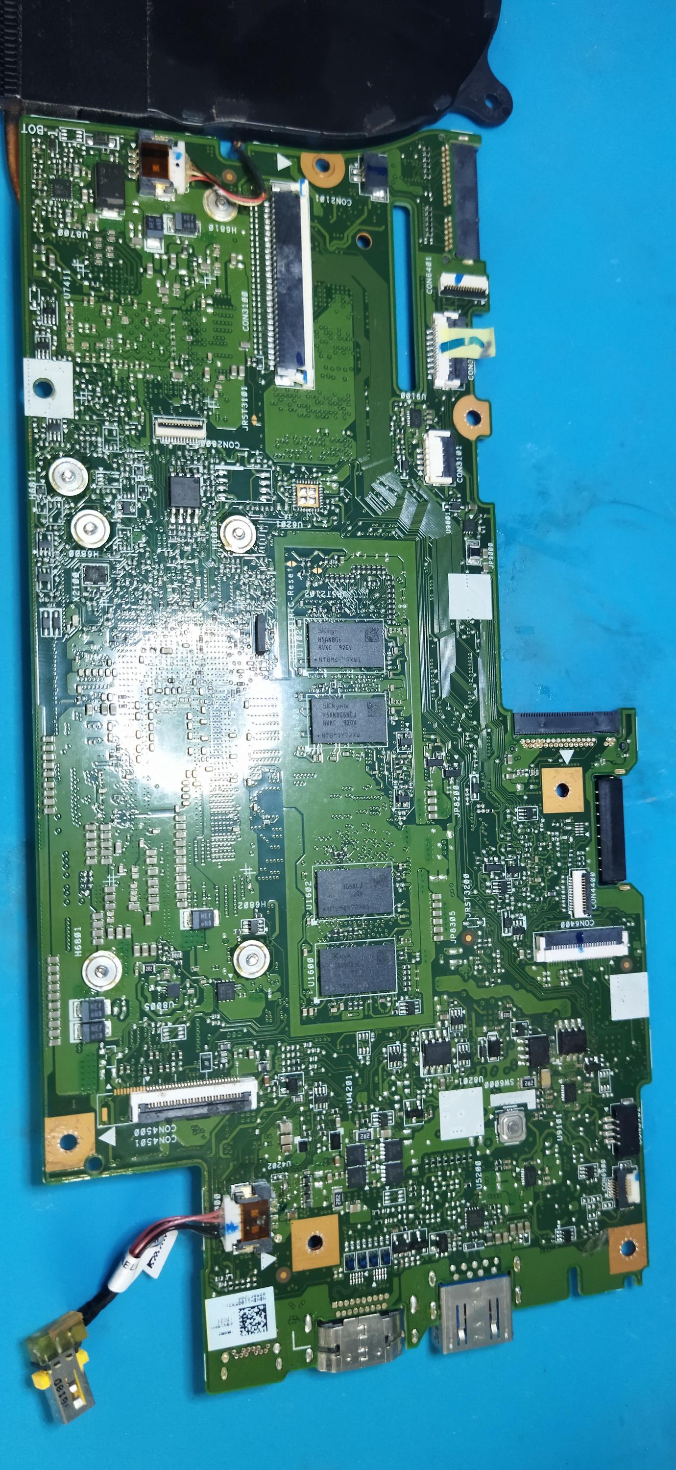

    I have a short somewhere when I plugin the 19v adapter , the voltage on DICIN connector drops to 2 Volt. I have never worked on this board so not sure where to inject the voltage
    • 21874
    Re: Acer Swift SF314-55G, MI4FA MB REV:2.1 BoardView file and Schematic diagram
    post pictures of both sides of the board while you are waiting for someone else to post the schematic in your schematic request thread.
    Post good clear pictures of the DC in area,both sides

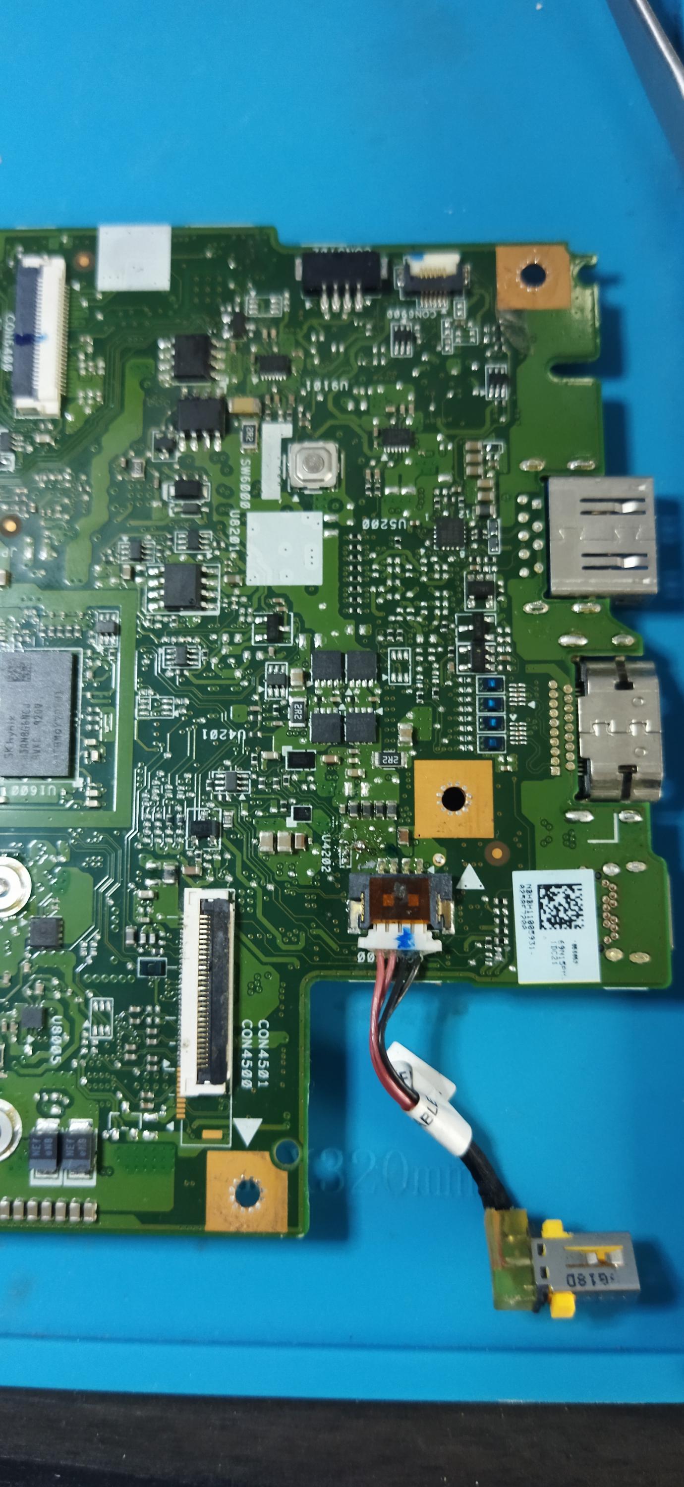

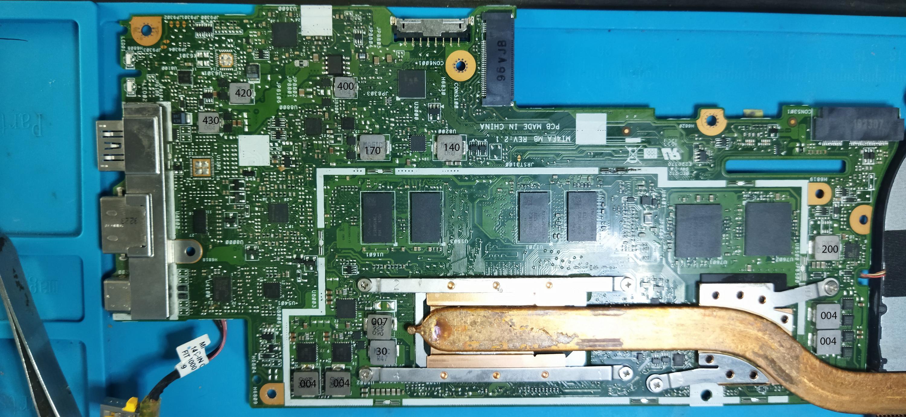

      Attached board images. one of them shows the impedence we have on the coils

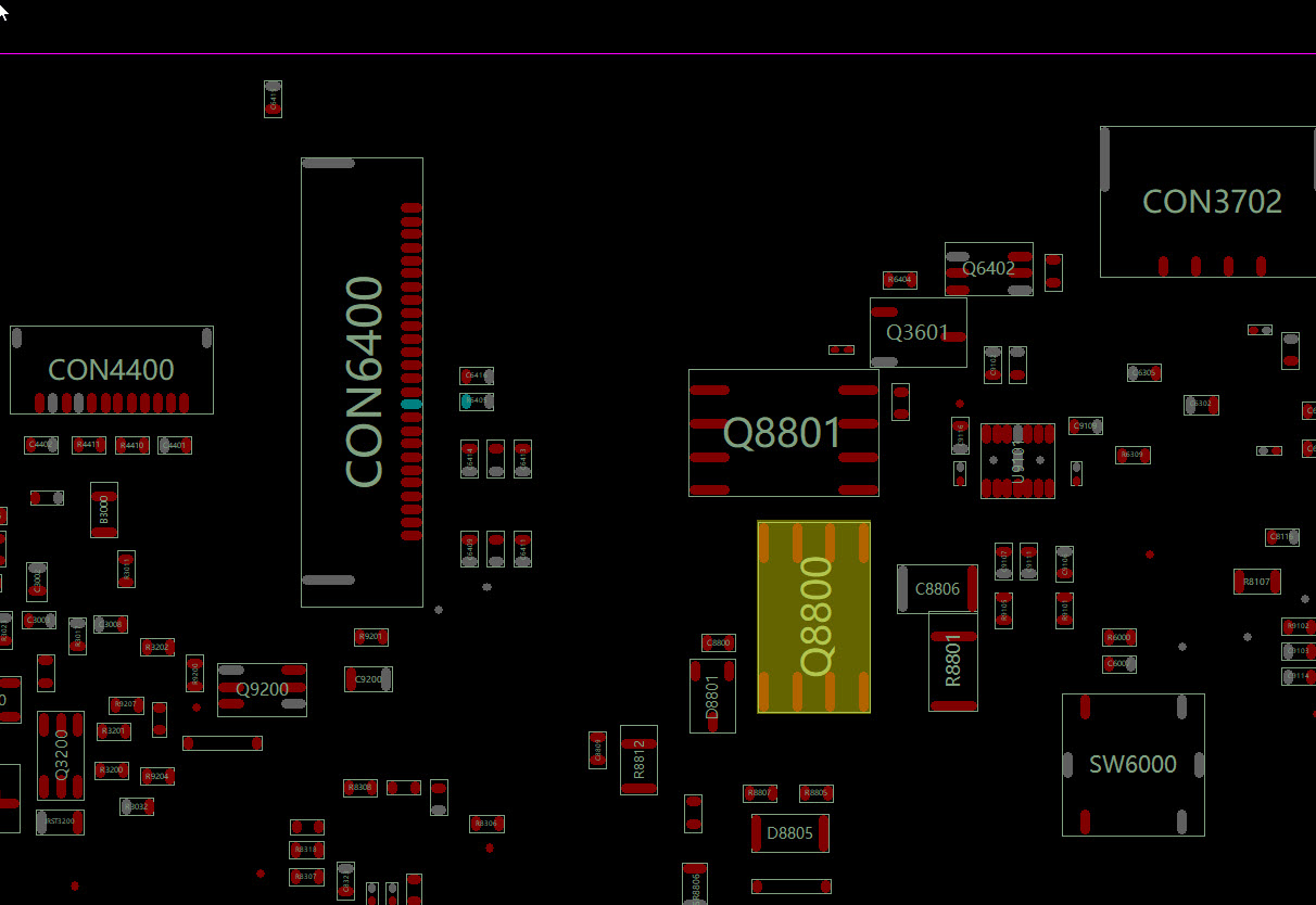

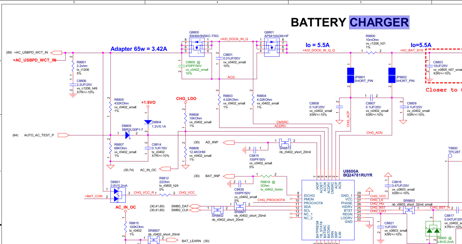

        See attached to get started. It is from the v1.4 of the logic board but looks to be the same as yours.
        Measure the resistance of the DCin mosfets - WITHOUT power.
        Often the 2nd mosfet is damaged.
        Remove all power / no battery.
        Meter in resistance mode.
        Measure the resistance of each of the 2 x dcin (Q8800 / Q8801) mosfets as follows:
        Source (1-2-3) & drain (5-6-7-8)
        Source (1-2-3) & gate (4)
        Gate (4) & drain (5-6-7-8)
        Post each measurement and the meter scale used.
        Repeat for the next mosfet.
            Resistance of DC IN MOSFETS
            Q8801
            D --> S = 639 MΩ
            S --> G = 100 KΩ
            D --> G = 639 MΩ
            Q8801
            D --> S = 1206 MΩ
            S --> G = 100 KΩ
            D --> G = 1305 MΩ
            • mon2
              • Dec 2019
              • 14662
              The 100k readings are of concern.
              Remove the second mosfet off the logic board and check if the s-g reading is still 100k. If yes, check the first mosfet that is still soldered on the board.
              Often, the second mosfet will bring down the resistance reading of both dcin mosfets. Likely, the 2nd mosfet needs to be replaced.

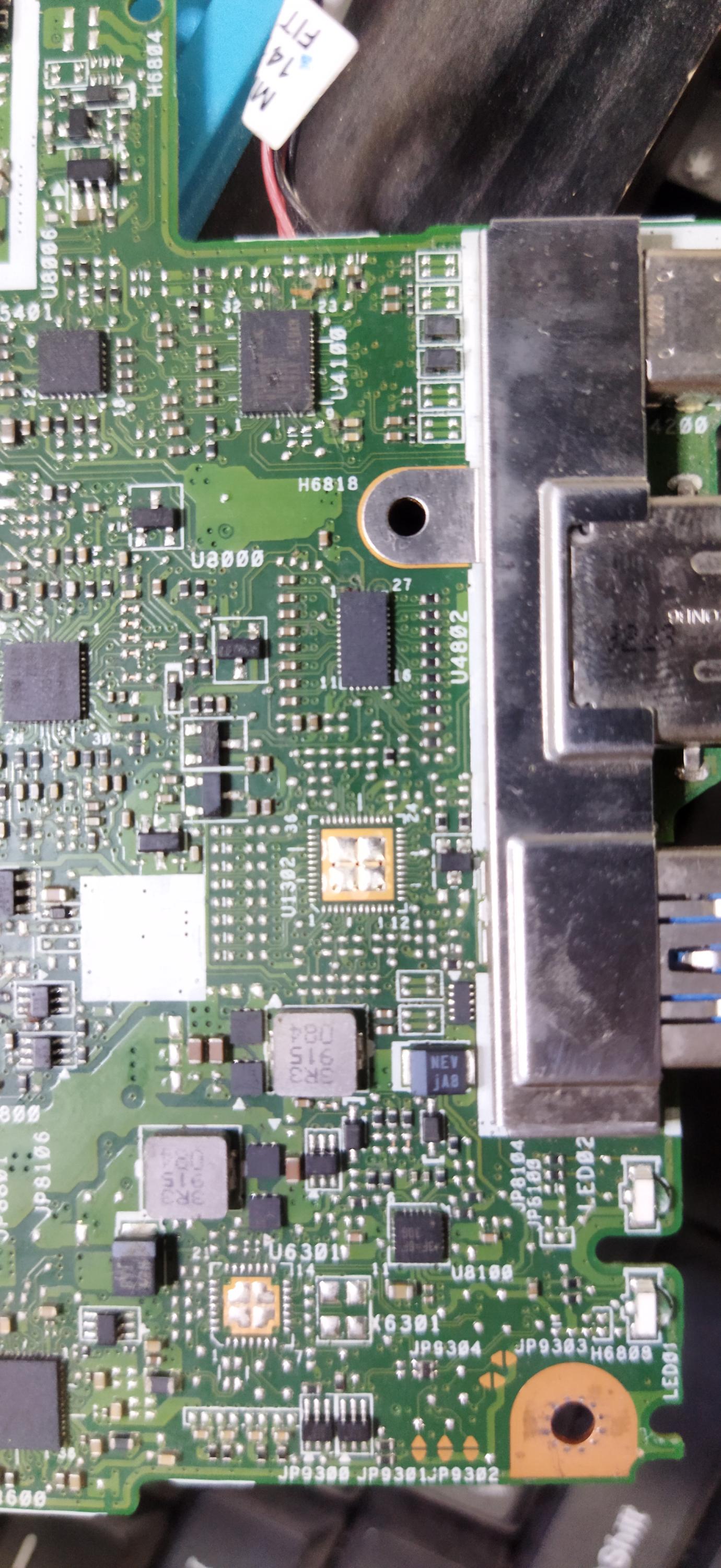

                I removing the mosfet i checked the resistence between S to G and it shows OL. Can you also share the 1.4 version of boardview and schematic if possible. I also checked the Charging IC and did not find any low impedance. Just not sure where the shorting is and where to inject 1 Volt.
                • mcplslg123
                  • Jun 2015
                  • 7262
                  • india
                  Most likely the marked component is CLR.
                      There is some improvement. After Replacing the second DC in mosfet Q8801 I am able to turn on the system without battery and it runs fine. However with battery connected, the system does not turn on. DC_IN connector voltage drops to 0V
                      • Sephir0th
                        • Oct 2020
                        • 1289
                        To get a better overview we need a full measurement of the charging controller a) with out battery and.b)with battery plugged in. Something must be wrong in charging section or maybe faulty diode before charging controller VCC for example.
                          The battery mosfet should be inspected and checked with resistance mode.
                          Remove all power. Check the resistance of the:
                          Source & drain
                          Source & gate
                          Gate & drain
