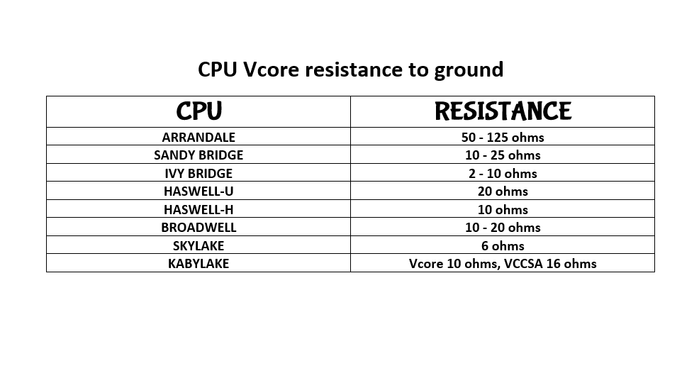

              • DanielDacko
                • Mar 2015
                • 328
                • Macedonia
                Re: hp 15 LA-G07DP No vcc core
                Pretty sure that +19V went straight to the CPU and damaged it. However, take a look to this image, maybe it will help you.
                    thanks
