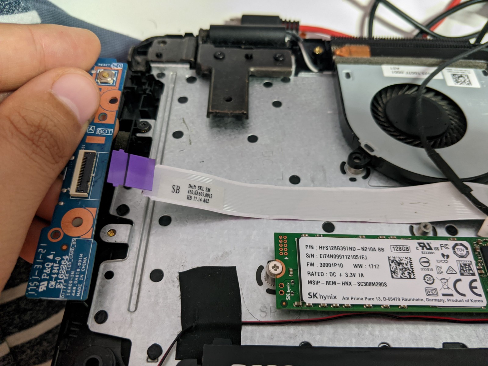

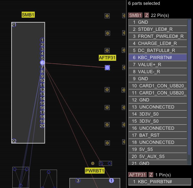

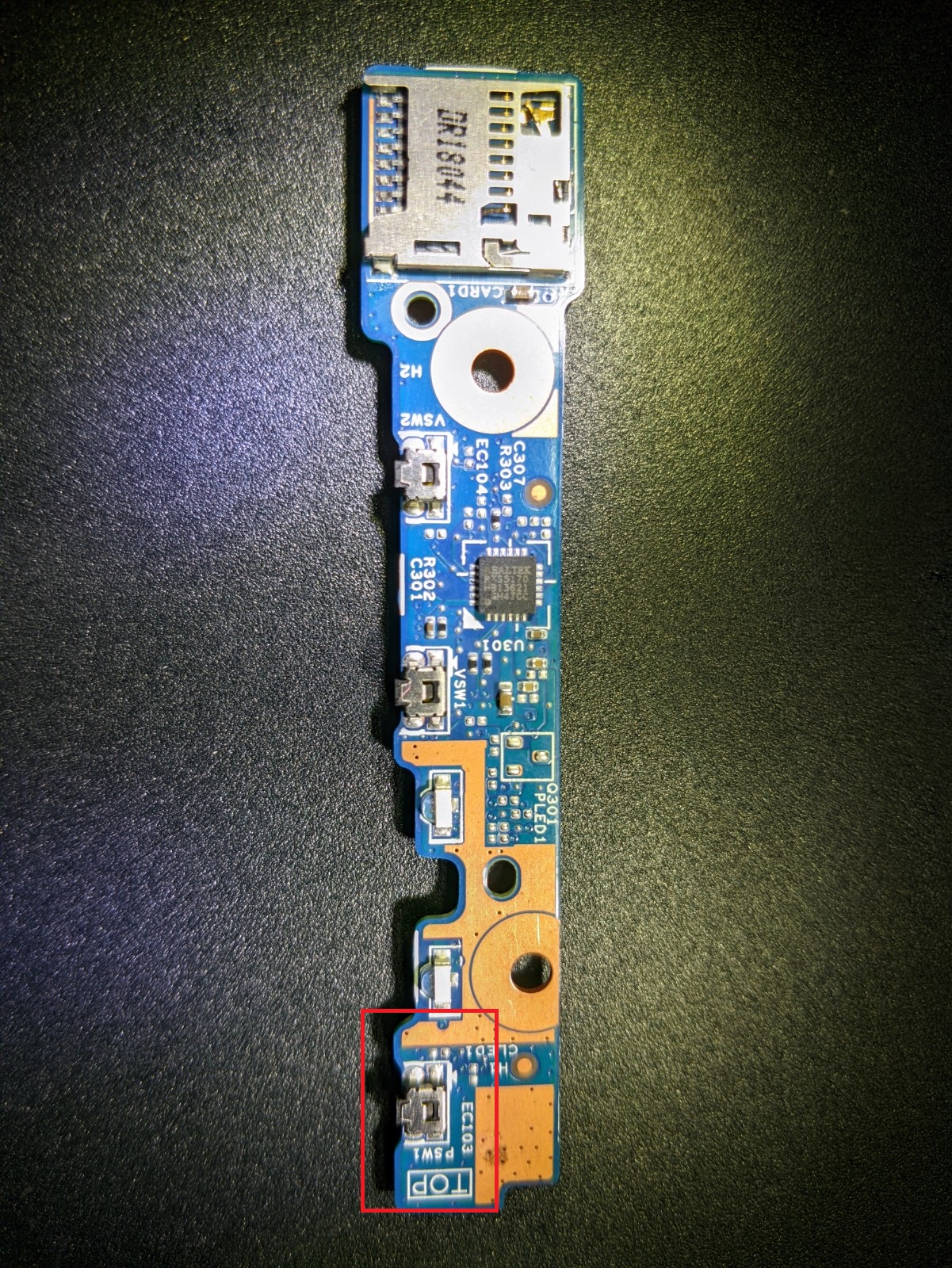

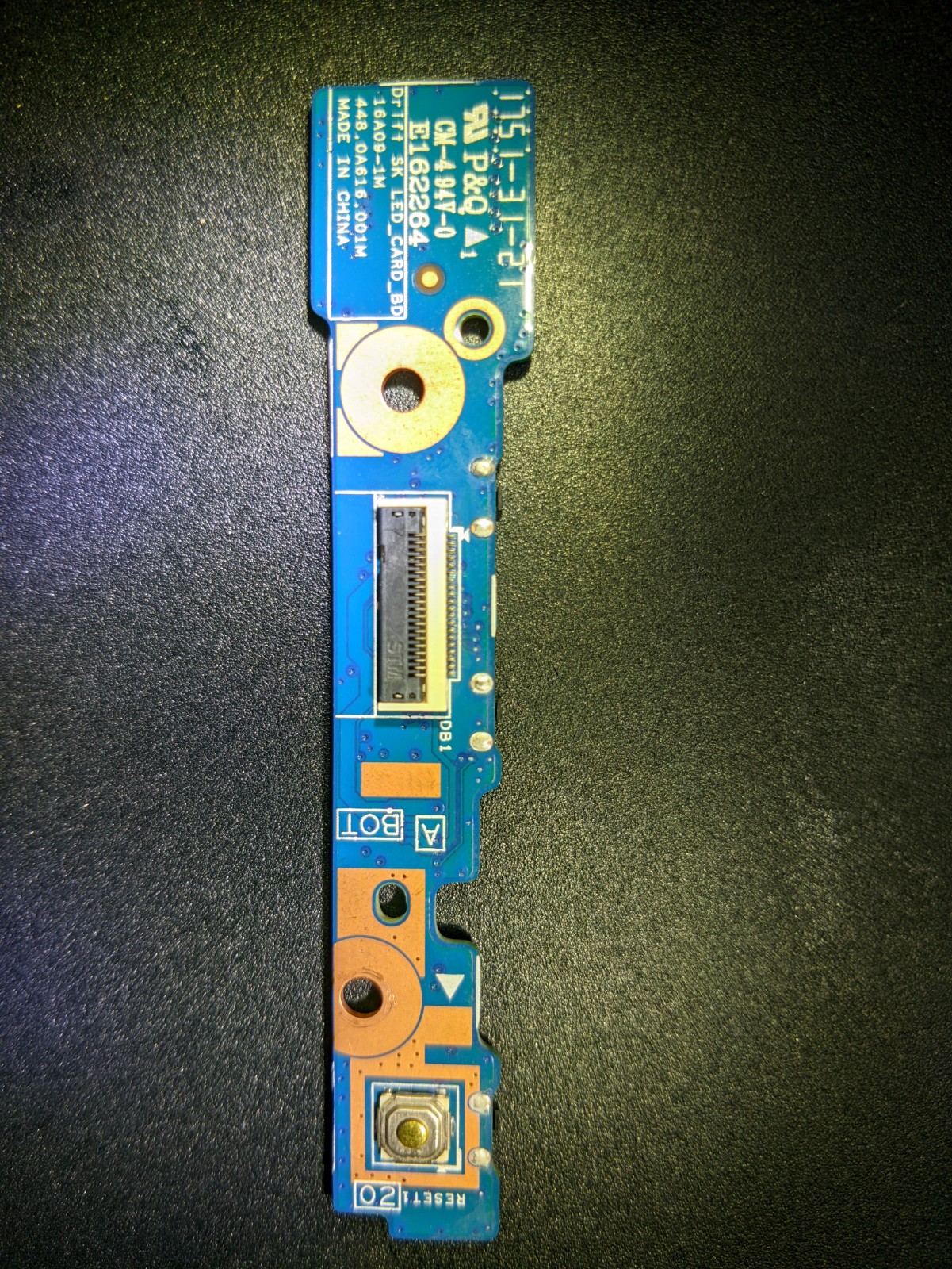

                    #29
                    Re: Acer Spin 5 - Turns on and off after a few seconds
                    It's not the RAM, cause right now it is on Windows login screen, with the power/card reader daughter board disconnected. So the problem is isolated to this board.
                    Every time I connect the board it turns on and off after two seconds. Every time I power the laptop on by shorting the pwr + ground on the main board (with the daughter board disconnected) it powers on fine.
                    Let me attach a few photos.
                    EDIT: So far I've tested the power button by ensuring there is no continuity when not being pressed, and that there is when pressed. The Realtek chip is a card reader chip, and I don't know if it can cause the issue. I checked for short to ground on the capacitors around it and they aren't short to ground. I can't find datasheet of the IC to be able to eat least measure the resistance around it. Again, not sure if this can cause the issue, but I am assuming that it can.

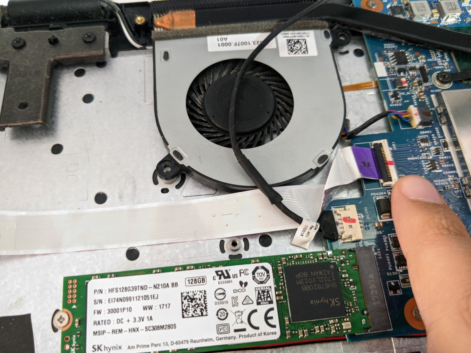

                      #30
                      Are you confident on the placement of the interconnect flex cable from this paddle board to the main logic board?
                      Confirm the pin #1 orientation. Sounds like a short when connected.
                      The board is very inexpensive and appears to under $10usd. Worth to replace it. See it on eBay and AliExpress. Or if you wish, replace the active parts on this board to rule out the sd card reader IC, etc.

                        #31
                        Removed the Realtek chip and the problem is gone.
