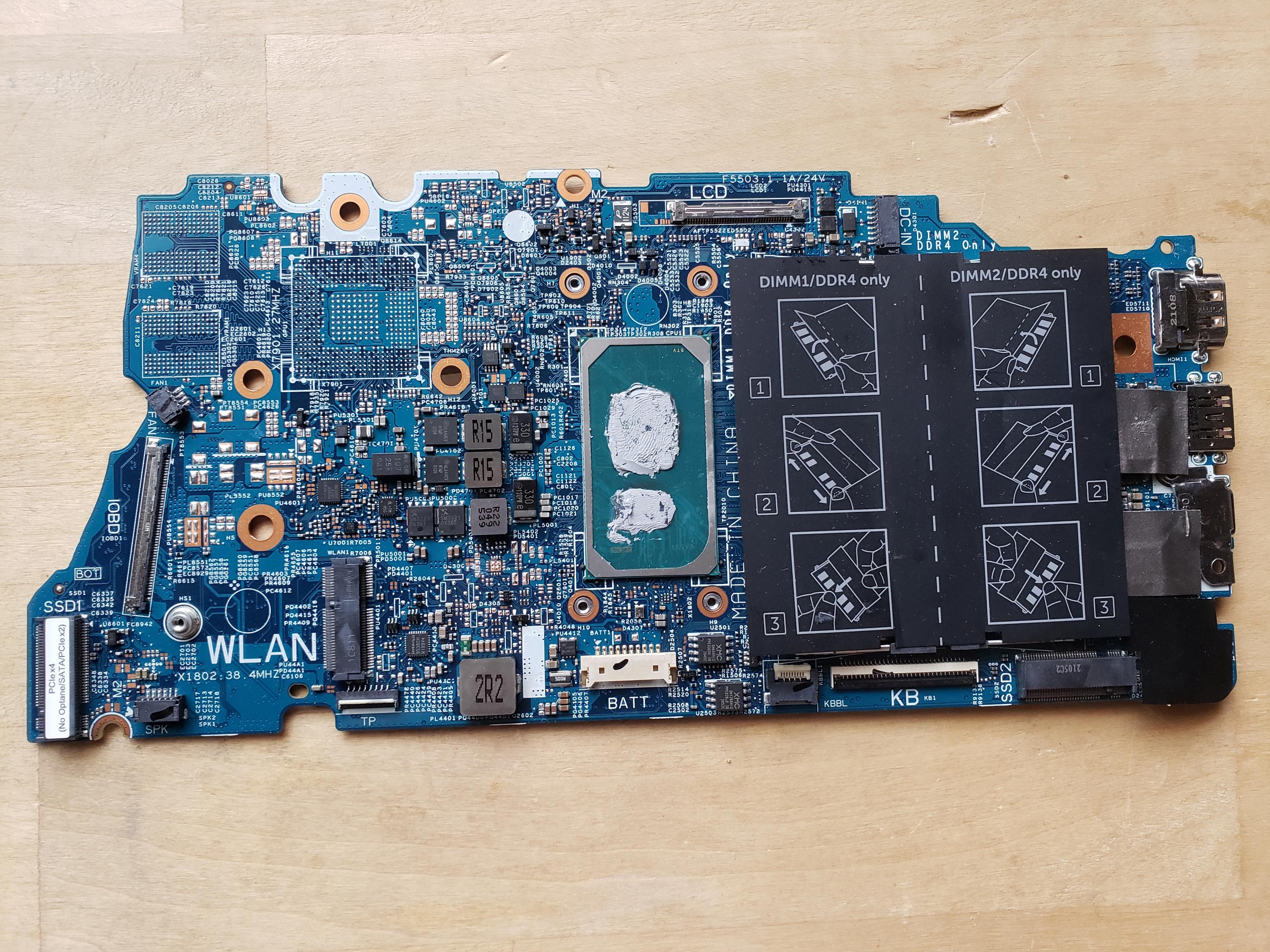

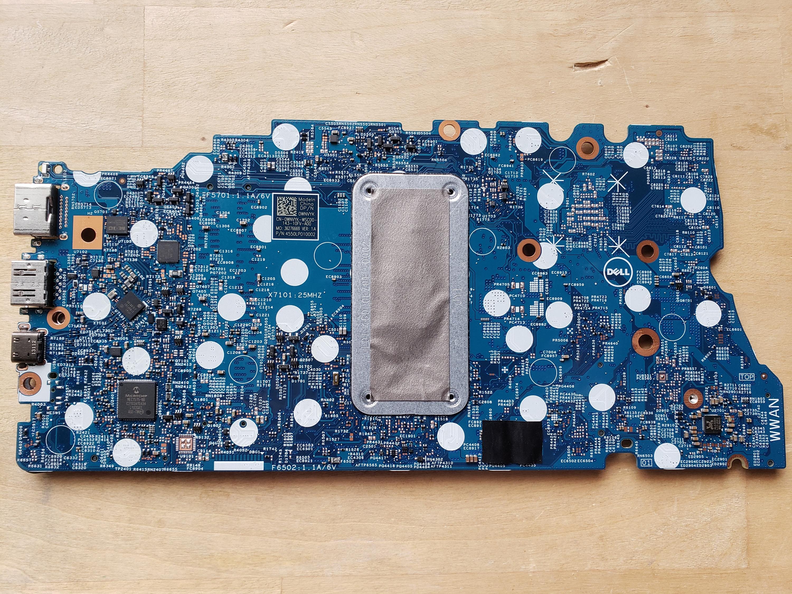

        Are there other markings on your logic board ? Unable to find any schematics for this model in my (paid) database of schematics / BV files.
        Can you post pics of the logic board to show all white silk screen markings or labels ?

          Here are the pictures hope you can make sth out of it

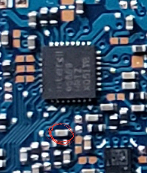

                Re: Dell 5502 0wnvyk intel 11th gen no power
                Anybody has schematic for isl 95869
                One of us cap is around 4 ohm to ground
                See attached
                • mon2
                  • Dec 2019
                  • 14671
                  Review the attached, the datasheet may be similar to your device. Post your update.
                    First tnks for pointing that out but I had checked that datashet before I posted here
                    The capacitor is connected to the 5th pin of the IC
                    On the 95859 datasheet each side has 10 pins
                    Pin 6 to 10 deal with current sensing, the processor itself has resistance for 40 to 140 ohms, so for 95869 it is very likely the 5th does anything but related to current sensing
                    Actually there is full data sheet for this IC but hidden behind a wall. To download it Renessas has to approve your purpose, else you wouldn't get the download link
                    Is it better if I start new thread in the schematic request to ask for this ic pinout ?

                      Can you share all silk screen markings on your logic board ? Perhaps there is a schematic floating out there.
                      We run a hardware design company and have close ties with Intersil but they are quite strict on releasing such documents. We attempted to source the ISL9240 details when the component was not available for the macbook repairs. Now, of course, everyone in the street corner has the parts available in Asia. It is a double-standard. NDA (non-disclosure) documents mean zero to offshore companies.
                      • ss45
                        • Jun 2019
                        • 119
                        • Brazil
                        For the silk screen check Post number 5
                        there isnt any meaningful information behind stickers
                        So all relevant information I believe is what you can see in the photos
