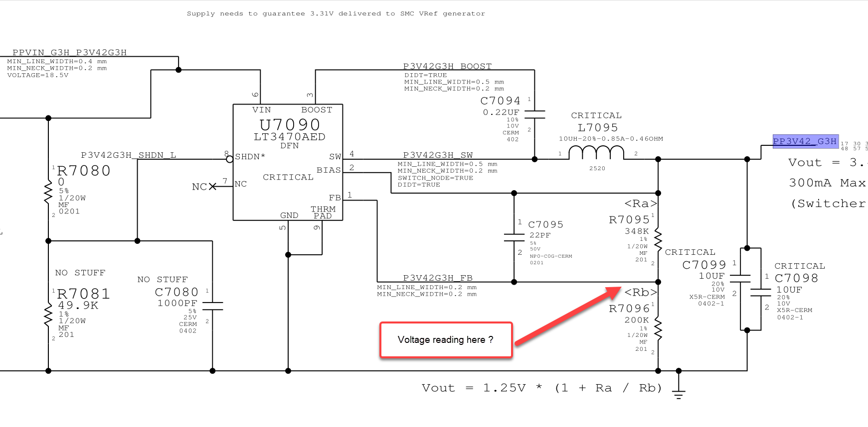

                Still suggest that you correct the reading of PP3V42_G3H. It is too low. This has to be ~3v42.
                If your meter is not accurate, consider a new one from Amazon or similar. A good enough one should be < $50 USD. Check the reviews of multimeters on EEVBLOG that has the thorough details on the features.
                See attached.
                What is the voltage reading for the FB pin on U7090 ?
                What are the voltage readings for the following points of interest ?
                PPBUS_G3H
                D7005, pin # 1
                D7005, pin # 2
                D7005, pin # 3
                PP5V_S4RS3
                PP3V3_S5_REG_R

                  Here are my measures:
                  U7090
                  1 P3V42G3H_FB 1.23
                  2 PP3V42G3H 3.37
                  3 P3V42G3H_BOOST 7.13
                  4 P3V42G3H_SW 3.36
                  5 GND
                  6 PPVIN_G3H_P3V42G3H 14.52
                  7 NC
                  8 P3V42G3H_SHDN_L 14.52
                  PPBUSG3H (F7140 pin2) 8.40
                  D7005
                  1 PPBUSG3H_R 8.40
                  2 PP18V5_DCIN_ISOL_R 14.57
                  3 PPVIN_G3H_P3V42G3H 14.52
                  PP5V_S4RS3 0.00
                  PP3V3_S5_REG_R 3.27

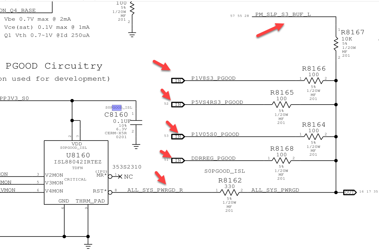

                    What is the voltage of EN1 (pin #4) = P5VS4RS3_EN_R of U7501 ?
                    Do you have a donor board for spare parts ?
                    Can you replace L7095 ?
                    • modtool
                      • Jul 2015
                      • 63
                      • Italy
                      Re: Macbook Air A1465 - 820-00164-A , No reaction to power button
                      Yes I have some Apple dead boards from which I can take some components.
                      As in my 8th message before, P5VS4RS3_EN_R = 0.00 , but it shows a single pulse (as all "after-S5 signals) some seconds after the magsafe is connected, and if I close SMC_ONOFF_L to GND.
                      As thought before, the fact that those signals make a single jump makes me think about a short somewhere, but I have tested every S4 - S3 -S0 main rails and found no shorts...
                      Could it be some voltage/current sensing circuit that is working bad and reporting it to the SMC , who doens't let start the board?
                          Remove R7551 and see if you get your PP5V_S4RS3 back.

                            Hi @mon2, thank you fro the suggestions, I will verify that every controller has proper connection with its current fb loop.
                            I desoldered R7551 , PP5V_S4RS3 is up at 5.03v , but P5VS4RS3_EN still makes 1 pulse on pin 2 of R7551...
                            I verified good soldering, no corrosions and zero Ohms on R8179 and R8175, does this mean that the SMC has some fault or maybe it senses something wrong and doesn't output PM_SLP_S4_L ?

                                  Would you have the proper voltage reading of 3v42 now with the new multimeter ?

                                    See attached.
                                    Review the ALL_SYS_PWRGD signal rail and inspect each rail that is OR'd together onto this line.
                                    Which power rail is preventing this line from remaining HIGH rather than the single pulse ?
                                    That power rail may have a current loop fault causing this event.
                                    PS: Please use the same net names as used by the Apple / Foxconn drawing - it will make it much easier to trace for the reader. ALL_SYSTEM_PWRGD was not found in my 820-00164 schematic.
                                    Update - wish to clarify on this ALL_SYS_PWRGD,
                                    a) confirm that PM_SLP_S3_BUF_L is stable and ON.
                                    b) the balance of the lines on this combined signal rail are OPEN DRAIN. So for this reason, the pull-up to PM_SLP_S3_BUF_L is required.
                                    c) remove resistors R8165, R8164, R8168, R8162 -> power up again and confirm that this single rail is now HIGH = confirms that P1V8S3_PGOOD is OK (power rail is GOOD since it remains HIGH).
                                    Then proceed to remove R8166 (confirmed to be OK) and stuff only the next resistor @ R8165. Confirm it is OK with the stable HIGH logic level, and so on till you find the bad power rail.

                                      With a multimeter borrowed from my friend, the PP3V42_G3H is 3.417, so I think it is a correct value, only my multimeter takes it in a different value.

                                      I've reviewed ALL_SYS_PWRGD signal and found continuity in every spot, pad, component and IC, but I couldn't make the last steps you suggested because the owner of the Macbook Air decided to take it back
