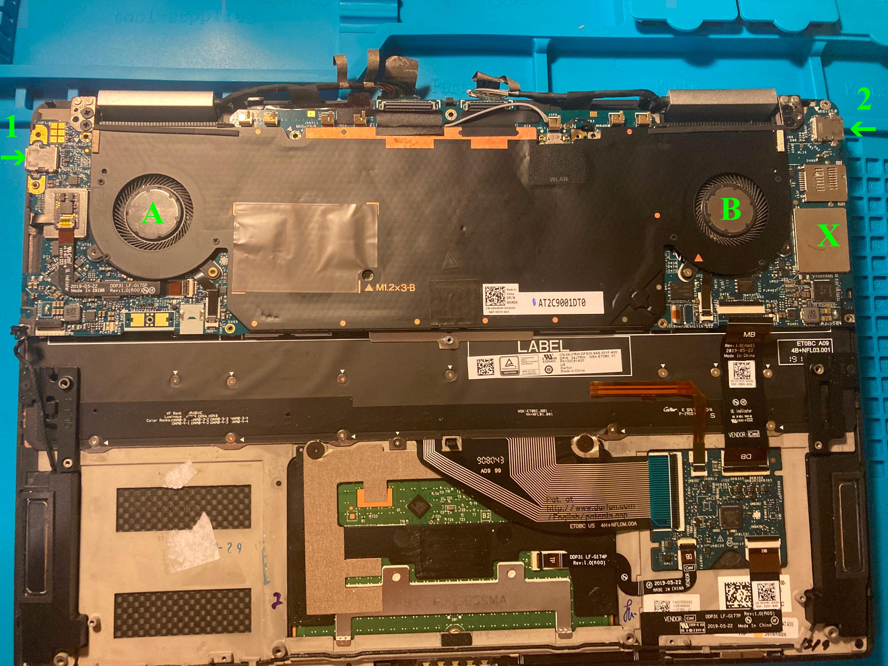

    Last Sunday, the computer was working fine with no issues or indications of a problem. I put it into standby Sunday night (normally I shut it down or leave it on) and left it unplugged. Monday morning I go to turn it on and when I push the power button, I hear a fan spin up and the front indicator light lights up all amber but that's it. Releasing the button stops both. I think, OK, so it's dead. That sucks. And plug it in.
    When plugging into the left USB-C, nothing happens. Same behavior as unplugged. When I plug it into the right USB-C, a fan stays on continuously. The screen doesn't so much as flicker. The front light stays lit all amber for as long as I have the power button depressed but at no other time.
    I took off the bottom panel and totally removed the battery. Attached is is what I'm looking at.
    For reference, because the board is flipped and upside down here, when I plug into port 2, nothing happens. When I plug into port 1, Fan A spins at 100% until unplugged. Also, and interestingly, component X gets VERY hot.
    I initially tried letting it charge for a bit, but smelled one of those close-to-burning-electronics smells so I unplugged it. To test where it was coming from, I plugged in the power and left it on for around 30 seconds. Component X heated up to over 100 degrees F in less than 5 seconds and after 20 or so, it was at ~236 as measured with a laser thermometer. The same happens when the battery is connected and the power button is depressed. So clearly power is shunted through component X early in the process. The temperature also dropped off quickly when unplugged, so I assume that's where the fault lies as no designer would put a part that gets that hot outside of the air channels and leave it to passive ventilation. Above component X are a Micro-SD slot and the non-functional USB-C, which formerly had a hub with power delivery plugged into it. I suspect the hub somehow shorted out a control circuit and that is component X. Since USB-C serves as both the charging port and a data port on this PC, it has to be wired into the charging circuit so my suspicion is that the component that failed at X is now drawing all of the power and preventing boot.
    I've got a schematic request in so I can better start diagnosing what's on the PCB (specifically what is component X) and trace out power flow, but until I can move forward there any suggestions are appreciated.

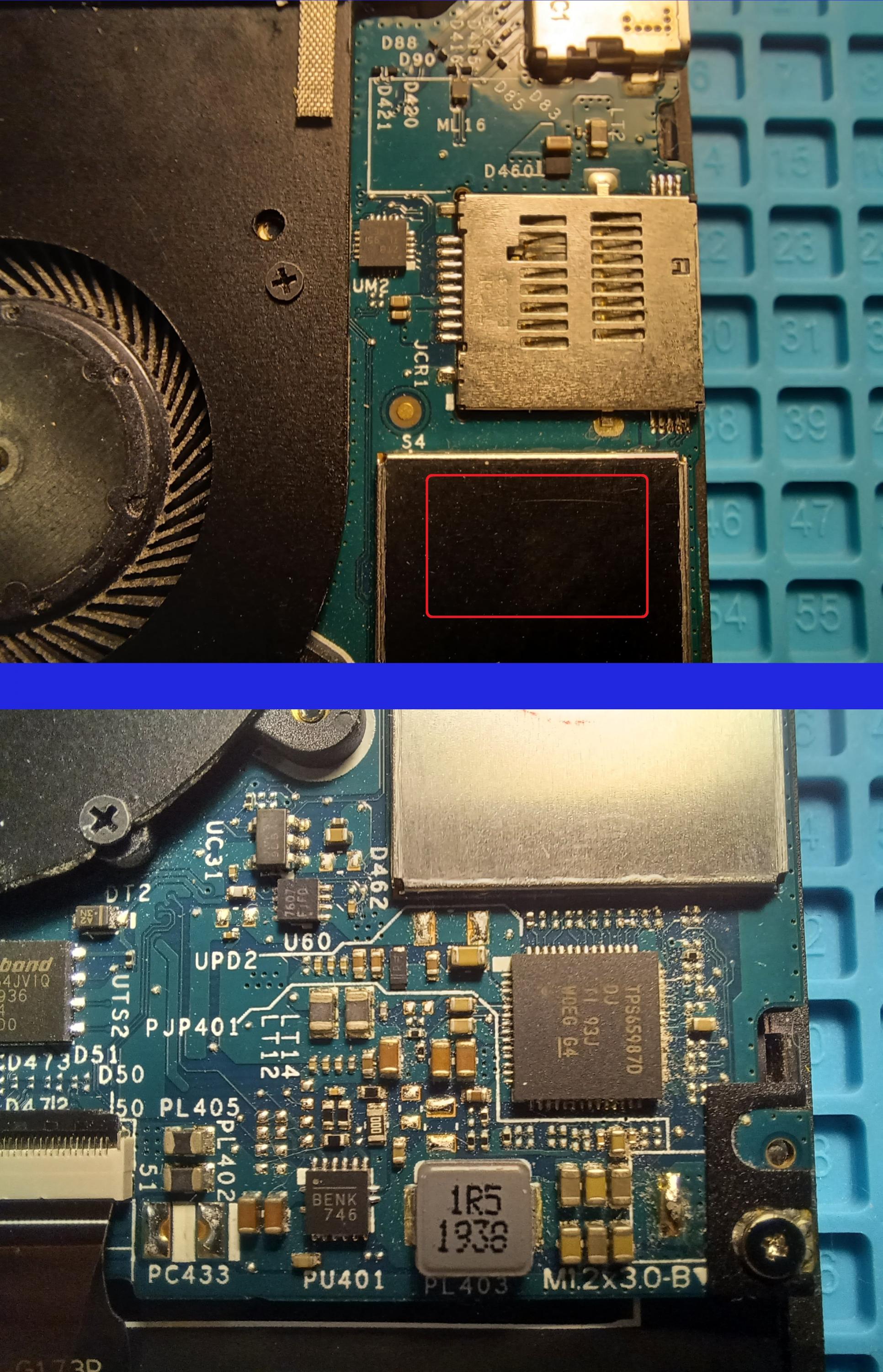

              Here are two closeup shots of the right side of the motherboard. The part outlined in red gets hottest, though mostly near bottom-center of the square I drew.
              I'm currently investigating the power distribution and power-on functions to try to identify what that might be before removing it. While I can't find mention of S4 as an independent component, it's listed as a a part of the power-on protocol several times.

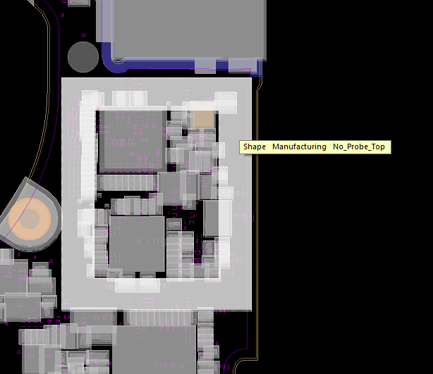

                Using Boardview I've managed to peek under the shield.
                As expected, that's where a lot of USB power components are. The shield is apparently to dissuade probing of the area.
                The big square in the upper-left is called a "BURNSIDE-BRIDGE_BGA_105P-T" and when I Google that I find it's one of two intel USB/Thunderbolt components.
                There are other diodes and chips and whatnot in the vicinity, but given the area that gets so hot, I'm going to operate on the assumption that this is the problematic part. It blows my mind that the retail on this part is under $3.00 and it can just crap the bed and knock out a $1,000 laptop. Then again, the diodes go for $.18 and they can do the same so. Wow.
                I'll be testing power at the 8 or so jump points tonight.
