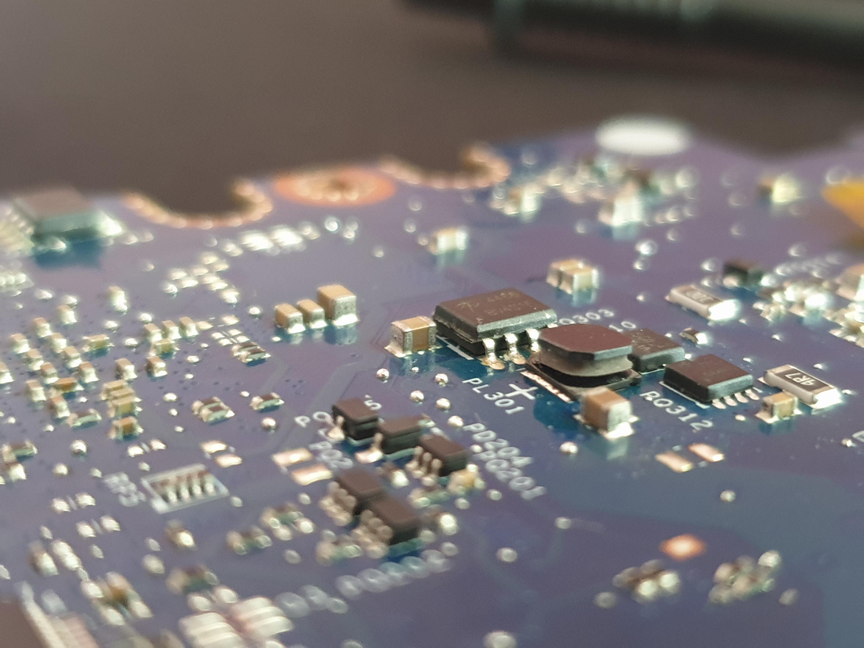

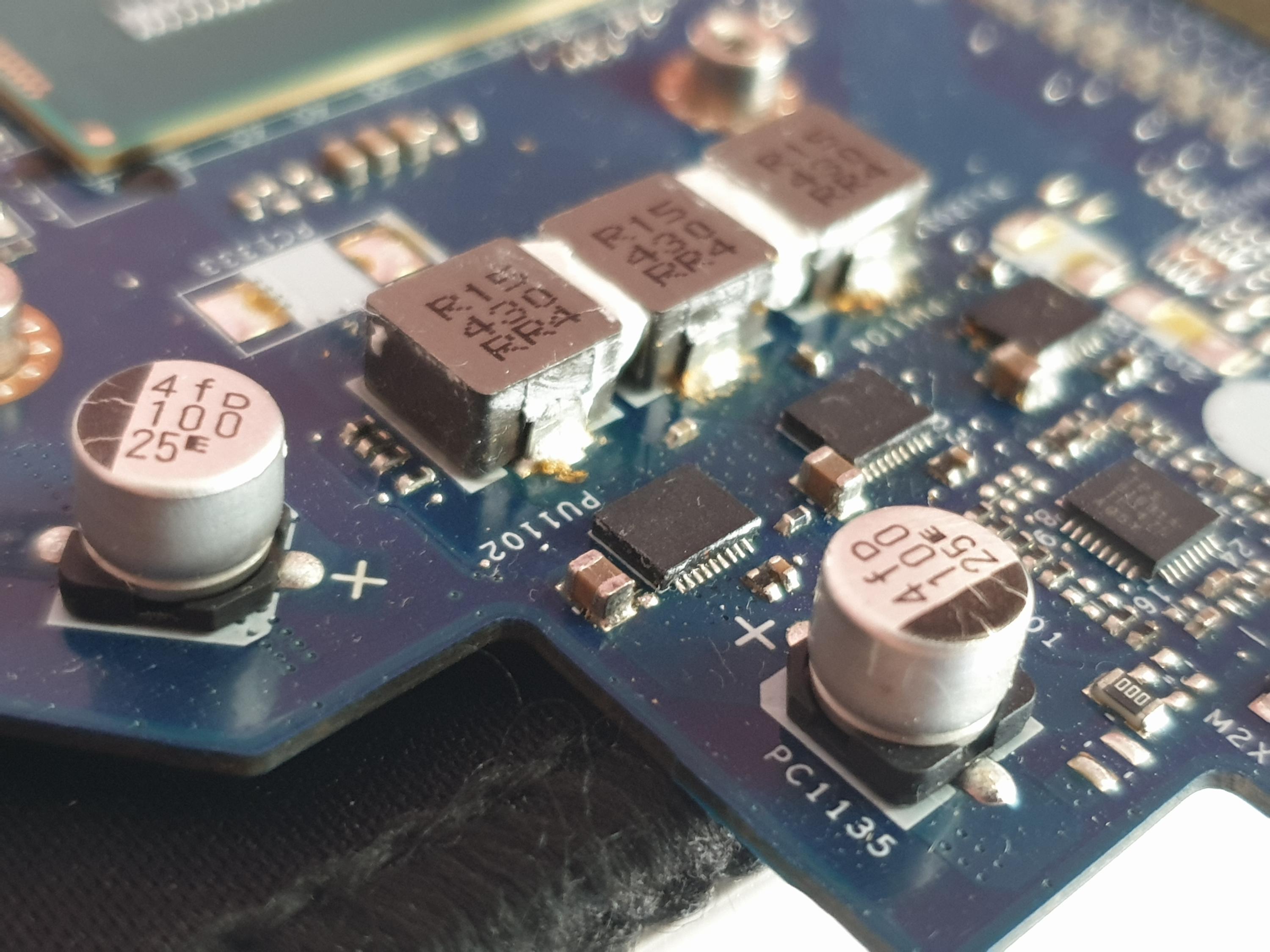

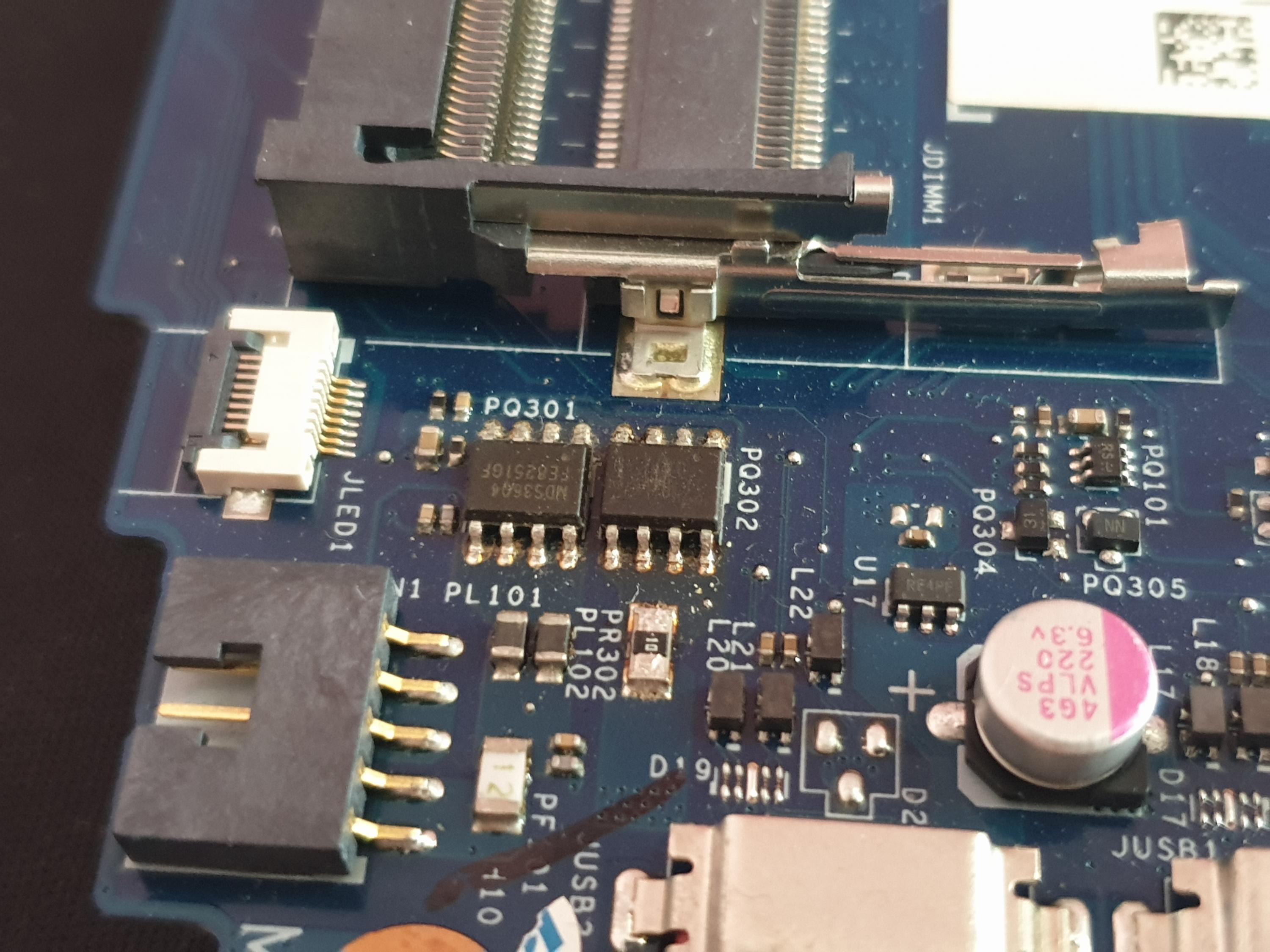

    First of all hello! I'm happy that this forum exists and thanks to you all!
    This is my private laptop and I just want to fix it, because I broke it...
    Now to the problem:
    Lenovo y50-70 LA-B111P 1A board
    A few days ago I've changed thermal paste and thermal pads (K5 pro). With that I've shorted out PC1130 and/or PC1108
    On battery laptop works, but the power supply doesn't charge it. I've noticed that it's a PQ302 chip (it's burned). Also found that PL301 is cracked.
    What should I check and how (I only have a basic multimeter)
    I'm linking some pictures so everybody can see:
  • JaroTech
    • Mar 2015
    • 351
    Re: Lenovo y50-70 la-b111p board burned pq302
    Hi, if you unplug the battery does the laptop work with just the adapter? If so, measure the voltages on pin 5 of PQ302 and pin 5 of PQ310 without the battery. Multimeter on a scale of 20V DC or more, black lead to ground and red to the pin to be measured. Be careful not to short any other pins.
