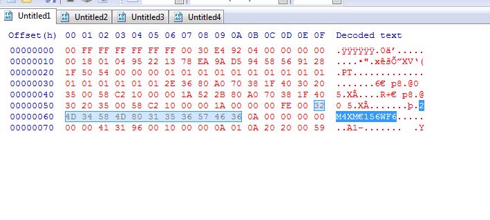

    If the panels are whitelisted in the bios your options are limited without some workarounds.The panels have a small bios chip for the EDID ,its has the settings for the screen resolution etc,and it has a dell part number.You could find a good quality FHD panel and modify the EDID contents with the dell ID from the official one,but you would have to desolder the EDID chip,solder wires to surrounding pads or use a pogo pin adapter to program it.
    Originally posted by shovenose
    I'm assuming the optional upgrade panel for this model - a 1920x1080 IPS panel - will be a direct swap
    Yes,it would be a direct swap if it has the same number of eDP pins on the connector as your eDP cable, 30 or 40.
    The Linux-hardware site has a list of 55 Inspiron 15-5558 laptops that have been scanned for the hardware specs.Choose any of the 55 ,then scroll down until you see EDID listed under Graphics,and click on that link https://linux-hardware.org/?view=com...=Inspiron+5558 .That will show you the ASCII string with the dell ID,and the manufacturer ID for example https://linux-hardware.org/?probe=350bf400d4&log=edid .I havn`t gone through all 55 so i don`t know how many of them will have the 1080P panels,and whether or not theyre the same panel,or made by different companies.
    This picture is the hex code copied into a hex editor,the dell ID is 2M4XM€156WF6 / 2M4XM https://www.google.com/search?q=Dell+2M4XM

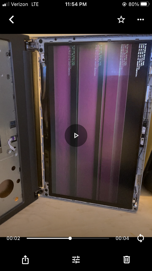

              Hey, so unfortunately this project didn't work out, there seems to either be a defect in the new cable or display. I'm rather irritated. So, now what, before I get pissed off, throw it across the room, and give up.

                  Alright, so the seller of the cable kindly sent me another, so I took the entire thing apart again, replaced the cable again, the new screen still has the same problem so I simply reinstalled the original one and am giving up on this project.
                  https://www.ebay.com/itm/273956897036
                  That was the panel I was attempting to install. The seller of the panel has agreed to give me a refund after I showed them the pictures, so I'm sending that back.
                  I've already purchased a completely different laptop, a Precision M6600 I got dirt cheap, once it arrives I will swap over my 16GB RAM and 500GB SSD, and sell this one, because I just can't stand 1366x768 but I don't want to put any more time and effort into this machine.
