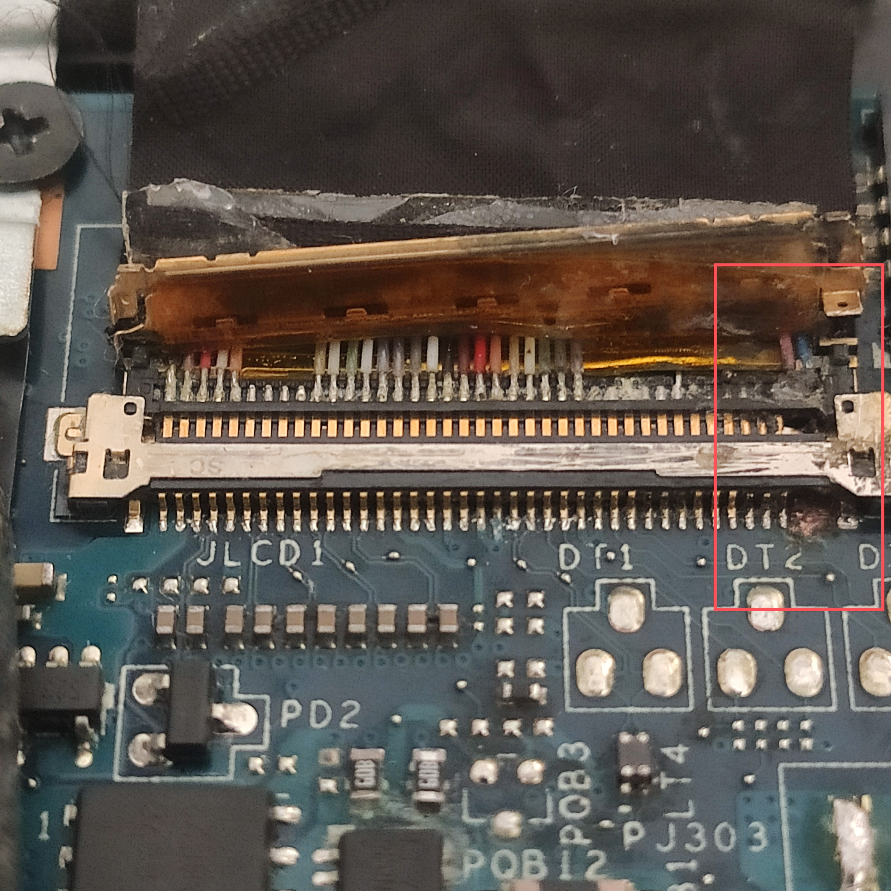

    hp envy 13 short on edp cable and 40 pin socket

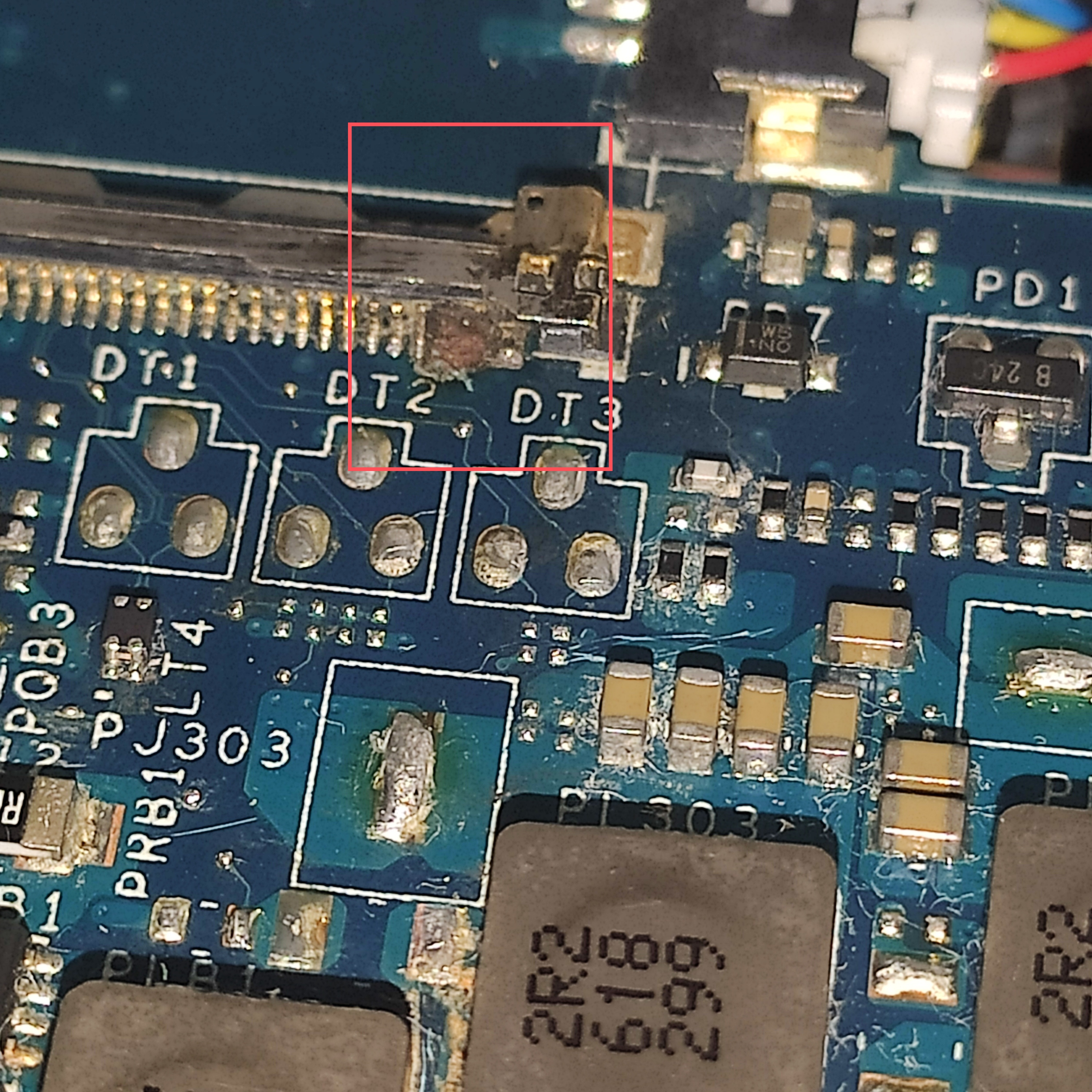

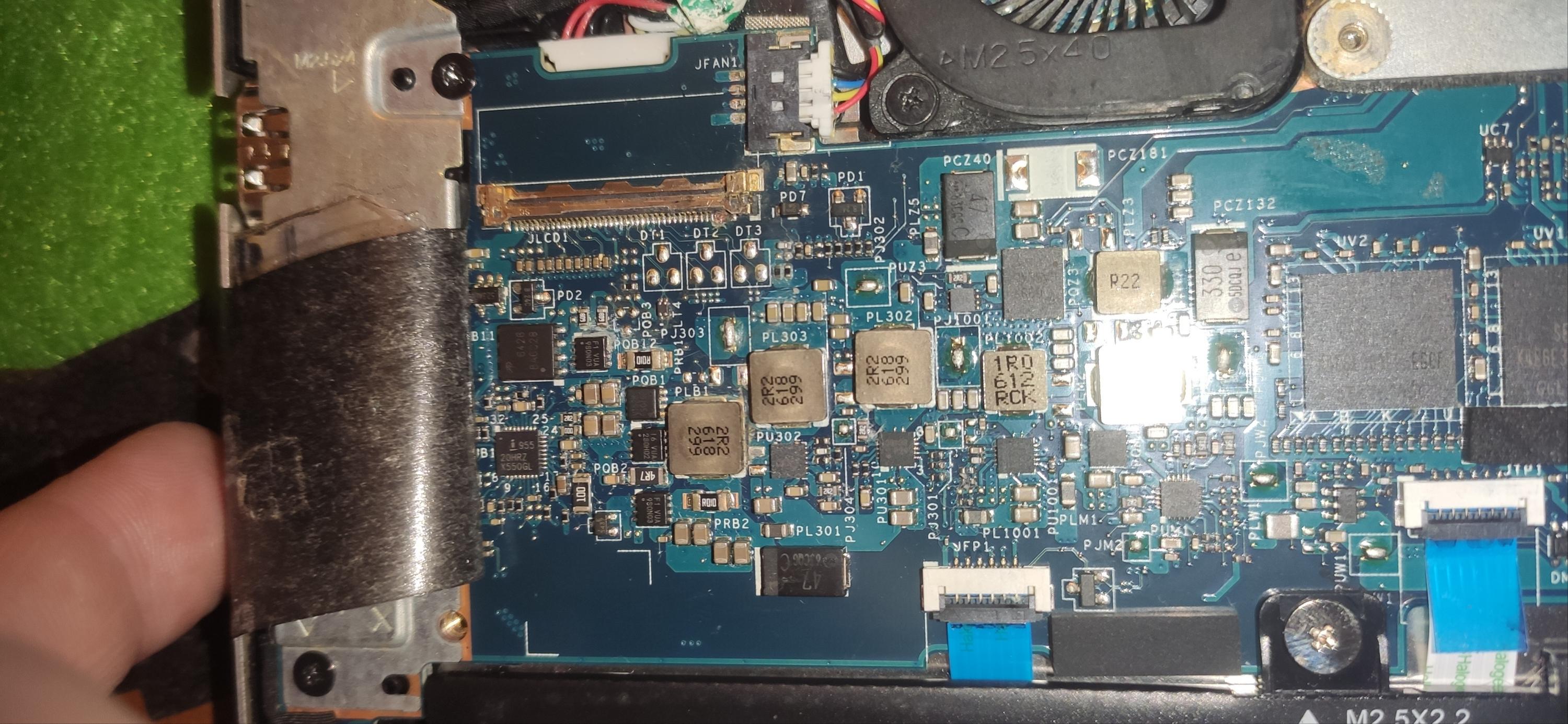

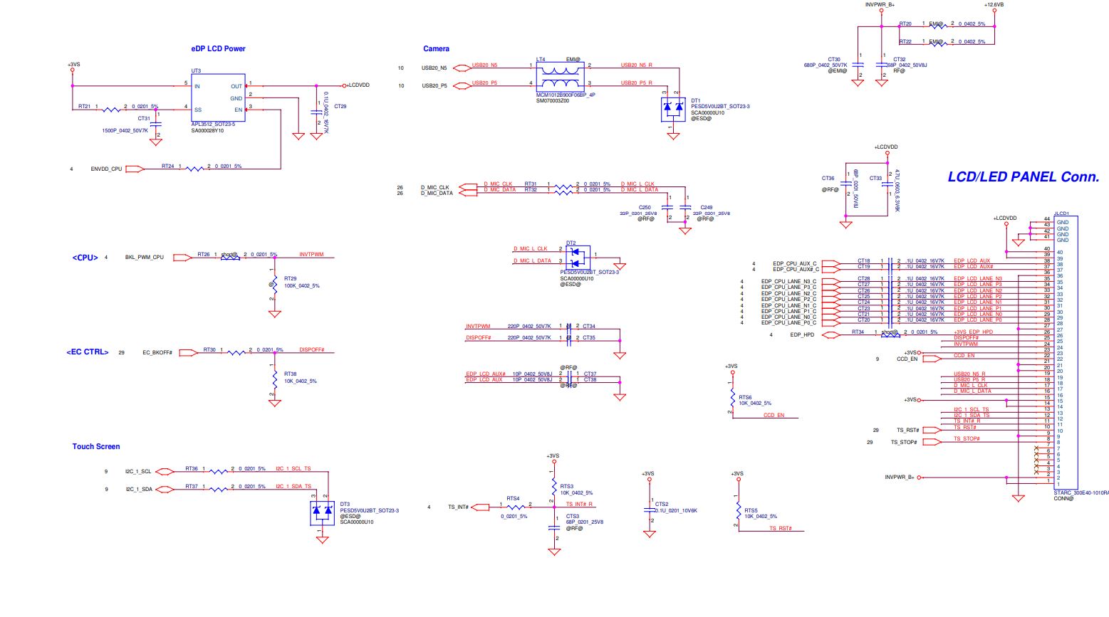

    Hi, I have a hp envy 13 and I upload the schematic and motherboard photos. There is a short on edp cable and 40 pin socket. Schematic shows there is invpwr_b+ where the short is (pin 1+2) but I test there is ground on motherboard, you can see copper on photos. How can I repair this short, where should I connect 40pin edp cables pin 1+2 on motherboard without change socket?

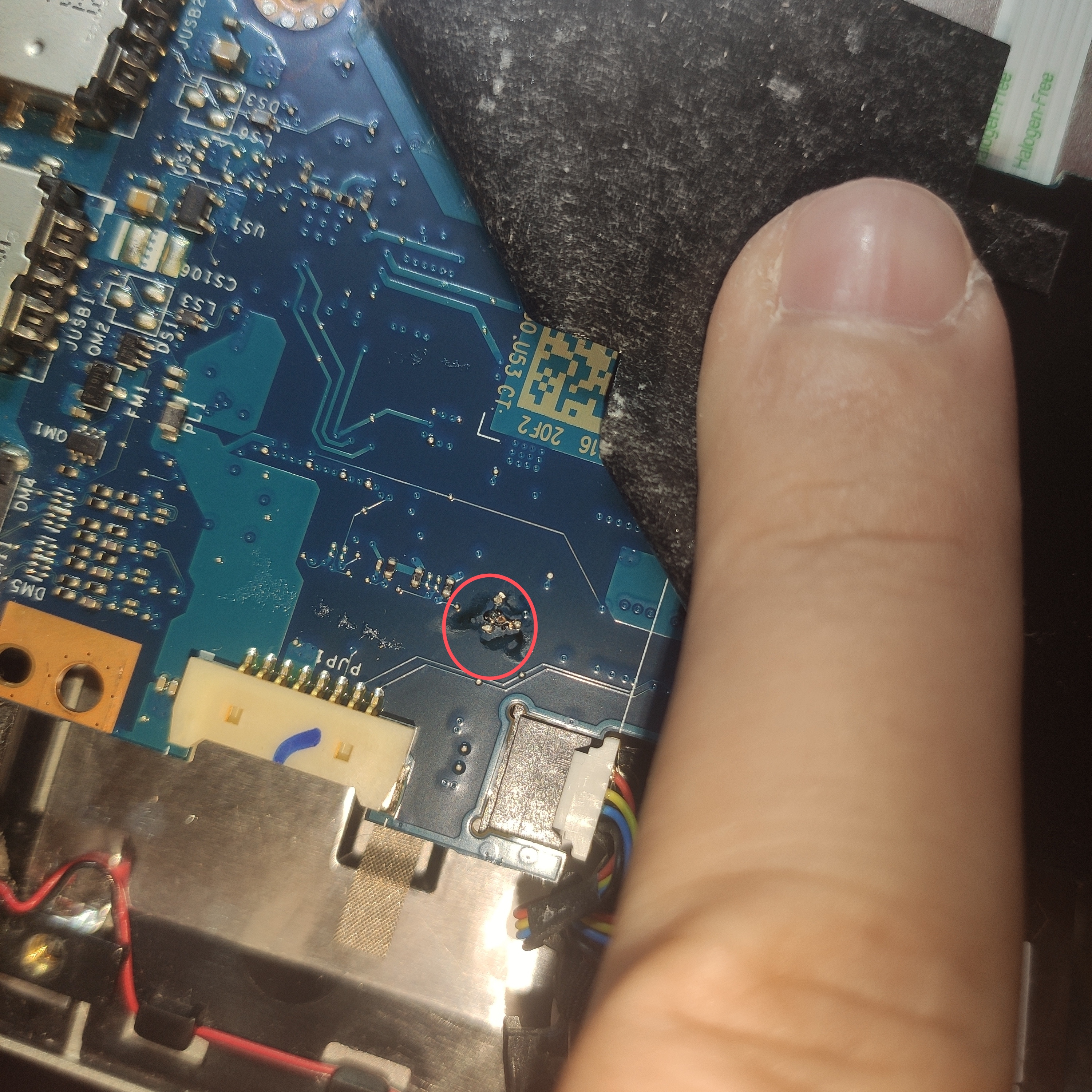

    HP Envy x360 13-bf0013dx (i7, 8gb) ipa32 la-m024p rev 1b short near PJ1802, type-c not switching to 19 volts
    by u666sa
    Laptop is HP Envy x360 13-bf0013dx, hp website link, it's an i7-1250U with 8 gig onboard ram.
    Platform: ipa32 la-m024p rev 1b
    Originally you'd plug power supply into it and it would take up to 1.2 amps and then drop to 200 milliamps and then go back up again to 1.2, staying all the while at 5 volts. Pressing power button would results in power LED blinking amber 3 times. 3.3 volt rail, 5.1 volt rail present, main power rail 8.8 volts. Power button test pads near EC chip 2.7 volts.

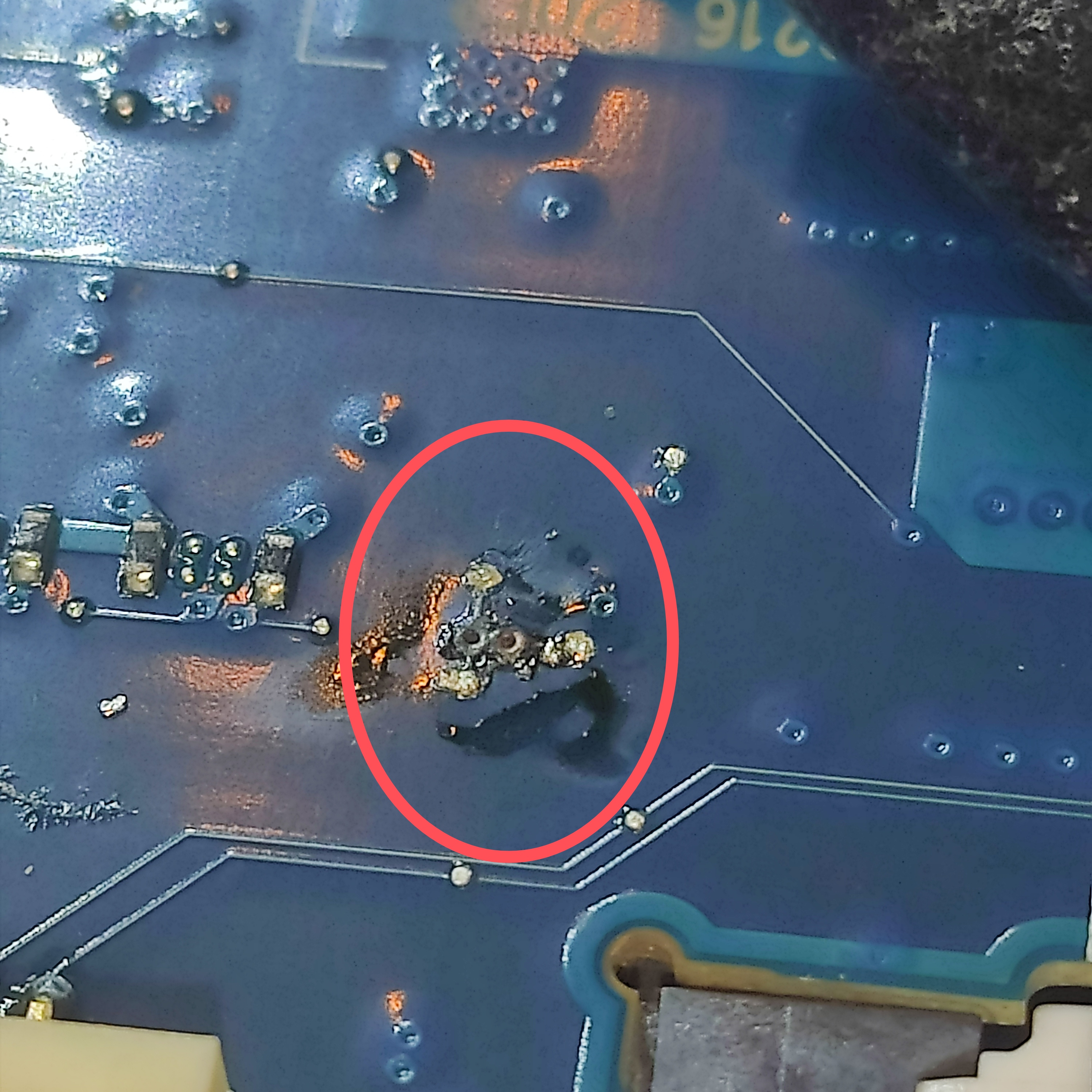

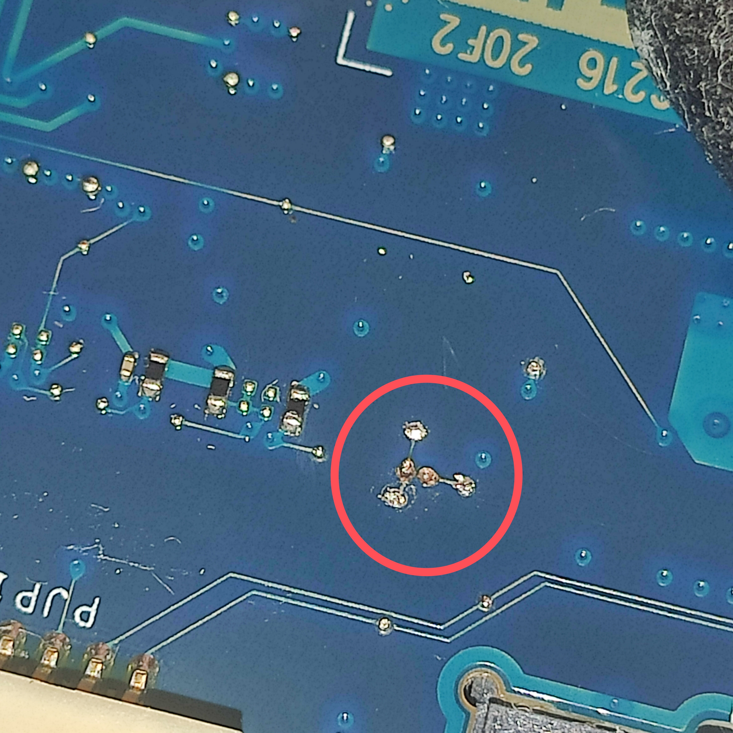

    I found a short on the other side:
