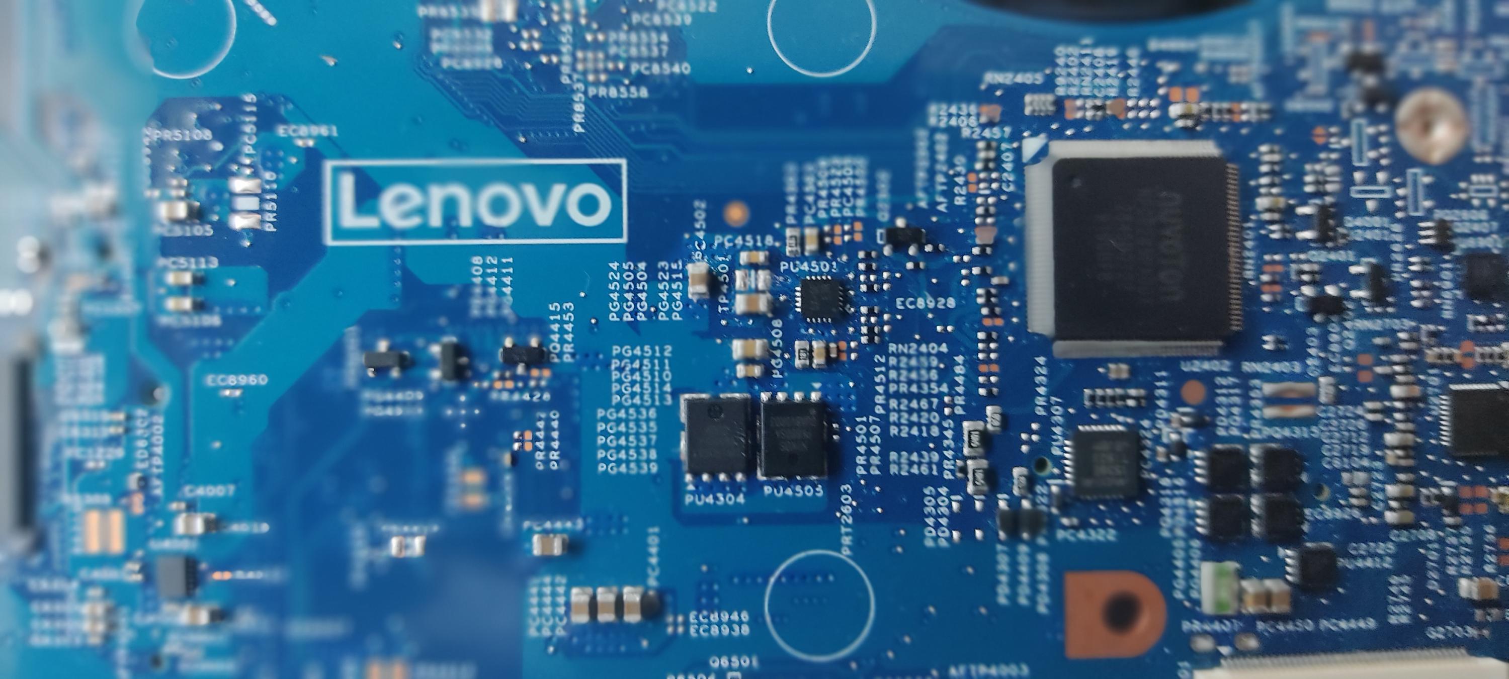

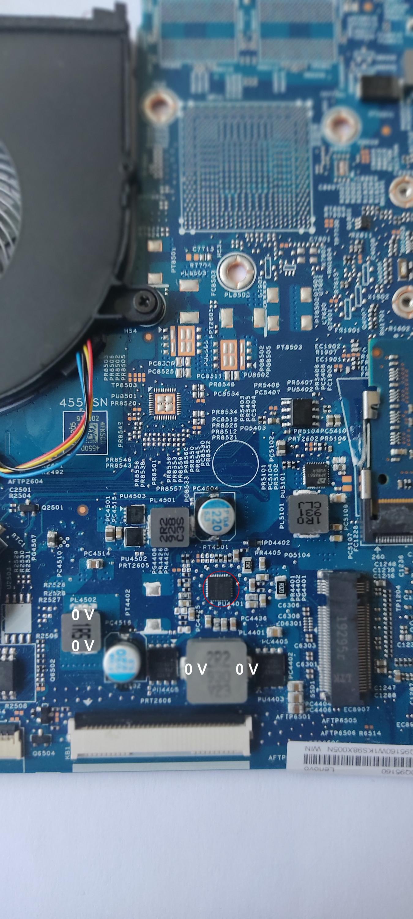

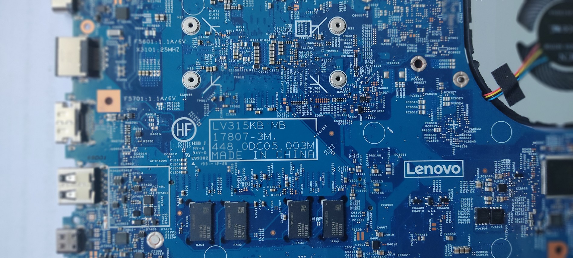

    I hope that someone could help me. I have a Lenovo LENOVO V130-15IKB laptop that won't turn on at all.
    LV315KB motherboard.
    No charging light, no power light.
    When I plug in the 19V adapter, I do have 19v in and out of the mosfets.
    On the other hand I do not have a 3v 5v voltage, I have a doubt about the ISL9538 chip which heats up enormously but this one does not normally manage the 3v 5v voltage? since it is a regulator for the battery
    Any help will be much appreciated
    Photo of the motherboard
