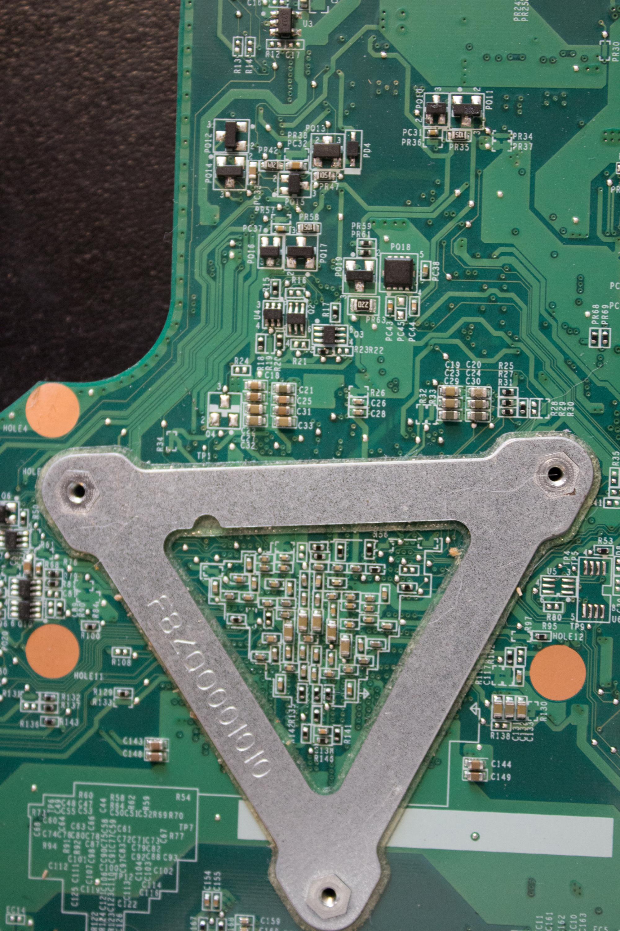

    Hello!, Anyone could please help me fix the issue of Acer E5-411
    I have an issue with an Acer E5-411.
    It´s not powering. I have 3v on power switch, but the power is not going to the RAM slot. Voltage on Bios is OK.
    I traced a little and I found that if I inject 1v on PR63 the consumption goes off the roof and it cuts the power supply. And Nothing gets hot...
    I'm really new to this, and I appreciatte any ideas.
    Have a nice day!

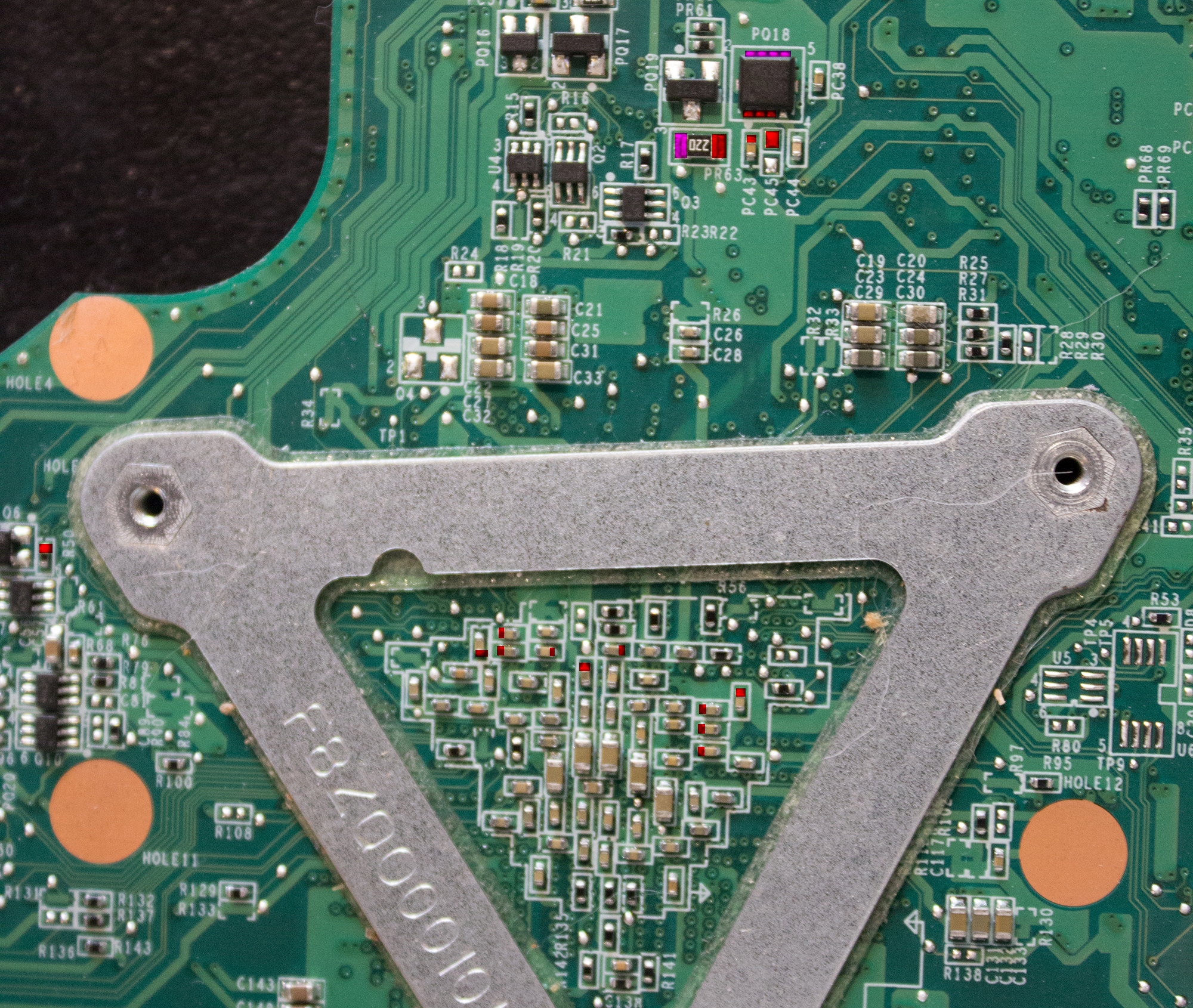

    This is PR63, and everything on 1v does the same.
    Maybe the Processor is the issue?

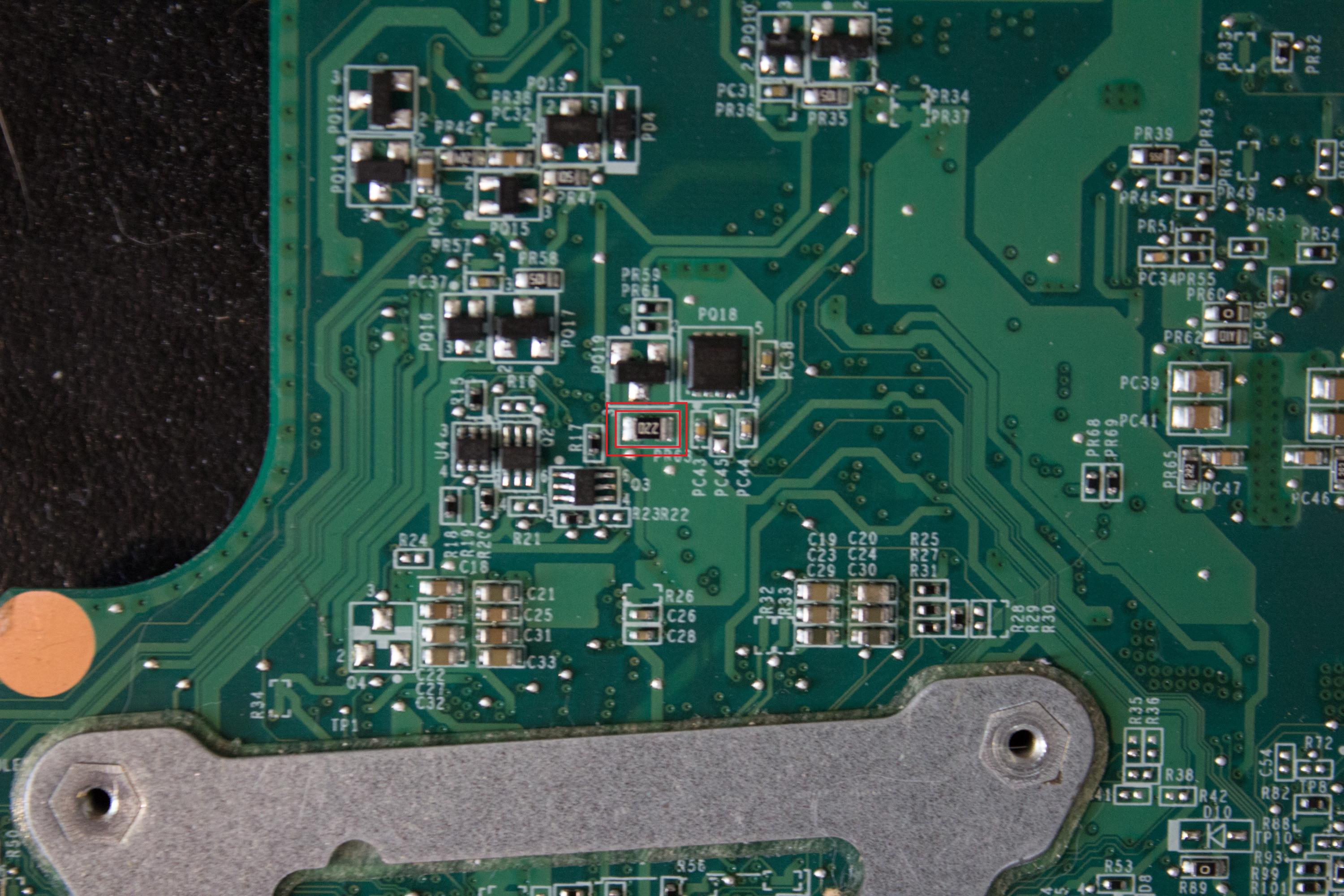

      Re: ACER E5-411 Power Issue
      If inject 1V on the Magenta marked side, eveything is OK
      But if I inject 1V on the Red marked ones the consumption goes up

        Why you are playing with voltage injection without proper diagnosis?? You may simply kill the soc. Since you dont have voltage on ram, why not probe the ram ic first. Just do basic things to start with.
        01.Check resistance on all big grey coils
        02.Check resistance on bios pin8
        03.Check ram ic pins for voltage.
