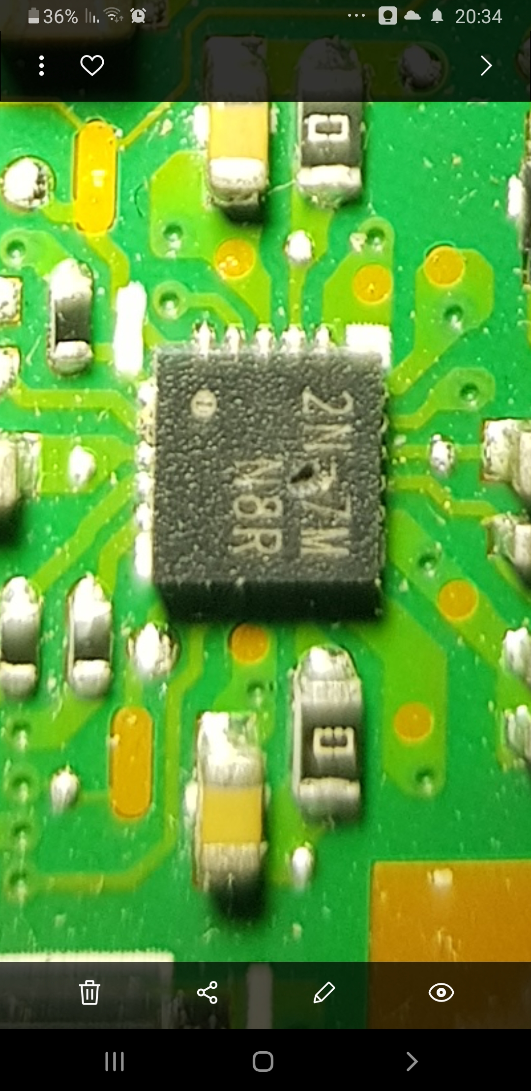

    Asus p3540f
    this chip is blown
    can you help identify it ?

    Re: Asus p3540f
    Richtek p/n RT8249CGQW
    Secret is to search for '2N=' prefix = Richtek part.

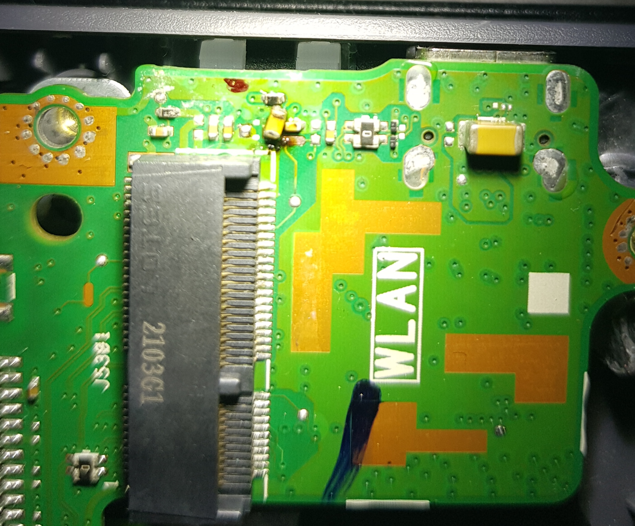

        On this laptop i also had a shorted cap, how can i know what cap value to install without schema ?

          Re: Asus p3540f
          Share any markings on the cap or better if you can post a clear pic of the topside of the cap.

            Re: Asus p3540f
            here is a pic, the shorted cap soldered side way, only to keep it as example
