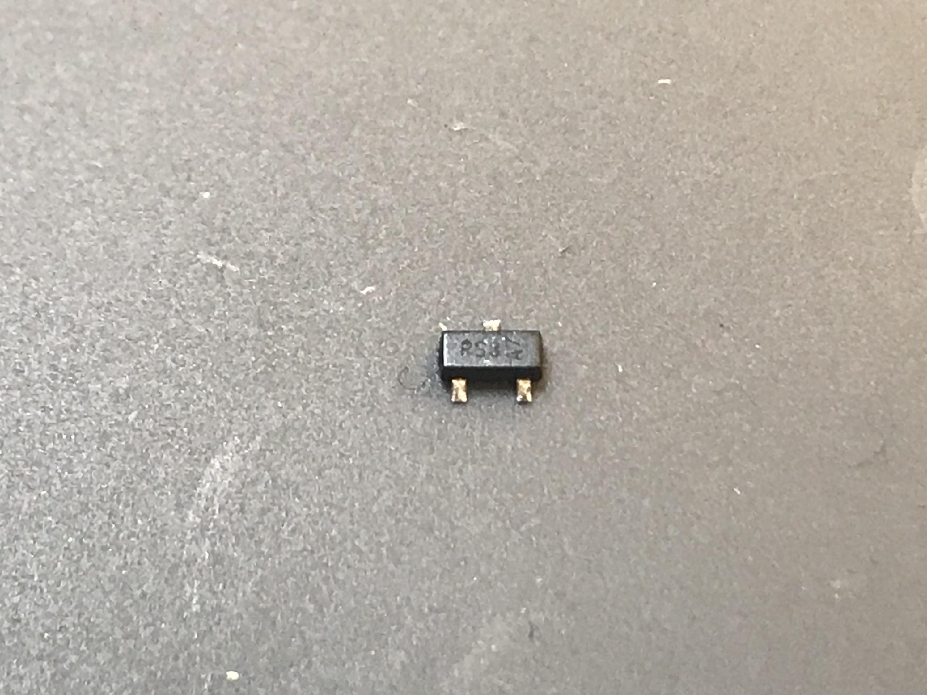

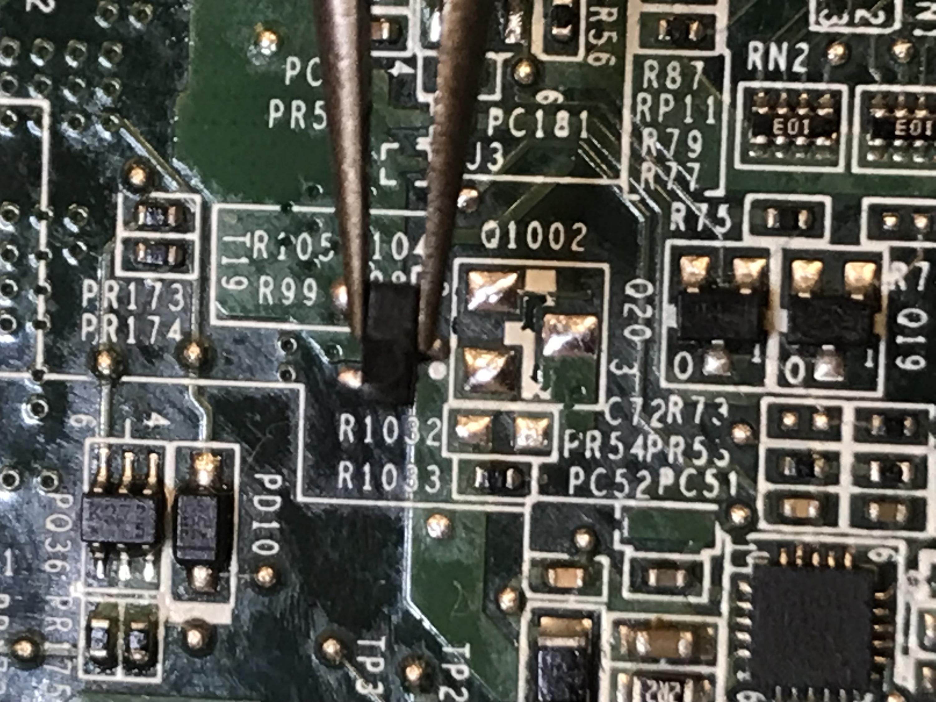

    Hello!
    Maybe someone can help me to determinate one dead component of this motherboard.
    So motherboard was charging, but didn't turn on, after exanimate motherboard found out that Q1002 burned out. On same mb found similar one Q1001 and was able to read it PS3 A7, but I cannot find anything about it and order replacement.
    Anyone can help to determinate it?
    Schematics for DA0D13MBCD1 doesn't help, because there isn't such component or at least I can't find one.
    Thank You.

    Re: Dell XPS L322x dad13bmbcc1 rev c dead
    It may be the attached but will check again once at the office.
