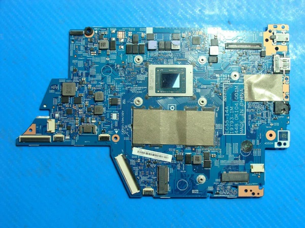

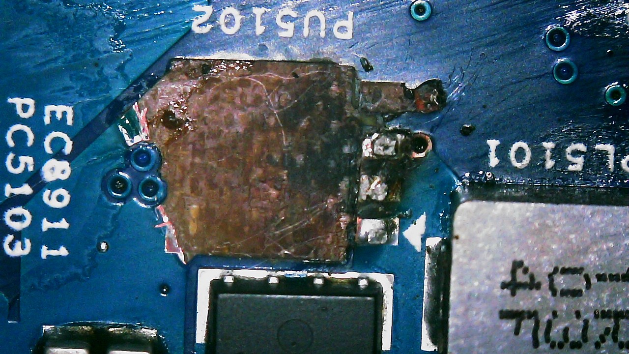

    Hi guys, grateful if anyone can help with identifying part number of the following MOSFET.
    Laptop: Lenovo Ideapad 5 Flex 5-14ARE05
    Motherboard: LC55-14A 448.OK104.0031
    Location on board: PU5102

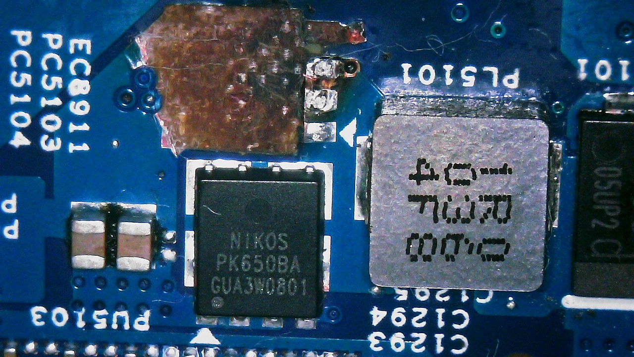

    The MOSFET next to it is the PK650BA
    I want to be totally sure of the one that was previously installed there, if someone has the same board and can confirm which component was located there, I would greatly appreciate it.
    I can't seem to find schematic for this motherboard.
    From now, thank you for you help

      Re: Lenovo Ideapad 5 LC55-14A MOSFET identification
      The Charger IC on this board is the BQ25710, but that IC is far from these MOSFETs, that missing component is on a par with the RAM memories

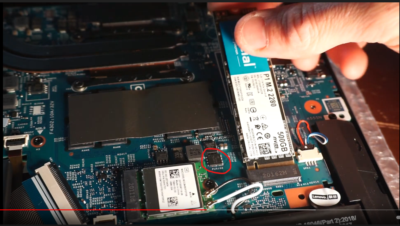

          Nope, is not that Motherboard, mine is this, and the component is at the top right of the WLAN

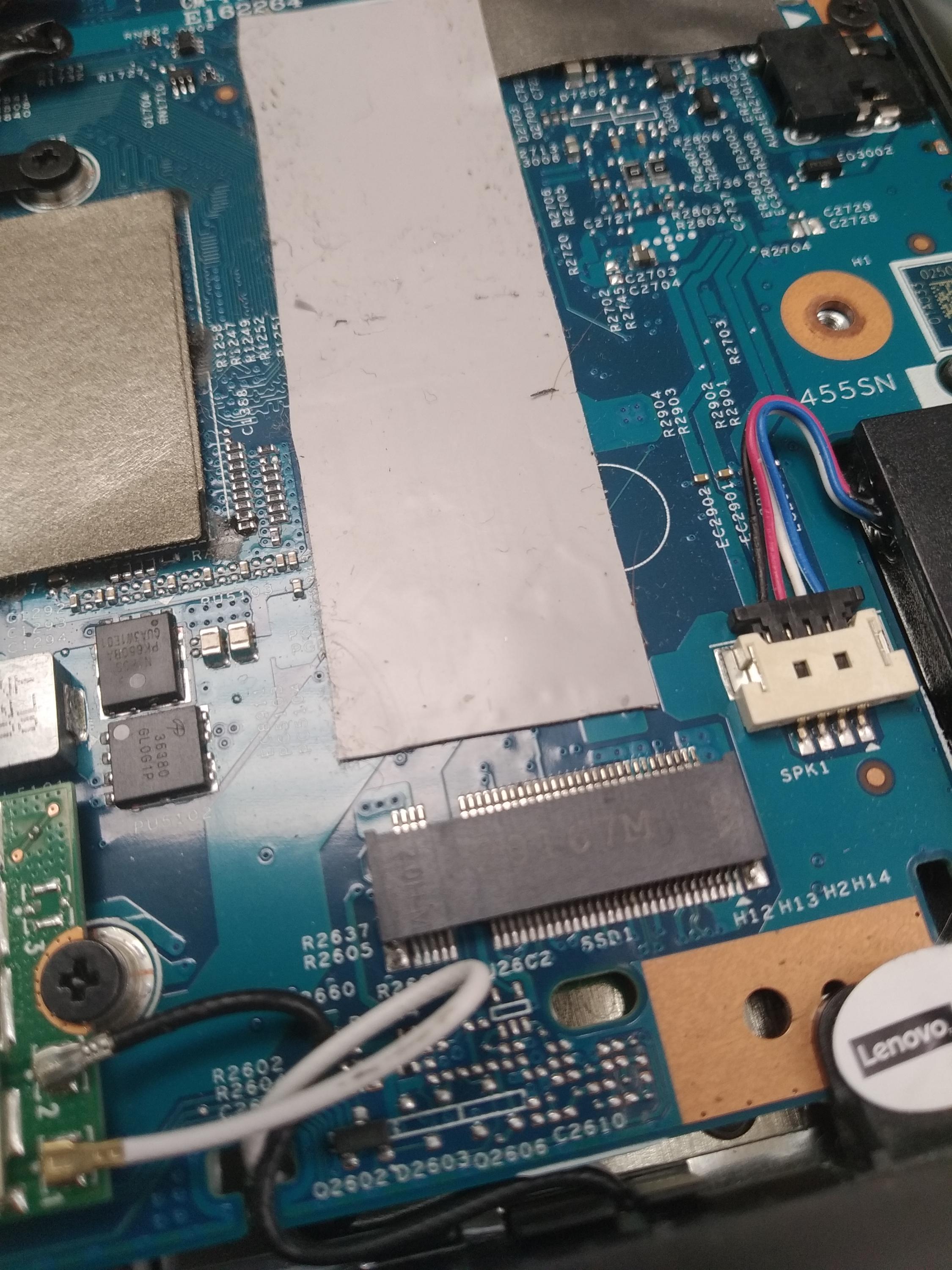

            Hi
            I have the same motherboard ,markings can be seen in the uploaded picture.
              US $12.90 11%OFF | 5pcs AONS36380 AON36380 AO36380 36380 QFN-8
              https://a.aliexpress.com/_mMdt538
              US $2.22 11%OFF | 5pcs PK650BA PK650 MOSFET QFN-8
              https://a.aliexpress.com/_mNYk96S
              To the OP, I would replace both of these mosfets.
