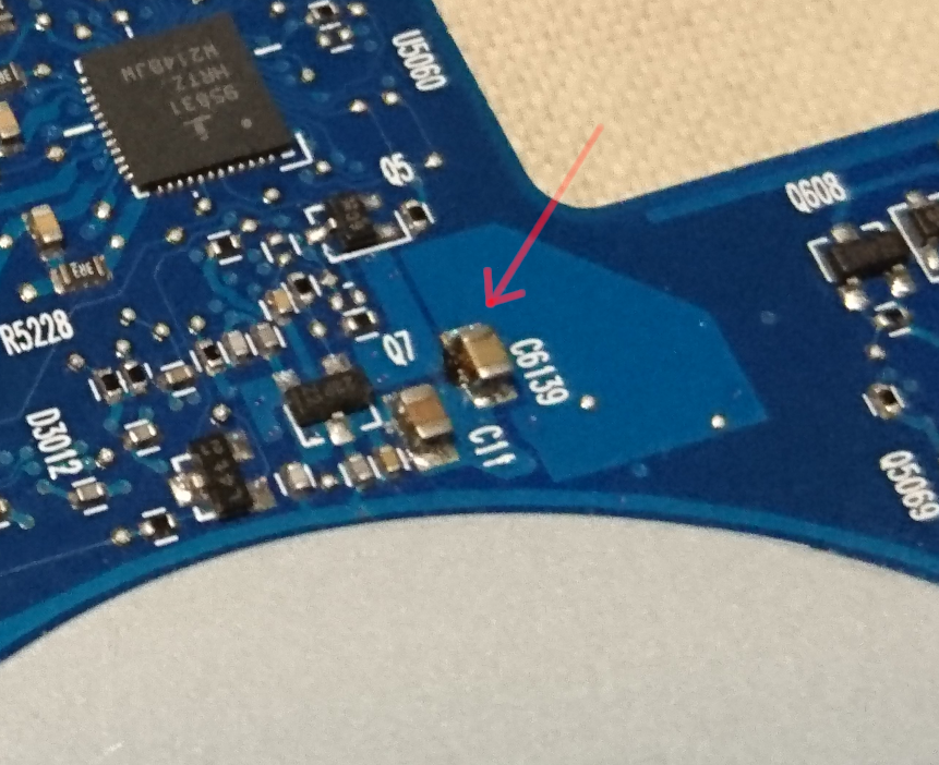

    Hello experts,
    I've found a short circuit in a EliteBook motherboard, in a SMD capacitor labeled C6139 (burn marks are visible in the image attached).
    In order to replace the capacitor, it woluld be nice to know its nominal capacity.
    Thank you.

    Re: HP EliteBook 8460p - SMD C6139 capacitor specs
    Hi, according to the schematic it's a 4.7uF 25V capacitor.
      Thank you JaroTech!!
