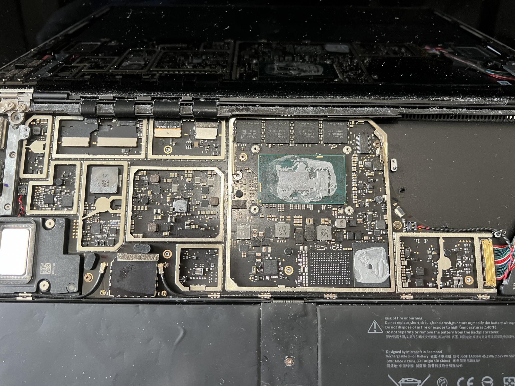

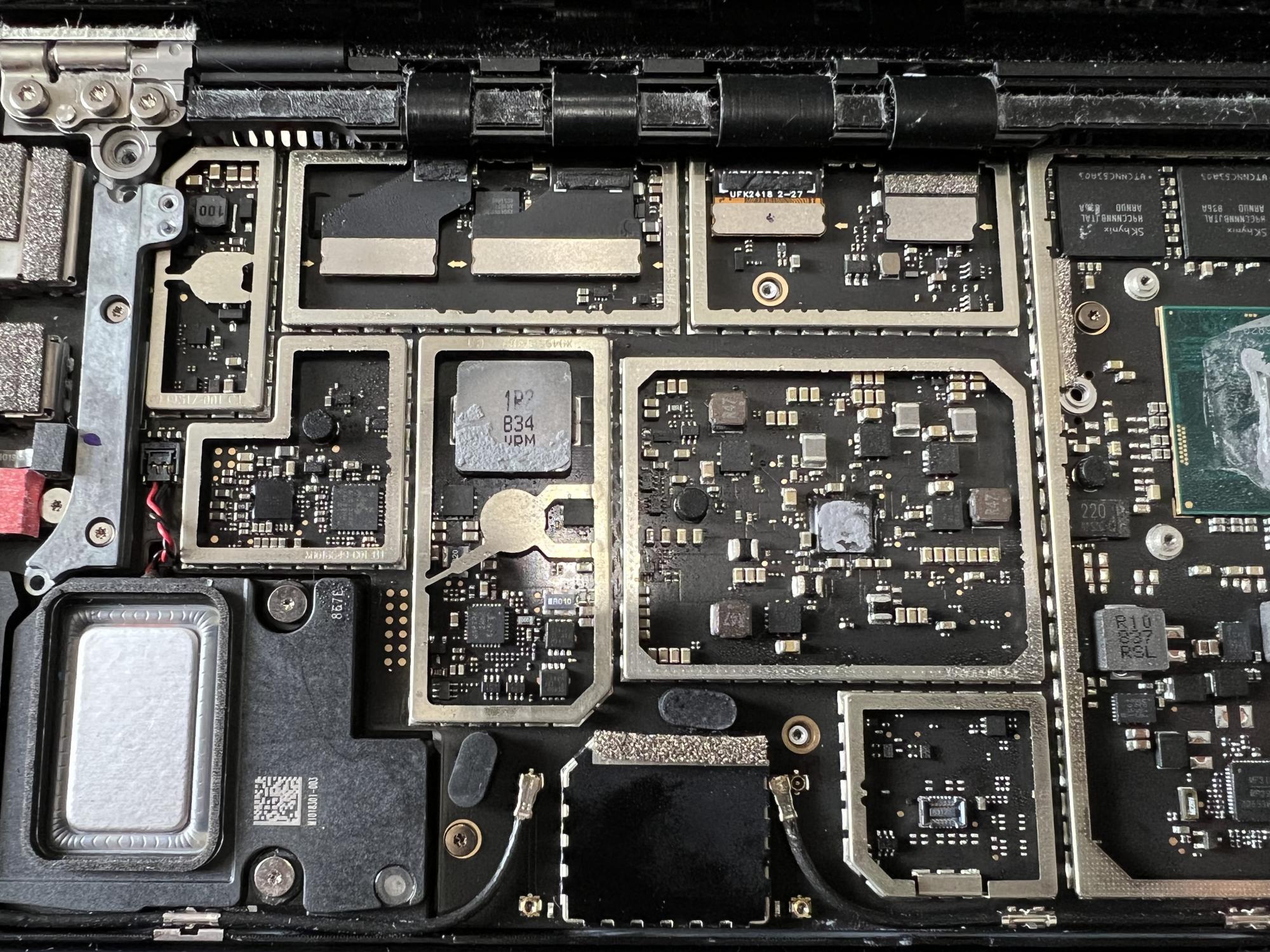

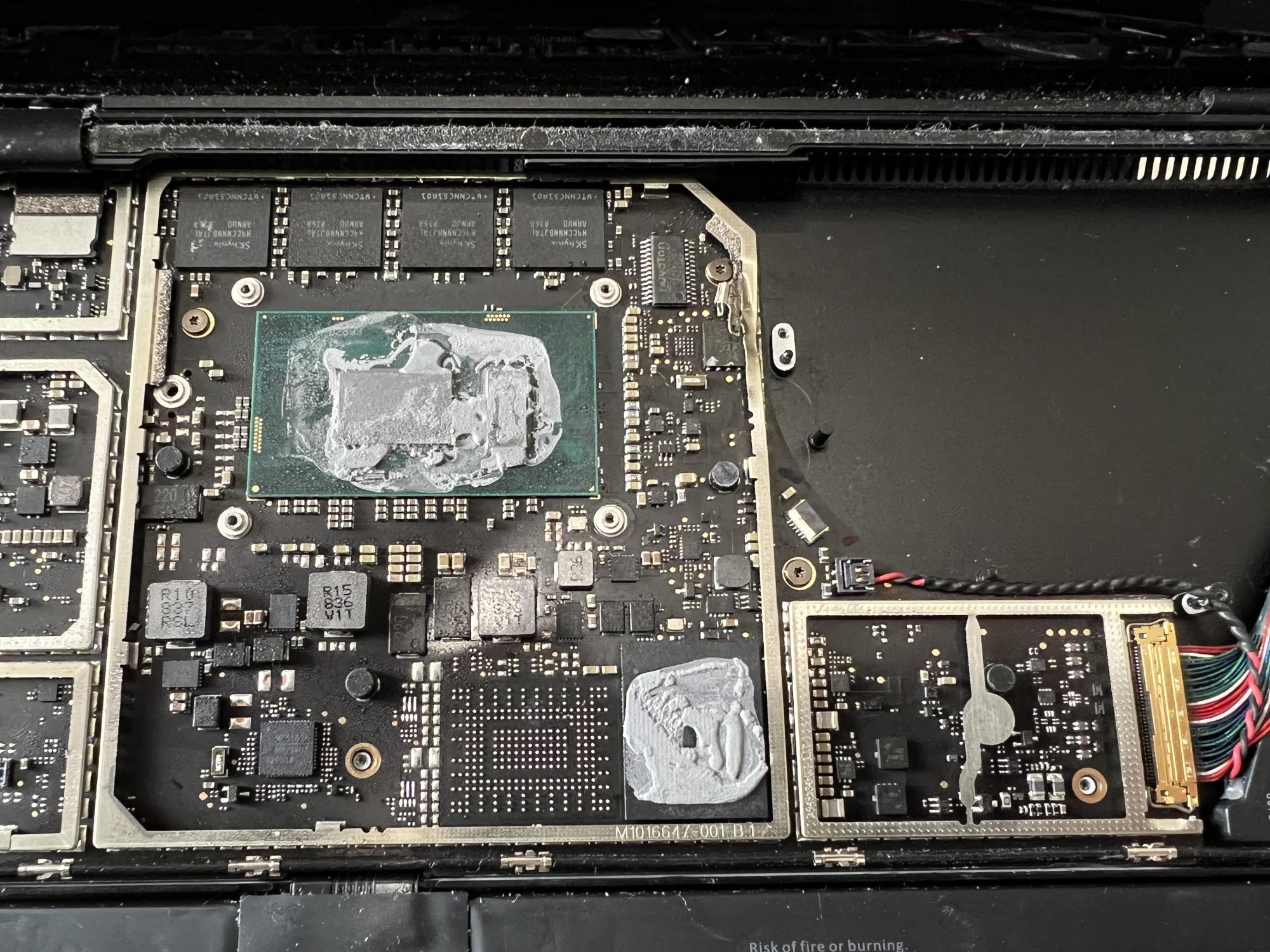

    Hi everyone have this 1769 doesn't power on. When power button pressed following happens:
    - Backlight no display for 5 seconds
    - Quick black screen
    Repeats about 4-5 times
    No water damage or anything visibly burnt/broken
    Primarily need data off it but noticed it's a soldered on flash memory.
    Any help in getting this to boot would be appreciated.
    Also I am familiar with microsoldering / hot air work if last resort need to swap the logic board, would I just need to move over the flash memory or is it encrypted/tied in with cpu or any other components?

        Hi. I saw this post, and although it's been a while, I'd like to tell you that I had a similar device, and it was a shorted CPU. The power supply, V3P3_VCCDSW, is connected via L26009, C26042, and C26043 to CPU pads 109, 110, and 191 (N39882242). I had to replace the CPU.
