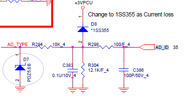

    Signal AD_ID = 0,66V when connected to motherboard or 18,2V when disconnected. Is it normal ?
    I check R294, R298 ans R304 and values are good. No shortcut for C383 and C386.

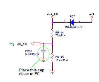

    +VA = 19,5V
    +VAD= 19,5V
    +VA_AIR = 19V
    I have checked PR144, PR143 and PC66 and they are good. I don't understand why AD_AIR is too low.
    It should not be 19 * PR143 / (PR143+PR144) = 2,7V ?
