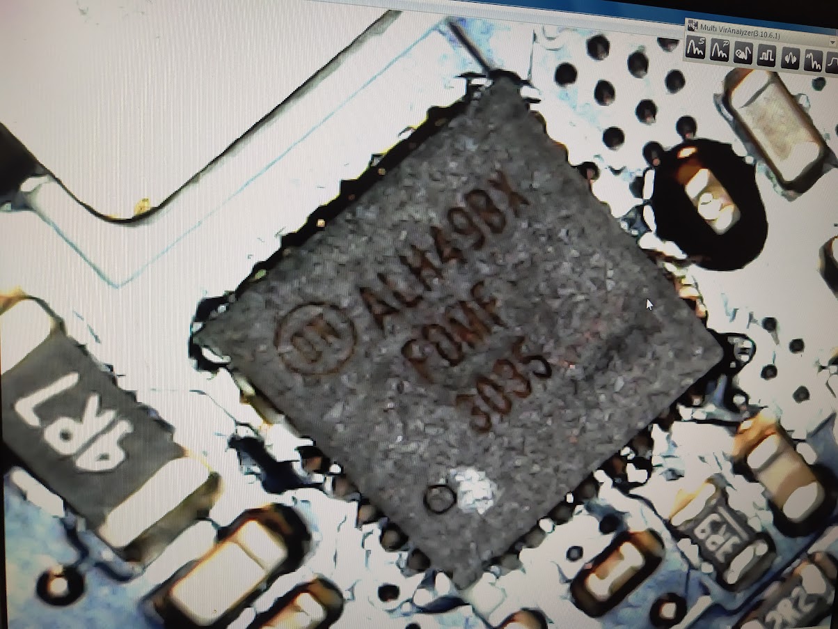

    Hello.
    Have this Dell Latitude 5590 which have one of his CPU rails ic burned.
    I cannot find what it is so i need help to identify it to order some

    Could be an onsemi / Fairchild FDMF3035

      Re: Dell Latitude 5590 help identify nextgen mosfet
      thanks mate. off course it is. i was completely fooled by looking at top mark.
