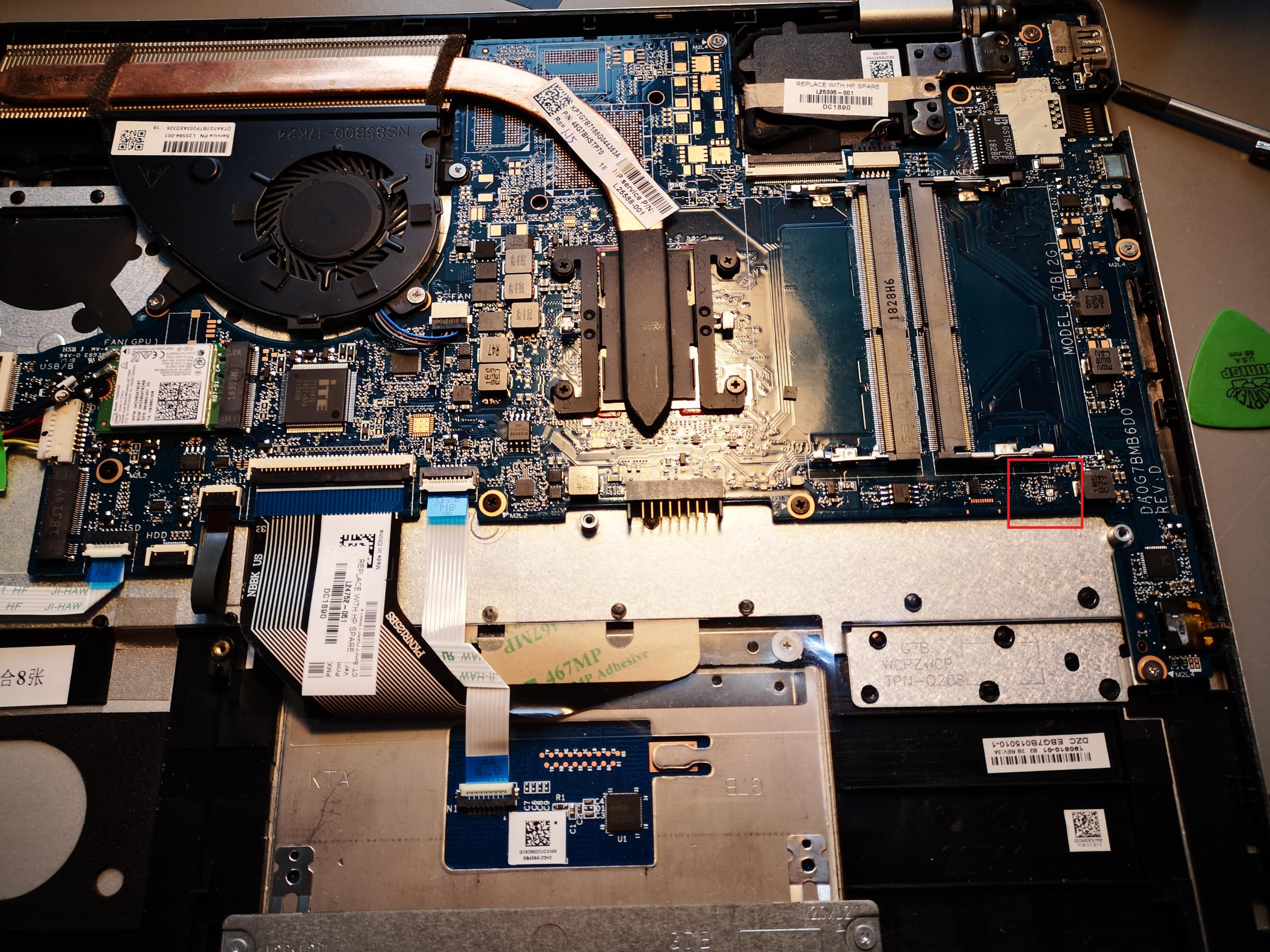

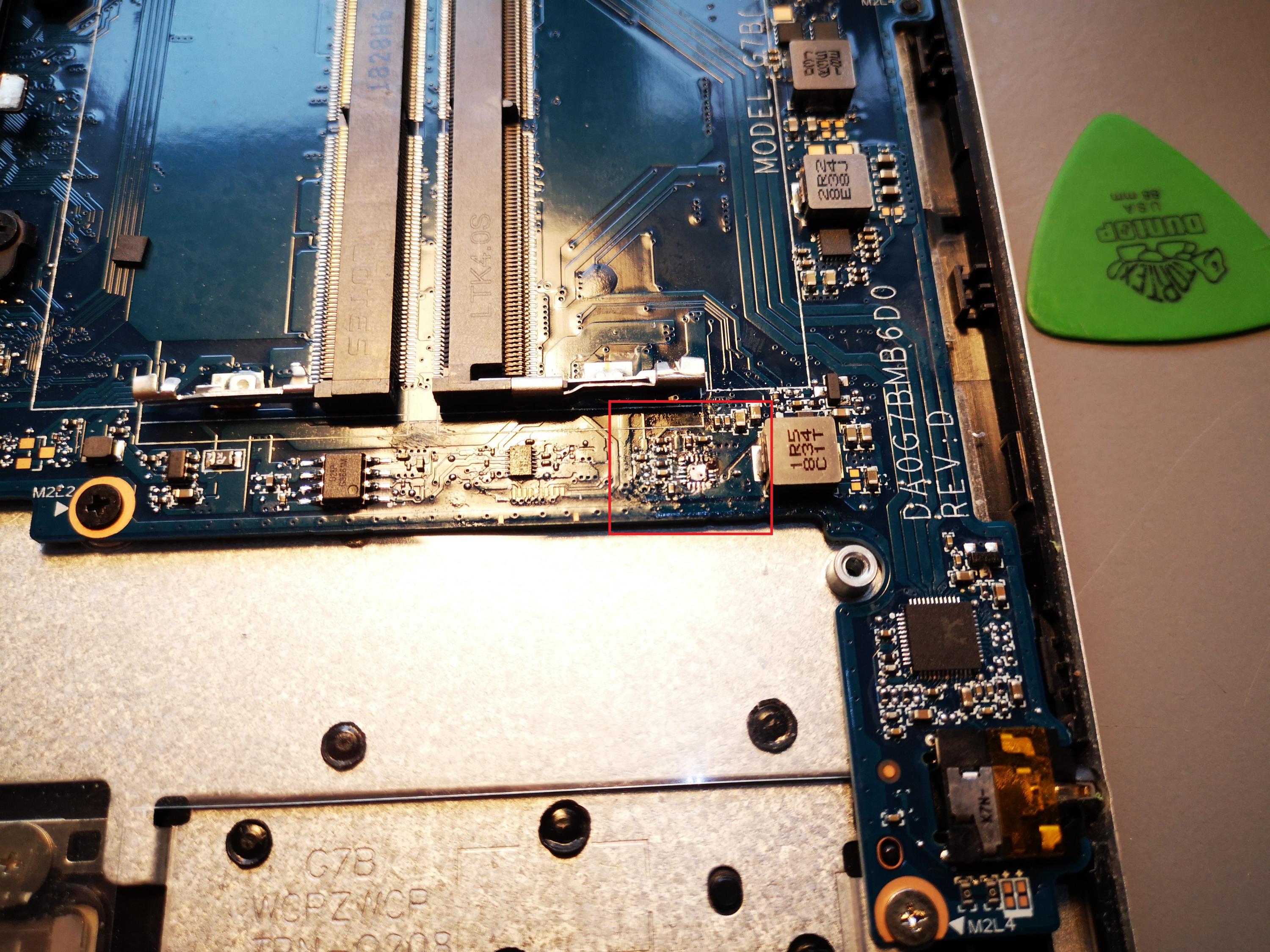

    Chip reference DA0G7BMB6D0 rév D HP Pavilion - 15-cs0006nf
    I would like to know the reference of a QFN-20 because the reference marked on the chip does not give anything...
    PC Reference : HP Pavilion - 15-cs0006nf
    Motherboard : DA0G7BMB6D0 rev D
    Reference marked on the chip: AWVAIL
    Type : QFN-20
    I didn't find a boardview or repair schematics
    Thanks in advance

    Re: Chip reference DA0G7BMB6D0 rév D HP Pavilion - 15-cs0006nf
    Its a Silergy SY8286BRAC
    https://www.badcaps.net/forum/showpo...1&postcount=12
      Thank you very much SMDFlea and thanks for the link it can be used for a next time!
