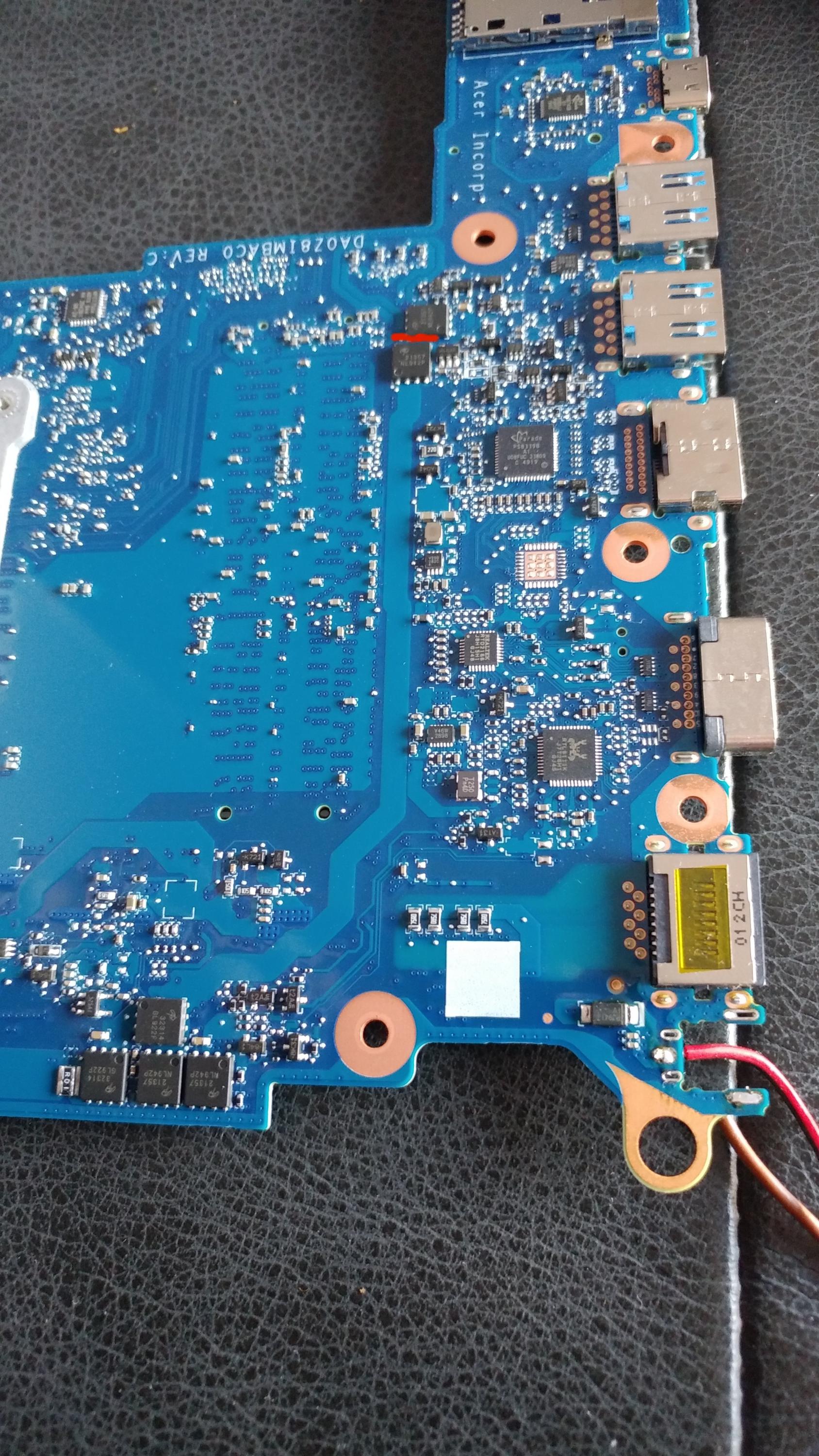

    I have this laptop (Acer Travelmate P215-52 model N19Q8 ) here, and the owner explained to me story.
    Somebody walked by at the table and tripped the power cable, the laptop did not fall down the floor (it was pickup before the landing on the floor).
    The power connector on the charger does have damage.
    The laptop did still work on the battery, the owner did try to attach a other original Acer charger (has more of these model Acer laptops) but the laptop did not work with this charger (did not charge the battery).
    Now the battery is empty, and the laptop doesn't work anymore.
    I have removed the board and placed a lab power supply to the VCC and GND (did removed the power connector from the board (in case of internal damage)), the laptop doesn't (no battery connected) want to power up.
    I have done some measurements, I only have 19V on the 3 first (most right) bottom mosfets, the most left mosfet of those 4 there is no 19V in pressent. The mosfet (under the red line > AONR21357) has no 19V on the draine, only on the Source and no power on the Gate
    Since a few days, I have a thermal camera and I have noticed that the 5 legs GAF chip is generating heat when I connect the power supply.
    I have marked this part, it's the part under the red line.
    I did not find a schematic for this board and can therefor not find out what this GAF part does.
    Any ideas how to proceed...

    Re: Acer Travelmate P215-52 doesn't turn on
    That 5 Leg IC is for usb power. You can safely de-solder it from mb. Check resistance on 5V coil before and after removing this IC and post it here. It seems you have +5V line shorted and there may be damage on other parts. The mb can be safely powered without this IC.
      Thanks for your answer.
      I wanted to make some voltage measurements , and I made a short between the VIN en GND pin
      According to Google search, GAF could be a voltage regulator.
      After removal of the IC, the voltages are still not there on VIN. Yesterday I did measure voltages there.
      I did not find any schematics and perhaps boardview files, so no idea what could be damaged with this short I created.

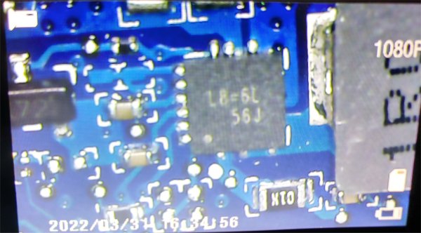

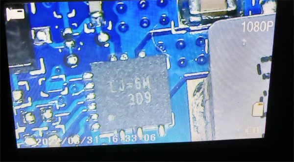

              I have searched all the IC with Google and did not find any PWM controllers where the schematics mentioned something that the chip is responsible for the 3v and / or 5v.
              I did not find any information regarding "LJ=6M 3D9" and "L8=6L 56J" chips, any idea how I can find the reference / schematic for this chip?
                See attached.
                Anytime you find an '=' symbol, this is RICHTEK. The characters AFTER the '=' are datecodes.
                So search for 'LJ=' and results in RT6258CGQUF.
                'L8=' is RT6256BGQUF (Richtek.
                Datasheets are attached. Aliexpress should have these. Just be sure to source the part with the same markings (except for datecode).
                PS: Learned from School of @SMDFlea.
