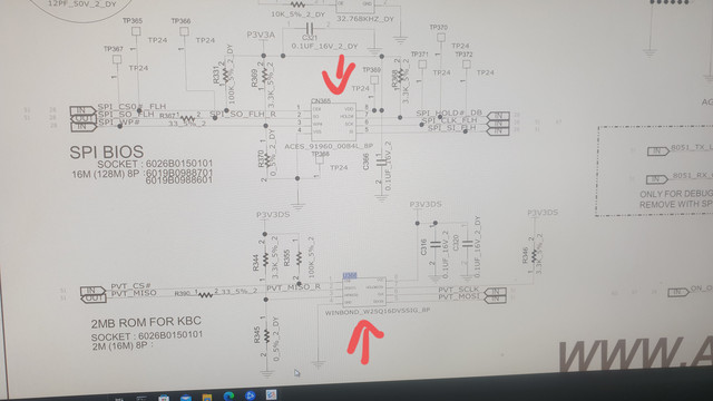

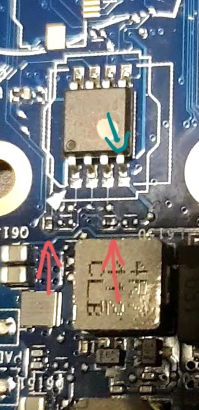

    To make the story short, i was busy repairing a motherboard with bad bios. I managed to reprogram both of the bioses and resolder them, but during the operation i lost 2 small smds by accident which are located just outside it. I managed to trace the line and it seems they are "affiliated" with the bios
    From the images bellow you can see the schematic part and motherboard picof the bios area
    The red arrows point to the 2 lost smds (i took the picture before i started the job)
    Also you can see a green arrow which i pointed towards the ground of bios chip
    Bios part number is CN365 it's the one where I lost the 2 smds
    I also looked at the schematic and located the ground of the bios pin so i can trace what SMD it is on the schematic. It seems the 2 smds i lost are connected with pin 2 and pin 3 of the bios
    I am still not really good at reading schematics and i am afraid i will make a bigger mistake.

    Whats the motherboard part number. Post the schematic,or a link to it if its posted on badcaps already

      Hi there. The motherboard is Elitebook 840 G1
      Schematic
      https://www.badcaps.net/forum/attach...6&d=1638945099
      I wasn't able to find a boardview file for this motherboard which might have made the job somewhat easier
