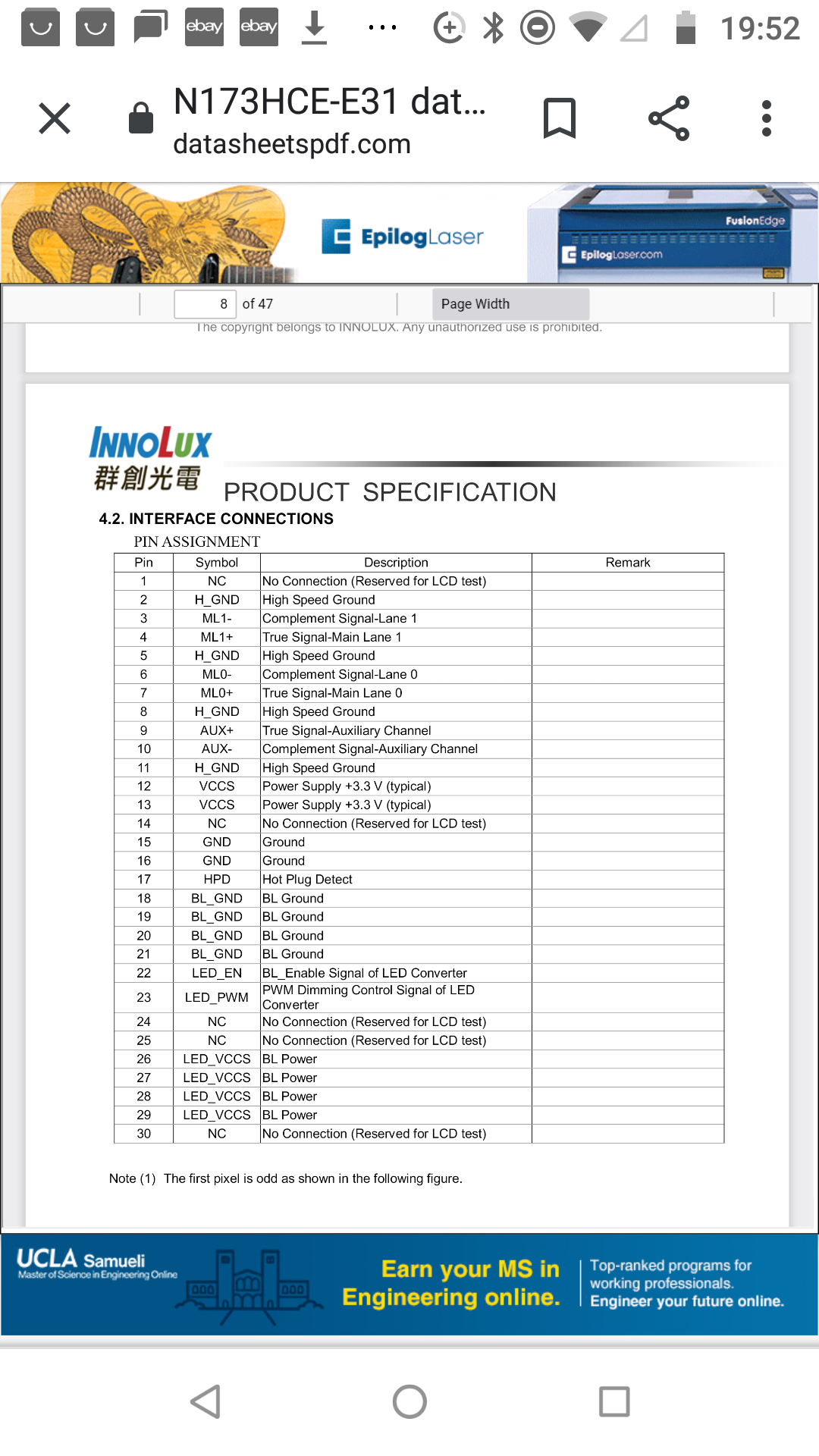

    • RepTech
      • Mar 2022
      • 9
      Re: Dell G7 7790 LCD backlight issue
      It is 30 PIN.
      I don’t see any markings on the LCD connector of the display. If you mean the model info it is as follows:
      N173HCE-E3A Rev. C1
      09C1BHY99B50001
      HP H/W:C1
      HP P/N:L43245-JG1
      CT:CHRTK01K6CR04Y
      This is off the replacement screen. Original is also N173HCE-E3A Rev. C1
      Both are InnoLux displays.
      Thank you!

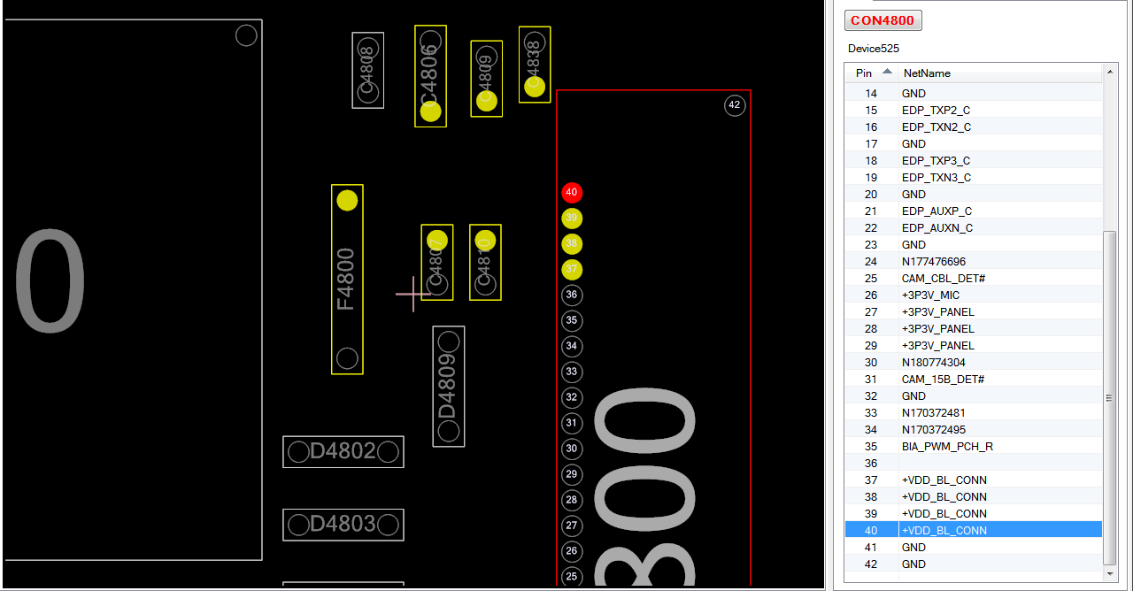

      • JaroTech
        • Mar 2015
        • 351
        Hi, on the motherboard, does the connector for the screen have 40 pins? If so, are pins 37 38 39 40 connected together?
        • mon2
          • Dec 2019
          • 14450
          Remove all power.
          Meter in resistance mode.
          Check if pins 26 to 29 are common = Backlight pins.
          If they are connected together, then this is very likely your backlight rail.
          Confirm this detail first. If yes, continue.
          Still with no power, check the resistance to ground of the backlight cluster of pins.
          What is the resistance?

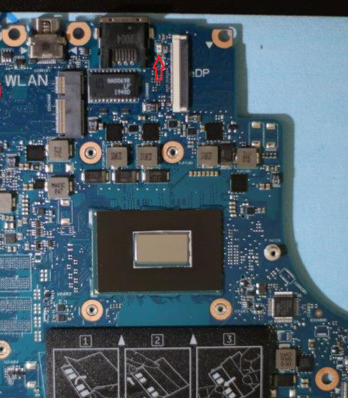

              • JaroTech
                • Mar 2015
                • 351
                I'm using a different schematic than your laptop model, maybe it's not the same as yours. Near pin 40 you have a fuse, if you have a voltage on one side then the fuse is burnt.

                      • RepTech
                        • Mar 2022
                        • 9
                        Your schematic seems to be better than the one I'm using. Everything in the one I'm using is exactly opposite of the board. It's accurate thus far as long as I remember its backwards.
                        The fuse is good.

                        • JaroTech
                          • Mar 2015
                          • 351
                          As I said, I don't have the schematics for your laptop, I'm using the Dell G5 5590 G7 7590 Pegatron Vulcan. And for the boardview, Dell G5 5590 Vulcan (cad). If I remember correctly the boardview was also opposite of the board, I just flipped it in BoardViewer.
